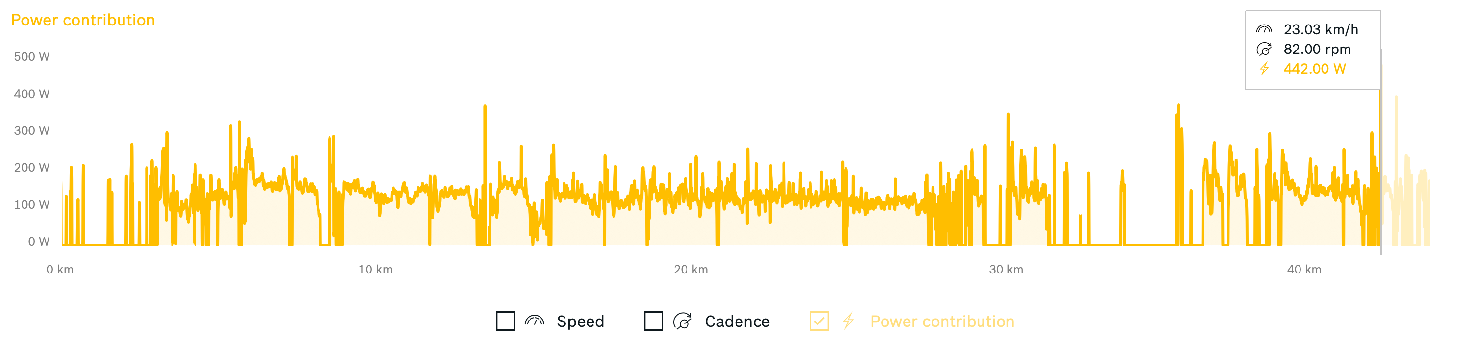

This explain a lot of things. I found a lot of peaks of power in the record of my Bosch CX motor well above 250 W. Thanks! I wasn't aware about that.
However, it is still not clear to me how the motor complain with the 250 W rule...

but did someone ever found a continuous power record above 250 W? Or just peaks (like in my previous screenshot, but I am not very fit...).
If this is not the case, it could just be a limitation of the motor management system that try to instantly respond to a sudden high demand of torque and overshoot for a second.
oh yes. The dyname motor actually shows the output power, and it actually does consume 750W almost continuously on the highest power setting:
