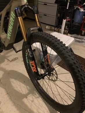

My 910-20-609 Fox Racing Shox 2019 Fox Factory 36 Float E-Bike+ 29" Fork Grip 2 Tapered arrives today! Looking forward to installing it tomorrow eve and giving it a ride.

Edit...and It's installed. Taking it out later today
I'm finding my RockShox Revelation is not plush enough on long descents.
I’ve got a similar setup up front on my Meta with a 36 Factory, Fit 4, 150mm, eBike specific fork. It’s burley beast and I’m loving it.
