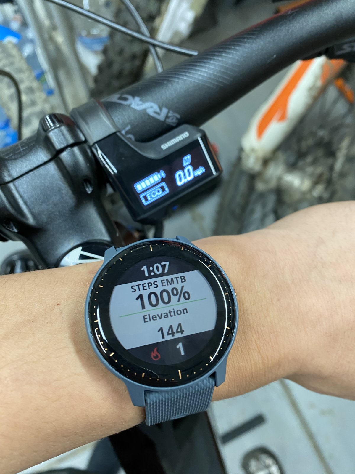

Mark’s app works with my new Vivoactive watch. Hated not being able to see exact battery percentage of my bike.

Is "Mark's app"available on the Garmin IQ Store?
Yes. There is a big thread on these forums about it. I think it’s under the shimano section, but can’t remember.
Just search “shimano” on the garmin App Store and it should pop up if your device is compatible. Not all garmin watches are for some reason.
Edit: Also the creator of the app uses these forums, so I’m sure he can help answer questions.
Edit edit: Here is the thread: Garmin watch data field for Shimano STEPS EMTBs - EMTB Forums
