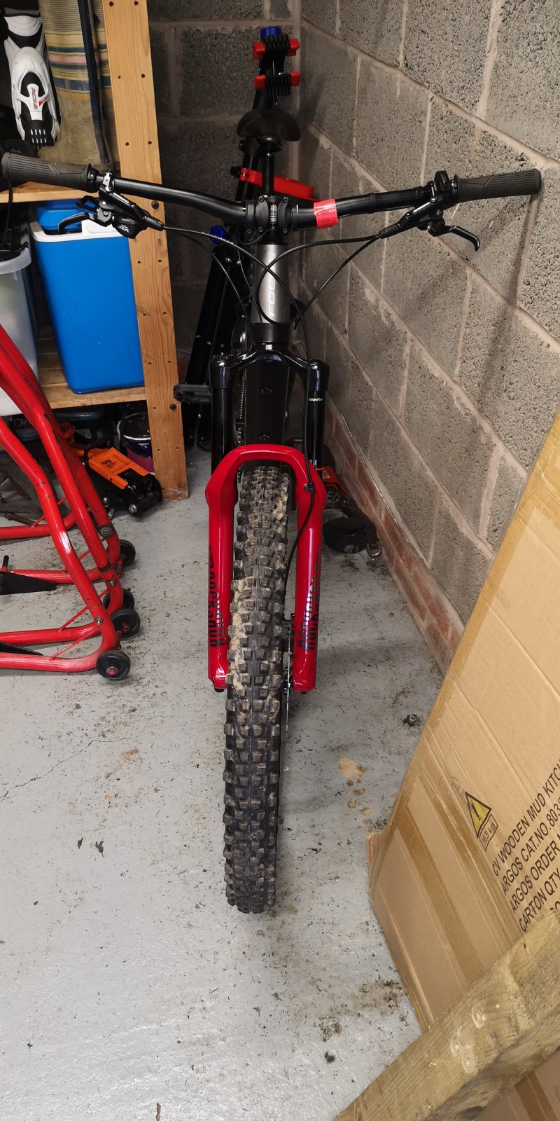

I just fitted a 29" 160mm Bomber Z1 and it doesnt appear to have made any noticeable difference to geometry. With used ones I guess steerer length is something to watch. Probs already been said above with the other good advice already given.

OK so.... For those asking lots of questions.... Jam2 2019.... I've just fitted 650b lyrik ultimates.. The boost size 650b lyrik take a tyre up to 81mm so with my 2.8 e wilds loads of room.. Ya do not need a 29 fork if rockshox... Only if fox.... So on subject of length.... A 170mm lyrik is 555mm axle to crown my 34s were 551mm so exen though 20mm extra travel only 4mm longer.. So minimal change to chassis... I,ve also fitted a works components 2 degree offset h/s which originally would drop my BB 3MM but with slight fork length change I see no issues.... Will try this week.. If feels bit top heavy I. Ll go to 160mm airshaft in fork.. But doubt that....

I've dun it... Only small issue.. My mudguards bit close..

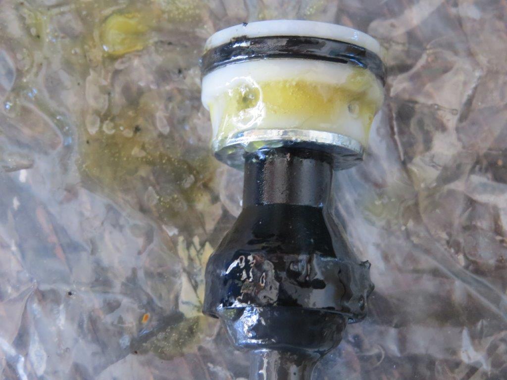

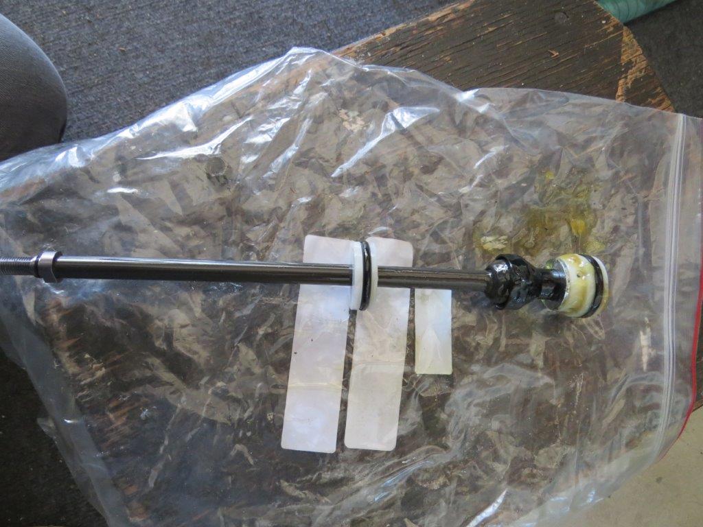

I made two mistakes when replacing my air shaft on my 2018 Focus Jam2 C with Fox Rhythm 34. I wanted to increase the travel to 150 mm and use a 29" wheel. As flexible as this fork is I decided to go back to 140 mm to try to minimize flex. I'm also unsure as to if this version is OK with 150 mm. I used it that way for months without any apparent issues.
The other mistake is to try to duplicate the huge amount of grease that the factory used on the end of the air shaft. That resulted in plugging all holes as shown in the picture. Months of riding like this did not unplug the holes so I've now cleaned it out and re-installed the stock 140 mm and I'm using one volume spacer. I weigh about 65 kg but still wish I had a higher end, stiffer front fork. No way to test any of this right now since all the trails are closed here in SoCal but someday soon I hope. Stay safe out there!
