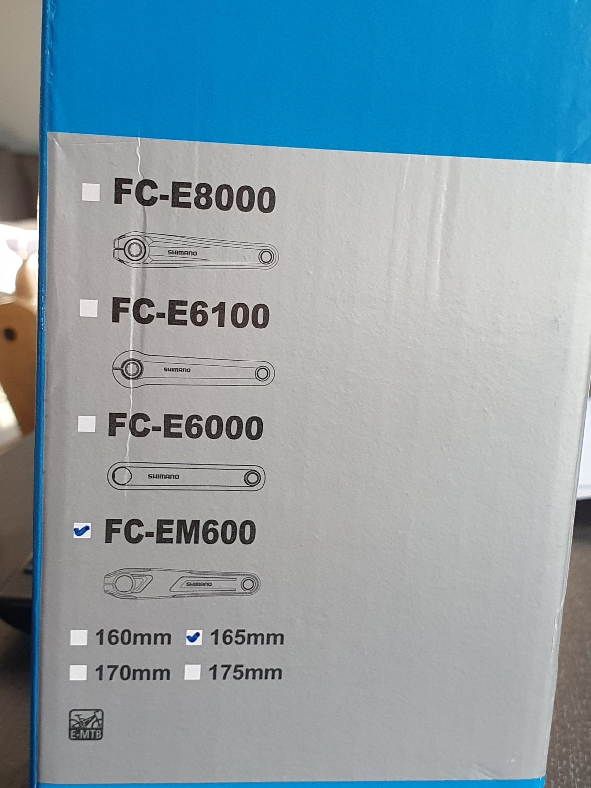

Sorry to butt in. I'm just checking Ive bought the right cranks as I've busted my thumb up pretty bad and won't be using the bike for a couple of months. I have a standard M20 size small.20220403_090359.jpg
Sorry to butt in. I'm just checking Ive bought the right cranks as I've busted my thumb up pretty bad and won't be using the bike for a couple of months. I have a standard M20 size small.View attachment 85272
Yes they are correct. Scroll down to crank arms.
