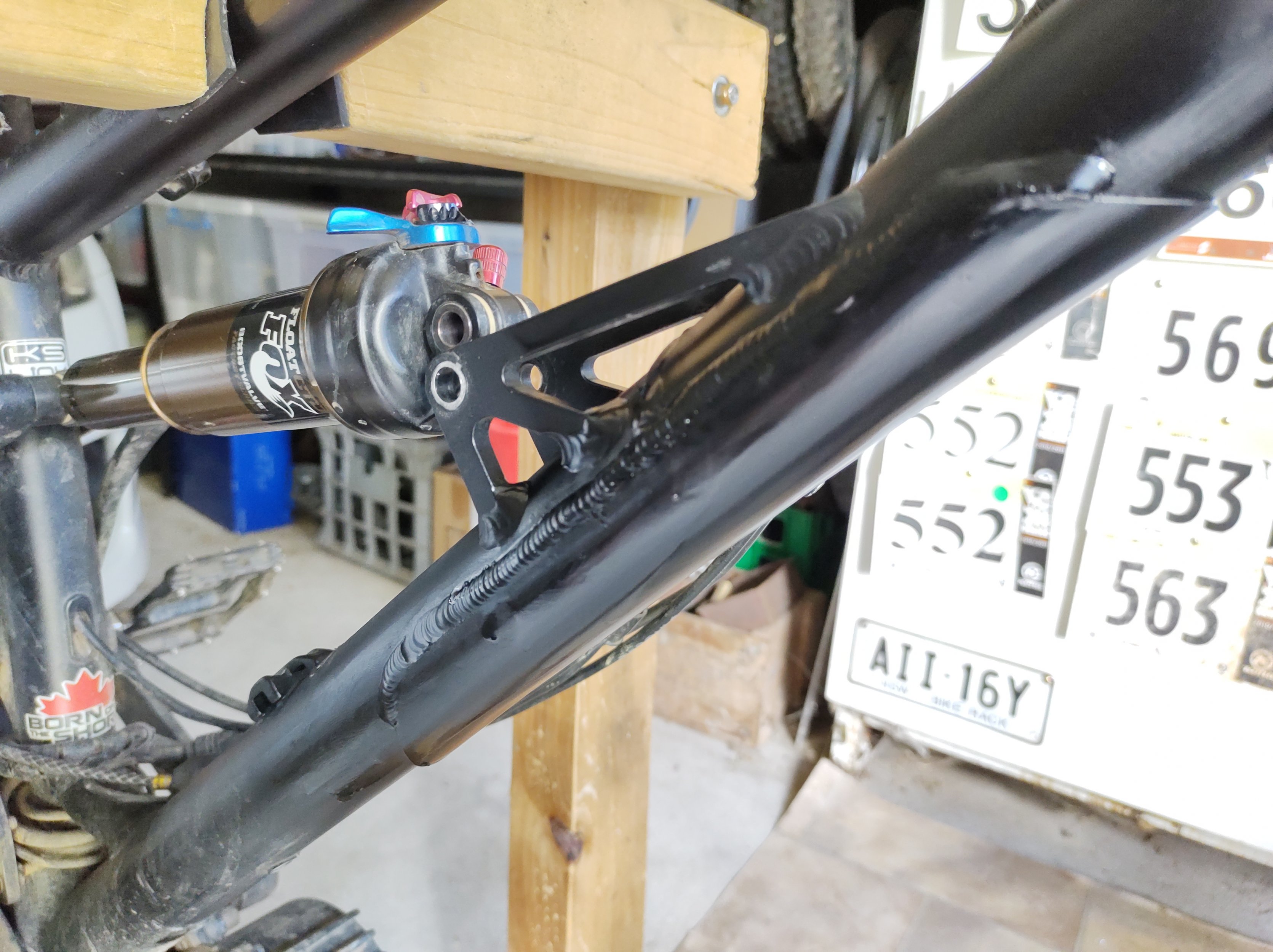

Seeing as this has been dug up , update.
I cracked the down tube at the shock mount , rewelded and reinforced it. I suspect the crack started at one of the extra rivnuts I added to support the battery.
Shortly after that , I sold the bike to a friend that uses it mostly for commuting and bike paths.
The frame is still on the original headset and pivot bearings.
The motor now has around 7000kms on it , the only sign of wear is some lateral play in the spindle.
So well done Banshee and Bafang. 👍
