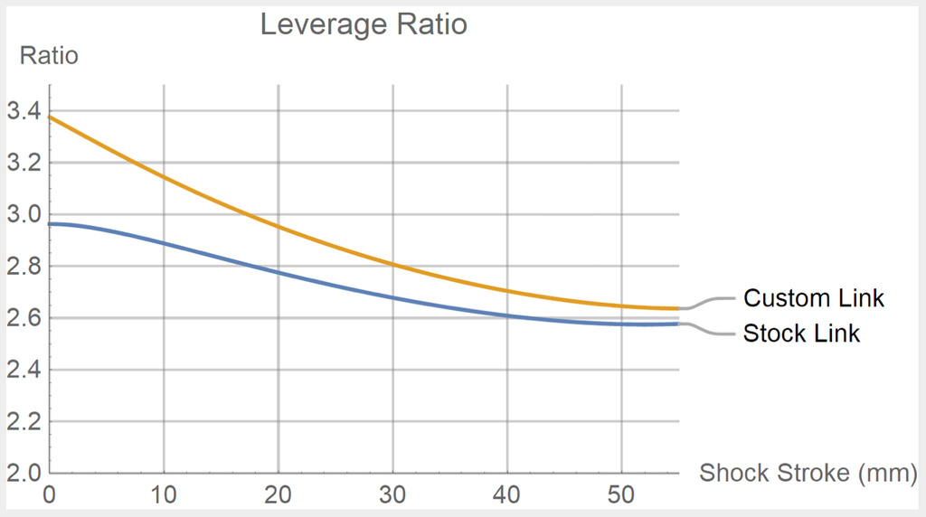

I have a long experience with Coil Vs. Air shock.
By looking into the LEVO Leverage-Ratio (see picture- BLUE LINE). It not design for a coil - you probably Bottom-up
very quickly! + you losing the "pop" of the back - more planted feel from already "planted" feeling bike + Specialized probably tune the shock to the bike. You need a full tunable shock to do it ($$$)
Trust me - do not enter to this adventure :sneaky:

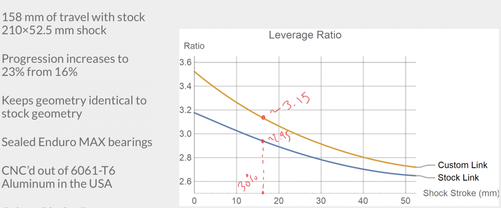

So the CC link is more progressive (23% vs. 16% stock link), but it has a higher overall leverage rate, biased to the beginning of the curve:
At the 30% sag (~ 16.5mm for your 55mm stroke), the leverage rate of the CC link is about 6% higher leverage ratio. Meaning - you will need more force at the shock to hold the same sag position. CC recommends 5% more spring rate on their site.
That being said, if you are thinking that the 600lb spring was a bit firmer than you would like on the Levo, this link could definitely help with that. It will be plusher off the top and not give too much on the bottom out or midstroke, especially if you feel you are oversprung.
