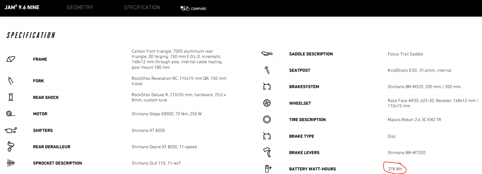

Not really - looking at the spec sheet the Shimano bikes look the same as before i.e. it is 378Wh on the internal battery, 756Wh with the Tec pack added:
I think they havent updated the spec sheet. The body text says 'now with mahoosive batteries' [paraphrased]
