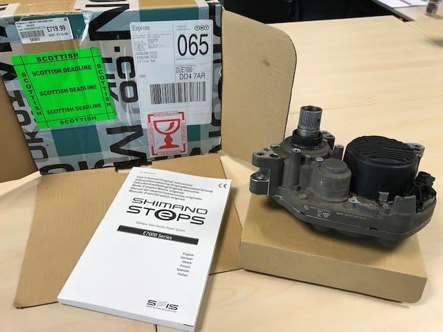

Description: Hey folks,
For sale is a 4 month old Shimano E7000 Steps Motor drive unit for spares or repairs.

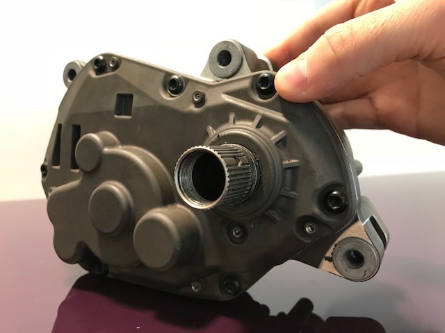

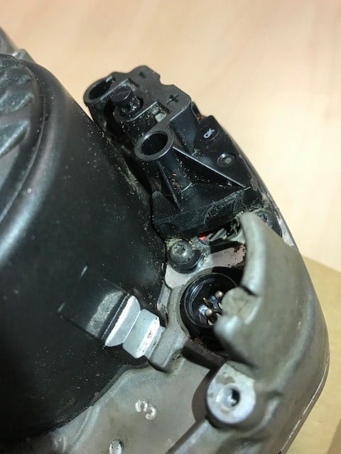

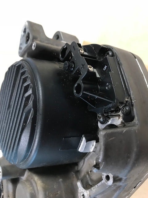

This unit has done approx 300km total and came off my 2019 Vitus E Sommet. On my second ride in March 2019 I dinged the front of the motor unit off a rock on a gnarly rock garden and cracked the plastic section of the motor where the connectors go inside the unit. The unit continued to work fine until 7th June this year when it started to work intermittently and would frequently give a E010 error code. As of 1st July the unit was constantly showing the E010 code and since then has sat in storage while I awaited my new motor unit.
The crack at the bottom black plastic housing has created a small hole and disrupted the seal around it where I suspect water and dirt have likely ingressed to the connections. Possibly a short or dirty connections but I decided not to open the unit for fear of voiding the warranty at that time. You can see pic of the hole where I have shown a torch down on it and you can see wiring inside.
In the end, the retailer would not exchange or repair on warranty due to accidental damage. Took bike to local Shimano service centre and they ran diagnostics. All green lights on diagnostics and motor powering on properly but still displaying constant E010 error code. Decided it wasn't worth paying labor costs for them to troubleshoot and repair and with my lack of technical knowledge on fixing electrical issues, I ended up purchasing a brand new drive unit form Shimano/Madison direct for £720.
Selling this unit for £300 posted
Will be a bargain some anyone who has time, patience and technical know how to repair electrical issue, or would be a good second motor for spares and repairs (connectors, bearings internals etc.)
Unit is interchangable with the E8000 drive unit (Same mounting) so any electrical savvy E8000 owners may be interested to get this repaired as a replacement for future.
Unit is sold as seen in pics and comes with full instruction manual and official padded shipping box form Shimano/Madison.

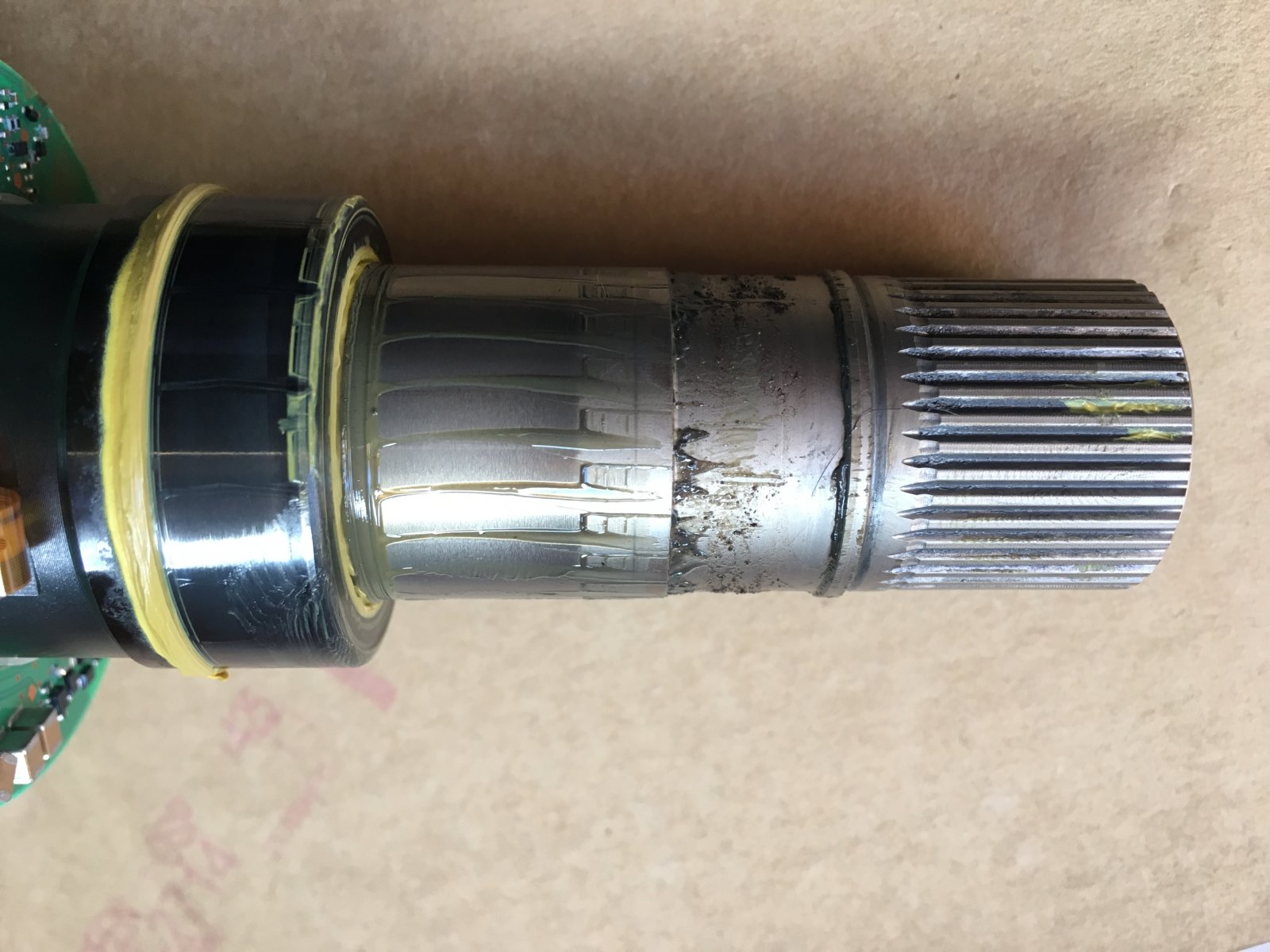

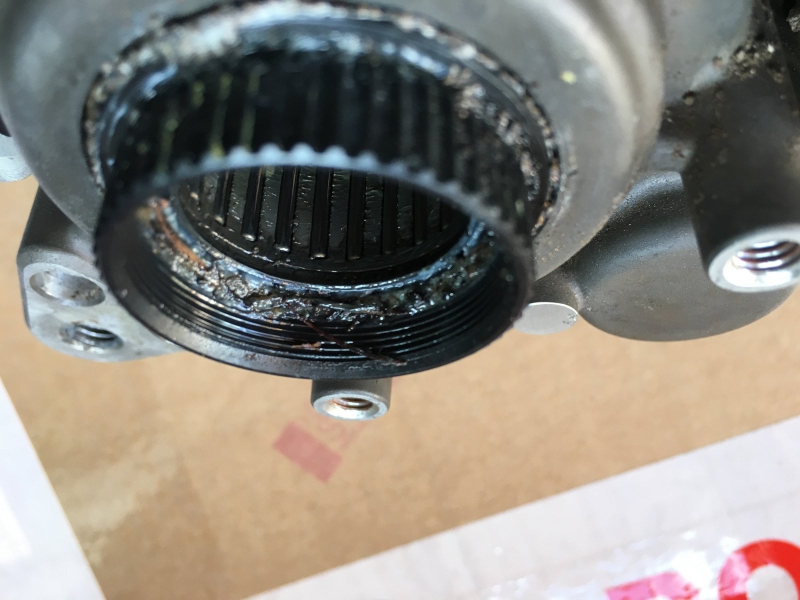

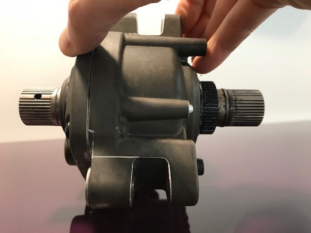

Bad news Gary, I have just pulled the Shimano E7000 apart and it's not something that you would want to repair in your shed! In order to get the guts out, the circuit board must be un-soldered! (Fortunately, the circuit board on our motor was all green and furry so I just cut it free.) Un-soldering is not as easy as it sounds and presents a considerable risk to repairing this motor.
I can see why they fail so often though. They have a needle roller drive shaft bearing sat just behind a thin single lip seal. Just behind that is a metal shielded bearing that on the motor I have has failed along with the needle bearing. You can see the grease in the needle bearing has emulsified and the dirty grease on the crankshaft looks like grinding paste.
I hope the E8000 is more repairable than the 7000, because we are going to be busy when they are out of warranty!

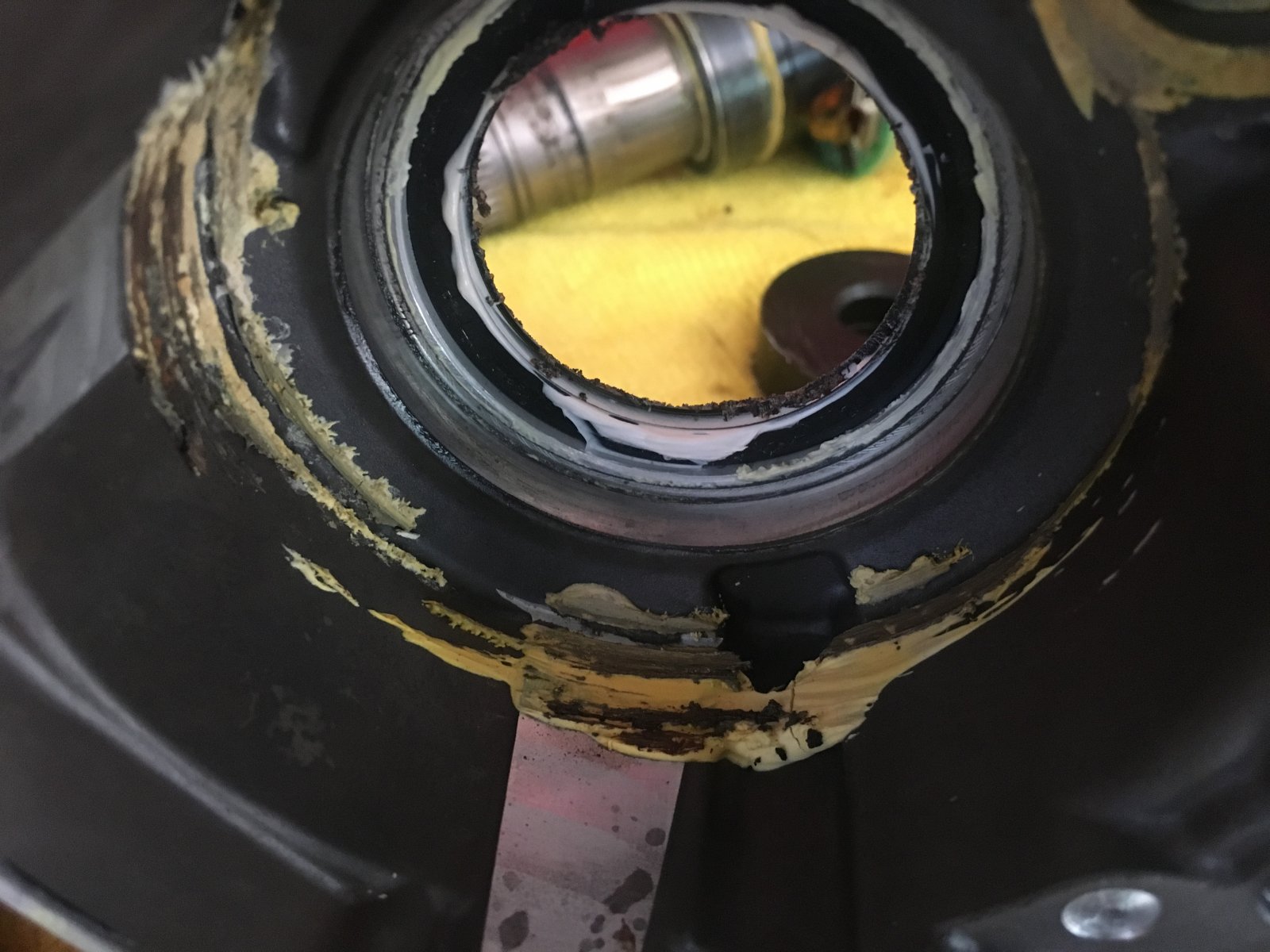

A lot of dirt has come past the seals. The outer seal had let water into the "non sealed" bearing and damaged it, but as you can see from the contamination in the grease shown below, it's a lot for just 300Km! Imagine how the inside of your motor would look after 1,000Km's

I would say that without expert knowledge of de-soldering very large terminal post from triple layer circuit boards (especially when 3 post have to be de-soldered at the same time without melting the very small components around it) repair will be near impossible.
The seals are manufactured for the casing they are installed into. This motor really is a use up and throw away item.

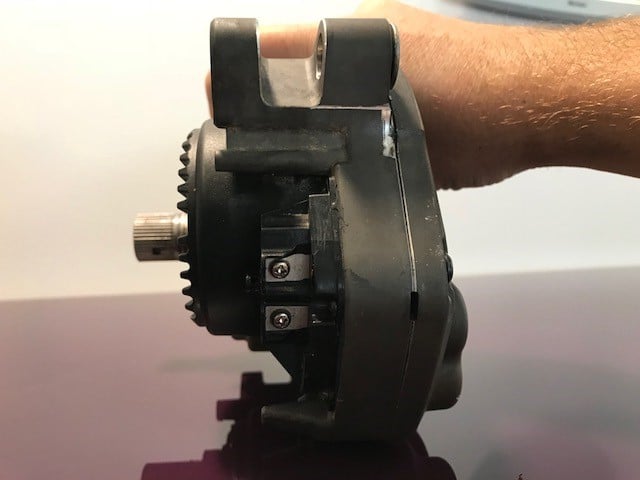

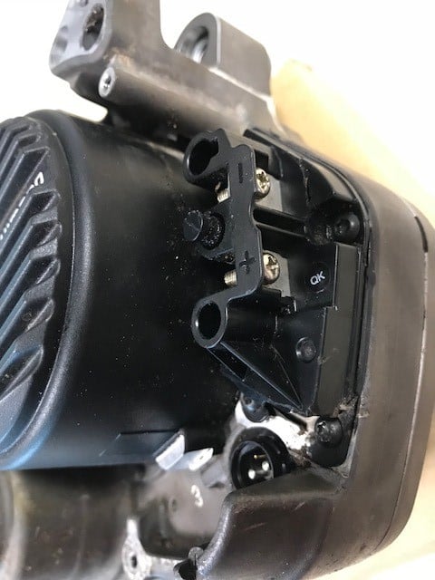

The E8000 is a lot easier to strip down. I have had my mates to bit's with the e010 fault and it is back up and running with no faults.
What did you repair inside the motor?
and how far did you strip it down?
Gary
Old Tartan Bollocks
Mar 29, 2018
10,496
10,690
the internet
Thanks. that's very helpful.
That main bearing on the crank axle in your pic looks fairly easily replaced. Any idea if the other side is as easily accessed/replaced?
ie. without messing with the circuit boards etc.

There does not look like much can be done in the way of preventative work. I would just say be gentle with your hose.
The motor I used had water in it and the circuit board had become corroded (green and furry)
It's a bit hard to tell from the photos but would it be possible to remove the external seals without disassembly and replace with a better quality seal? Or insert a wide thin sleejve in seal housing so 2 smaller outside diameter seals can be fitted ie a retrofit seal upgrade kit people can fit before they have a problem.
Bearing Man
Ebike Motor Centre
Sep 29, 2018
868
2,050
No, the seals look to be manufactured specifically for the motor so you're pretty much stuck with what you have unfortunately.

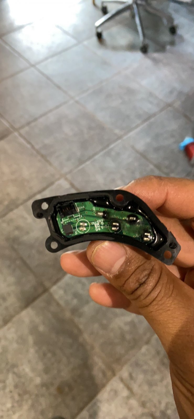

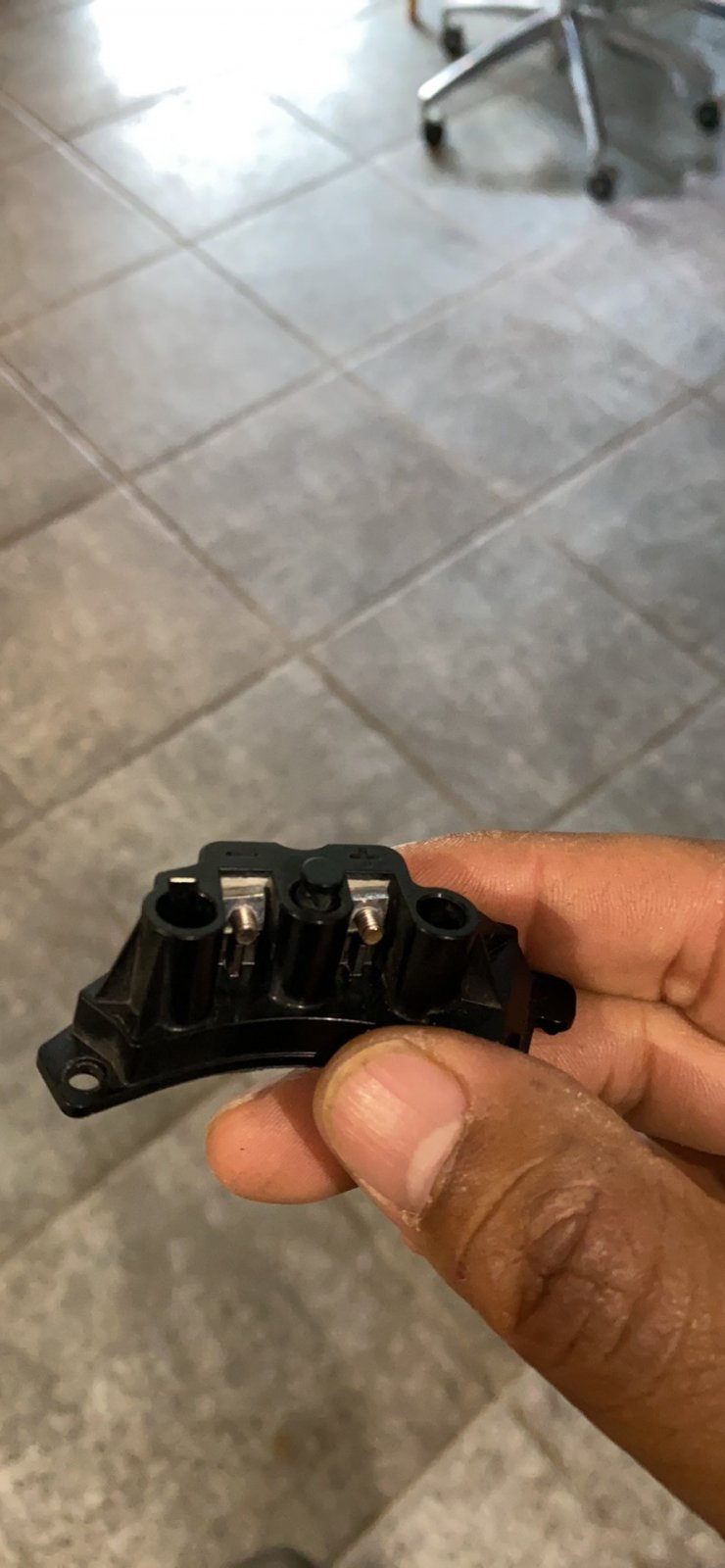

Shazza
Oct 10, 2021
Hi - Just following this post, Ive been trying to get my hands on that same switch for ages. Shimano dont stock it as a replaceable part and I dont want to buy a whole drive unit just for that!
Any ideas where I could get my hands on one?
Mine has started to arc causing it to short.
Just a thought (which you have probably already thought of) but is it possible to machine the casing to take a 'proper' seal? I only say that cos we used to do that on some old car engines which used shitty rear crank seals as stock.
