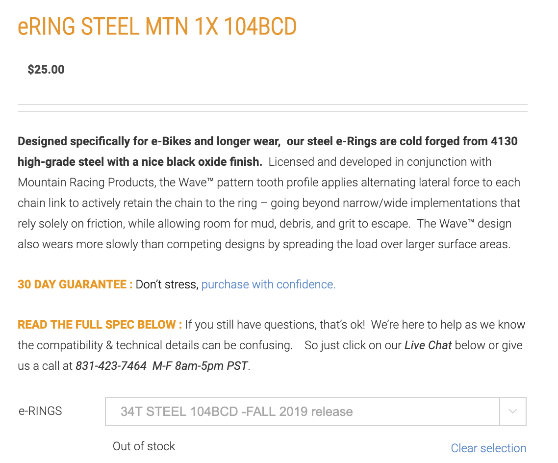

Praxis has a 36 tooth steel that'll bolt right on
eRING STEEL MTN 1X 104BCD - Praxis Works
For where I ride the 30 tooth is better. I just ordered a Wolf Tooth 30 tooth steel ring. It's pricey but it should last longer
At the moment only one of the planned Praxis eRing’s is available. I shall have to wait until the 34 tooth comes available

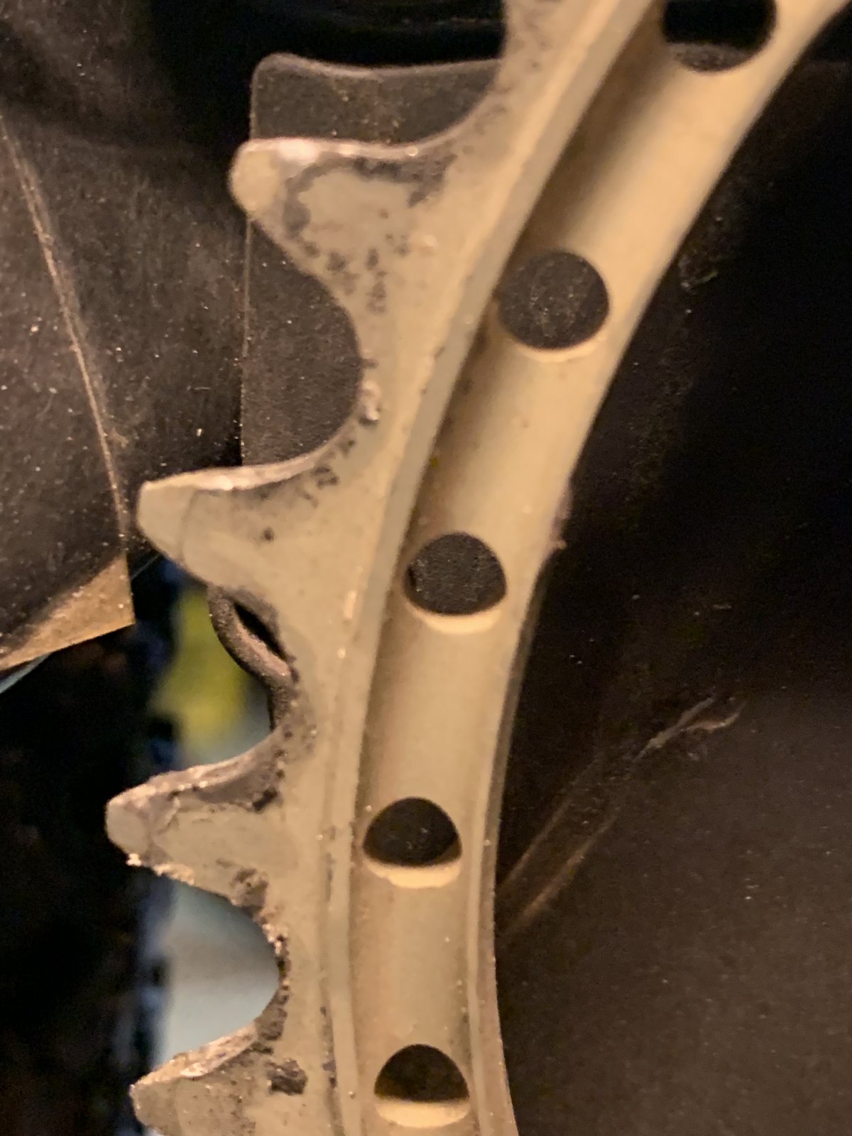

I got a 36t Alu chrainring from Renthal and after 600 km already showing a lot of wear. My best guess is that I will get max 1000 km out of it before it’s worn completely. I’m going back to steel ring for sure.

This is how my alu chainring looks like after 600 km. As seen in the picture the teeth are getting out of shape and deformed as well.

I ordered the praxis 34 tooth via the LBS this week , in stock , no problem
Not available in STEEL until later this year according to the Praxis Works website, you can get an alloy one. May be the website is incorrect, i shall contact them.
