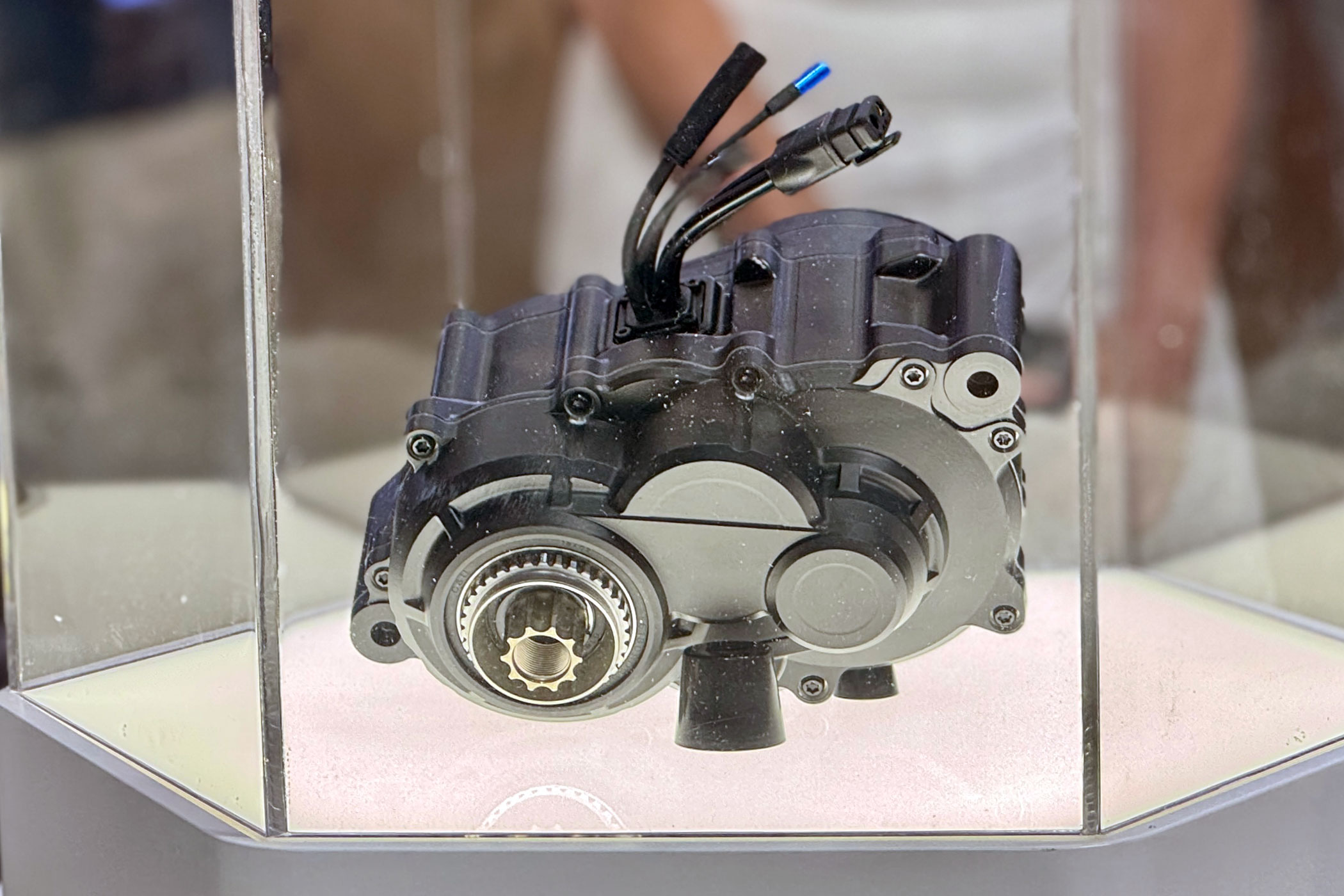

Avinox MG Concept motor-gearbox, drive side (Eurobike 2026)

The Avinox MG Concept is DJI Avinox's swing at the idea sweeping Eurobike 2026: kill the derailleur and the cassette, and bake the gearing into the motor. Avinox calls it a Motor Gearbox with stepless virtual gearing. It's one unit with no rear mech and no fixed gear steps, gear changes take around a tenth of a second, and you can run it as 4, 5 or 12 virtual gears or hand it to full AI auto. It was shown on concept bikes from Canyon, Commencal (a Meta Power SX prototype), Forbidden and Mondraker.
It arrived as the defining theme of Eurobike 2026. Integrated gearbox and eCVT drive units were the show's big story, with the MG landing alongside Gobao's eCVT and gearbox drives from Rotwild and others. It's the clearest sign yet that the industry wants to move the gears off the rear wheel and into the motor.
How 'stepless virtual gearing' works
The MG folds the drive motor and the entire transmission into one unit, then throws away the rear drivetrain. There's no derailleur, no cassette and no fixed mechanical gear steps. In their place is what Avinox calls stepless virtual gearing: the ratio between your pedalling and the rear wheel changes electronically across a continuous range rather than by jumping between sprockets.
Think of normal gears as steps and this as a ramp. Underneath there is effectively a continuous spread of ratios, and software then decides how that feels. You can run it as 4, 5 or 12 'gears', or hand it over to AI auto-shifting that picks the ratio for you from cadence, speed and gradient. Because it's electronic, a 'shift' takes about 0.1 second, happens under full load (up to ~300 Nm at the transmission) and even at a standstill, and never drops the chain or skips.
Avinox is deliberately coy about the mechanism. It would not confirm whether the MG is a true CVT, but stressed it uses no special internal belts that could wear out, which points to an electronically-managed gear system rather than a rubber-belt variator. The unit stays compatible with either a chain or a belt final drive, claims a 520% range (on a par with a SRAM Eagle 10-52 cassette), runs at around 45 dB (the same as the M2 and M2S motors) and is rated to a 150 kg rider. Regenerative braking and a mechanical motor-lock anti-theft are listed as being explored.
It targets a similar power level to the current Avinox M2S, but Avinox did not publish torque or wattage for the MG. That, along with weight, battery and price, is still unknown.
