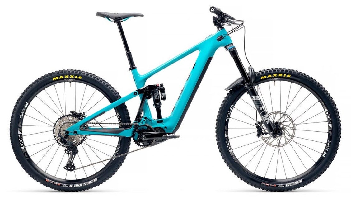

The Yeti 160E 2023 is the US boutique brand's halo enduro flagship: a T1 TURQ Series carbon chassis with Yeti's Sixfinity 6-bar linkage, 170 mm of fork travel paired with 160 mm of rear, the Shimano EP8 (DU-EP800) motor at 85 Nm of torque and 500 W peak, and a removable 630 Wh Shimano BT-E8036 battery. At a claimed 23.5 kg and £11,899 base price, this was firmly halo territory and built a passionate forum following. Production status is gold-listed as discontinued — Yeti has since launched a Bosch CX Gen 5-powered replacement per @Ou812. The 160E remains highly regarded in the used market.
Drive system and range. Shimano EP8 (DU-EP800) delivers 85 Nm of torque, 500 W peak and a 2.6 kg unit weight. It is now superseded by EP801, Bosch CX Gen 5 (120 Nm) and DJI Avinox (105–150 Nm) on headline numbers, but remains a refined and natural-feeling motor. The 630 Wh removable battery is small for a halo enduro by 2026 standards. @Singletrackmind directly identifies the 630 Wh as "limiting compared to 700/750/800 Wh competitors." @Gavalar reports his 160E with Shimano EP800 ran 2,360 miles over 2 years with no issues — strong long-term reliability data. @Lightme bought at close to 50% off and found the EP801 motor "more underwhelming than expected" but praised the suspension.
Geometry and handling. A 64.5 degree head angle is bang in the modern enduro sweet spot. Reach progresses cleanly: 430 mm (SM), 460 mm (MD), 480 mm (LG), 505 mm (XL). The 446 mm chainstay is held constant across sizes. Wheelbase grows 1,208 mm to 1,292 mm. @Gavalar reports the Large fits a 180 cm rider well with 50 mm stem and PNW Loam Bars with 38 mm rise. @Rob Rides EMTB measures the 160E's BB height at 350–355 mm — about 20 mm higher than the Reign E+, consistent with the bike's enduro/park rather than aggressive-trail bias. The Sixfinity 6-bar linkage is Yeti's signature: a complex, highly tunable kinematic with strong descending performance.
Build and value. Only the £11,899 T1 trim at 23.5 kg is gold-listed. @Singletrackmind documents the full spec: T1 TURQ Carbon, Sixfinity suspension, FOX Factory Float X2 rear shock, FOX Factory 38 GRIP 2 170mm E-Tune fork (with custom Yeti decals), Shimano XT shifters/derailleur/cassette and Shimano EM900 cranks. This was halo-spec engineering at halo-spec pricing.
Community-verified strengths. Suspension performance is the standout. @Singletrackmind calls Push Industries suspension transformative and describes the Yeti as "an absolute beast that wants to ride fast — best stock suspension on any ebike." @Singletrackmind directly compares Yeti to Specialized Levo S-Works and prefers Yeti hands-down on riding characteristics. @Evolkenevol describes the Yeti 160E MTE rear suspension as "amazing — handles rough terrain incredibly well." @Gavalar praises Shimano Linkglide drivetrain compatibility for the 160E platform.
Caveats and known gripes. Pricing controversy is the recurring forum theme. @Hob Nob calls out "£12k on a bike with an off-the-shelf EP8 system when you can buy an almost identical specification bike from another brand for literally half the price" and notes "Yeti's legendary abysmal customer service" from personal experience. @Gary mocks Yeti's marketing line "while everyone else was racing to make an e-MTB, we were making an e-MTB for racing" then putting a Shimano motor in it. @Singletrackmind notes the carbon frame can flex and creak after 2,000+ miles — a long-term wear concern. @MarkE192 moved away from the 160E (and Pivot Shuttle LT) for a Gen 4 Levo, citing motor reasons. The 630 Wh battery limit, EP8 motor now-dated against Bosch CX Gen 5, and Yeti's service-network reputation are all consideration points.
Verdict. The Yeti 160E was a strong-performing halo carbon enduro with class-leading suspension performance via the Sixfinity 6-bar linkage and 23.5 kg claimed weight. With the gold-listed discontinued status, this is now a used-market purchase (or end-of-line clearance at meaningful discount per @Lightme's ~50% off experience). It will suit affluent buyers who prioritise suspension performance and ride character over outright motor power and modern battery capacity, and who can absorb Yeti's premium pricing and known service-network frustrations. Anyone wanting fresh Bosch CX Gen 5 power, 800 Wh battery, established UK dealer support and current production status should look at the Trek Rail+ Gen 5, Cube One77 SLX or new Bosch-powered Yeti replacement. Production status: discontinued.

Bike geometry diagram
SMLXL
Reach430 mm460 mm480 mm505 mm
Stack617 mm620 mm625 mm635 mm
Chainstay446 mm446 mm446 mm446 mm
Headtube Angle64.5°64.5°64.5°64.5°
Seattube Angle (eff)78°78°78°78°
BB Drop24 mm24 mm24 mm24 mm
Wheelbase1208 mm1240 mm1262 mm1292 mm
Headtube95 mm98 mm104 mm115 mm
Standover754 mm754 mm754 mm754 mm
Front Centre762 mm794 mm816 mm846 mm

T1
£11,899
MotorShimano EP8 (DU-EP800) · 85 Nm
BatteryShimano BT-E8036 · 630 Wh
Travel F/R170/160 mm
FrameCarbon
ForkFox 38 Factory, GRIP2 damper, E-Tune, Kashima
ShockFox Float X2 Factory, Kashima
HeadsetCane Creek 110
HandlebarYeti Carbon, 800mm, 35mm clamp
GripsODI Elite Pro
SaddleWTB Silverado Custom
SeatpostRockShox Reverb AXS
BrakesSRAM Code RSC, 4-piston (220mm front / 200mm rear rotors)
Rear derailleurShimano Deore XT M8100, 12-speed
CrankShimano EM900, 34T, 160 mm
ShiftersShimano Deore XT M8100, 12-speed
CassetteShimano Deore XT M8100, 12-speed, 10-51T
ChainShimano Deore XT M8100, 12-speed
DrivetrainShimano Deore XT M8100, 12-speed; Shimano EM900, 34T, 160 mm; Shimano Deore XT M8100, 12-speed; Shimano Deore XT M8100, 12-speed, 10-51T; Shimano Deore XT M8100, 12-speed
TyresMaxxis Assegai 29x2.5 EXO+ front / Maxxis Minion DHR II 29x2.4 DoubleDown rear
Weight23.5 kg
