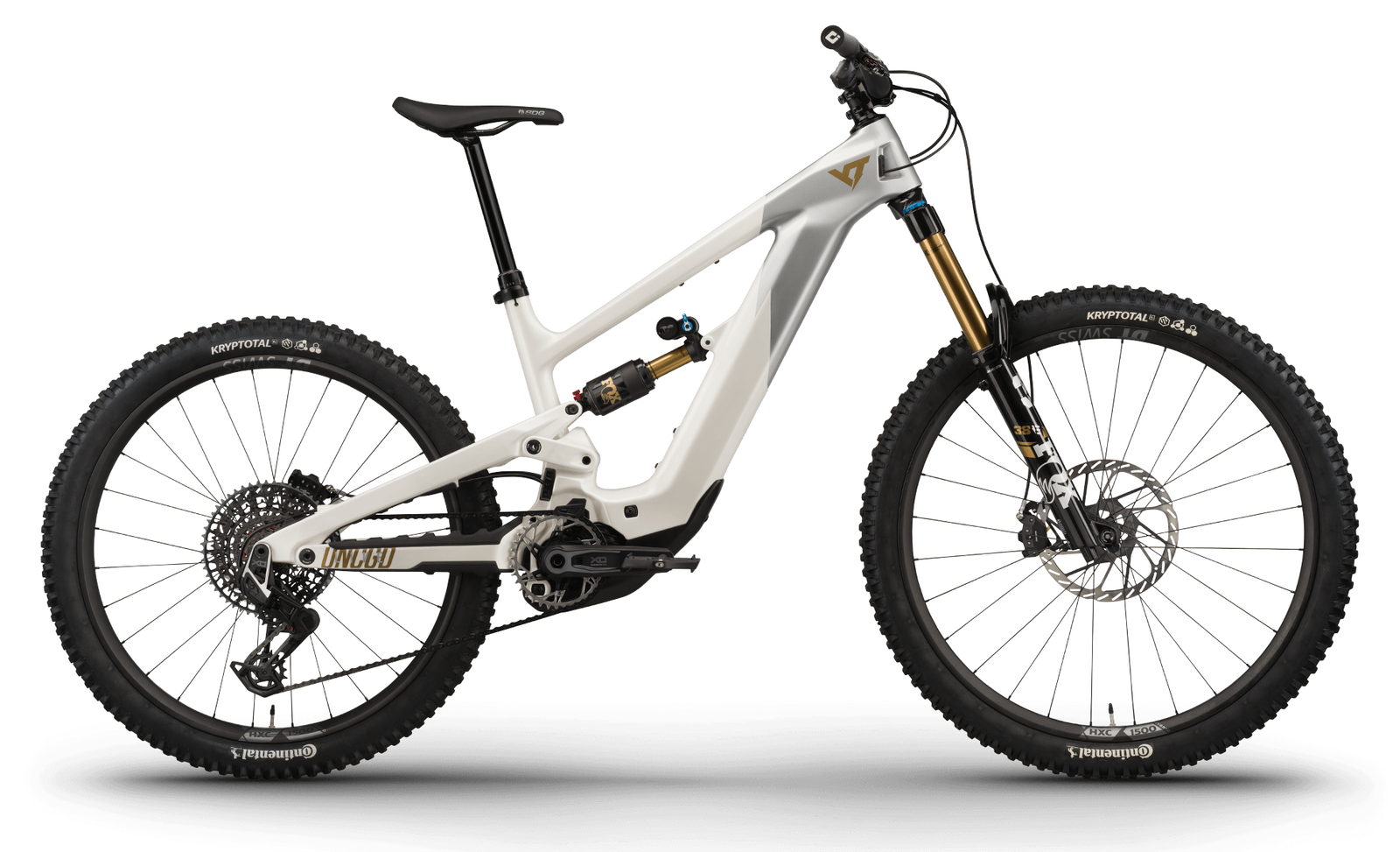

YT Industries Decoy 2026
From £5,999
EMTB Forums verdict
The all-new Decoy is YT's full-power gravity e-MTB, rebuilt around the Bosch Performance Line CX Gen 5 motor (100Nm, 750W peak) and an 800Wh PowerTube battery. It runs 180mm up front and 170mm out back through YT's V4L Horst-link suspension, an Ultra Modulus carbon frame and a mullet wheel setup with a 29in front and 27.5in rear. A flip chip at the shock mount switches between a Regular and a Low geometry setting.
Four builds span the range. The CORE 1 at GBP 5,999 pairs a Marzocchi Bomber Z fork and SRAM DB8 brakes with a Shimano Deore drivetrain. The CORE 2 at GBP 6,999 steps up to a RockShox Zeb Select+ and Vivid Select+ with SRAM Eagle 90 Transmission and TRP EVO PRO brakes. The CORE 3 at GBP 7,999 brings Ohlins RXF38 M.3 and TTX22 M.2 suspension with SRAM S1000 Transmission. The halo CORE 4 at GBP 8,999 runs FOX 38 Factory and X2 Factory, SRAM X0 Transmission, DT Swiss HXC 1500 carbon wheels and SRAM Maven Silver brakes on HS2 rotors, with a claimed weight of 23.2kg.
