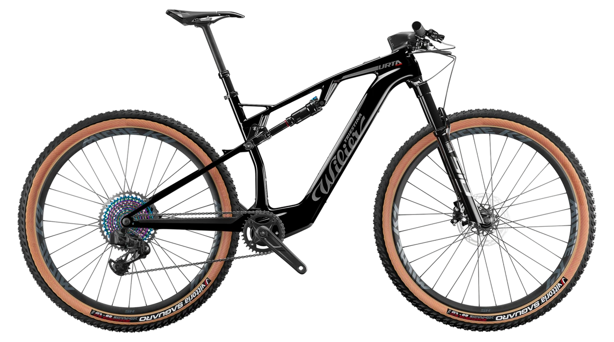

Urta Hybrid 2025
Lightweight (sub-16kg) carbon down-country eMTB; Fazua Ride 60 (60Nm/450W) with 430Wh battery + optional 210Wh extender
The Wilier Urta Hybrid 2025 is a carbon down-country eMTB from the Italian brand Wilier, built around the Fazua Ride 60 motor with a 430 Wh removable battery. Headline numbers: 120 mm of fork and rear travel, 60 Nm of torque, an exceptionally light 16.4 kg claimed weight, a 66 to 66.7 degree size-tuned head angle and reach progressing 406 mm on S, 432 mm on M, 458 mm on L and 485 mm on XL. The Urta Hybrid is the eMTB sibling of Wilier's renowned analogue Urta cross-country bike, and positions itself in the rare territory of "true XC eMTB" rather than the more common trail or all-mountain niches. No curated rider quotes are yet on file for this specific bike on the forum.
Drive system and range. The Fazua Ride 60 delivers 60 Nm of torque, 250 W nominal and a manufacturer-claimed 450 W peak from a remarkably light 1.98 kg motor. Fazua's character is famously smooth, natural-feeling and one of the quietest mid-drives in eMTBs, which suits the XC and down-country brief perfectly. The Fazua Energy 430 Wh battery is removable, useful both for spare-pack riders and as a way to drop weight further when riding shorter laps. Real-world range on Fazua at 430 Wh in a low-travel XC bike with low rolling resistance typically lands 50 to 80 km depending on assist, vert and rider weight. The Fazua optional 210 Wh range extender lifts total capacity to ~640 Wh for big race or marathon days.
Geometry and handling. A 66 degree head angle on S and 66.7 degrees on M, L and XL is squarely cross-country and down-country territory, steeper than 65 degree trail rivals and pointing to a quick-handling, climb-focused ride character. The 448 mm chainstay is held constant across all sizes. Reach progression is consistent: 406 mm S, 432 mm M, 458 mm L, 485 mm XL. Wheelbase 1148 to 1231 mm is on the shorter side for any eMTB, again reflecting the XC focus. With 120 mm of travel front and rear, this is a true XC and down-country tool, not a do-it-all trail bike.
Build and value. Wilier publishes a single base trim at £9999, 16.4 kg, for the spec we have on file. At this premium price you get the Fazua Ride 60 drive unit, a 430 Wh removable battery, the carbon Urta chassis with single-pivot rear suspension and the prestige of the Wilier brand. £9999 puts the Urta Hybrid at the premium end of the lightweight eMTB market: a Specialized Levo SL Expert sits at around £8000, an Orbea Rise M-Team at around £6500, and a Trek Fuel EXe 9.7 at around £7500. The premium reflects Wilier's Italian carbon manufacturing heritage and the unique XC-focused positioning, with the trade-off of a less developed eMTB dealer network outside Italy.
Verdict. The Wilier Urta Hybrid 2025 is a niche, premium Italian XC eMTB. Strengths are real. The 16.4 kg claimed weight is genuinely exceptional, comfortably the lightest in mainstream eMTBs and approaching analogue trail-bike weights. The 120/120 mm chassis paired with the 66 to 66.7 degree head angle and 448 mm chainstay creates one of the few true XC-and-down-country eMTBs on the market, suited to long-distance racing, marathon events and rapid climbing rather than aggressive descending. The Fazua Ride 60 motor is smooth, quiet and natural-feeling, supporting the analogue ride character. And the removable 430 Wh battery is a useful flexibility win. The honest caveats are equally clear. 120 mm of travel and a 66.7 degree head angle is firmly XC territory: this is not a do-everything trail bike, and descents on rough terrain will feel under-suspended. £9999 is premium pricing: lighter rivals at similar travel are available for less, with a Specialized Epic 8 EVO or Trek Top Fuel sitting at lower price points. Wilier's eMTB dealer network outside Italy is thin, so warranty service for UK and EU buyers may depend on independent shops or shipped-in support. No curated forum quotes are yet on file: long-term reliability data for this specific 2025 build is limited. The fixed 448 mm chainstay across all sizes is the typical missed-trick for taller riders. The Urta Hybrid suits the rider who wants a properly light Italian XC and down-country eMTB with Fazua power, a removable battery and the Wilier brand prestige, and is happy to pay the premium and accept thin international dealer support. Riders prioritising broader travel range, value, slacker geometry or stronger dealer backstop should look at a Specialized Epic, Trek Top Fuel or Orbea Rise. Production status is current.
