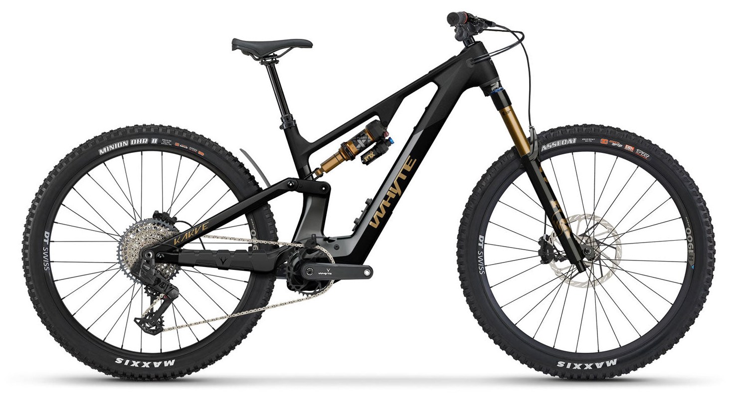

What it is: The Whyte Karve is a British-designed 160/160 mm full-power trail/enduro eMTB, launched May 2026 around the DJI-built Avinox M2S motor — 150 Nm peak torque, 1300 W peak power, 250 W nominal — fed by an 800 Wh fixed internal battery. It runs 29in wheels (MX-ready), Whyte's Quad-Link 4 suspension and a flip-chip giving ±0.6° head angle / 8 mm BB adjustment. Two builds share the same frame platform, motor, battery and geometry — the difference is purely spec. Whyte sells a longer-travel Karve EVO (180 mm, mullet) above it for gravity/bike-park use.
  • Drive: Avinox M2S, 150 Nm / 1300 W peak, 800 Wh battery, Avinox DPC100 OLED top-tube display + wireless bar controller. This is the same DJI Avinox unit that powers the Amflow PR — currently the highest-torque mainstream eMTB motor.
  • Geometry (S/M/L/XL): reach 444 / 469 / 494 / 519 mm; 64° / 63.4° head angle (high/low); 77.9–79° effective seat angle; 350.8 mm BB height; wheelbase 1220–1333 mm; size-specific rear centre 445–465 mm (longer on L/XL). Genuinely modern, balanced enduro numbers with proportional chainstays.
  • Charging: the RSX ships a 12 A fast charger (0→80% ≈ 1 hr 45) vs the RS's 4 A unit (≈ 4 hr 54) — a real difference if you ride most days.
RS (£5,650) vs RSX (£7,799) — where the £2,149 goes: The RS pairs a carbon-mainframe / 6061-alloy-rear frame with RockShox Lyrik Select + Super Deluxe Select, mechanical SRAM Eagle 90 T-Type shifting and Maven Base brakes on Whyte's own alloy wheels, with the slower 4 A charger. The RSX steps up to a full-carbon frame (RideWrap protection fitted as standard), Fox Factory suspension (36 Factory GRIP X2 fork + Float X Factory shock, both custom-tuned for Whyte), wireless SRAM AXS (S1000 AXS mech, GX T-Type chain), Maven Silver brakes, DT Swiss Hybrid H1900 wheels and the 12 A fast charger. Both share 155 mm Whyte cranks, Maxxis Assegai (EXO+, MaxxGrip) front / Minion DHR II (Double Down, MaxxTerra) rear tyres, and a size-specific TranzX +RAD dropper (150 / 170 / 200 mm).
Who it's for & value: a full-power, mid-travel all-rounder for riders who want big-battery range and the M2S's class-leading torque without committing to a 180 mm gravity sled. The RSX is the standout-value build of the two — a full-carbon frame with Fox Factory and wireless AXS at £7,799 undercuts a lot of comparably-specced Avinox bikes — while the RS is the sensible pick if you're happy with mechanical shifting and a slower charge. Both come trail-ready with an aggressive, correct tyre choice (MaxxGrip front / Double Down rear) rather than the under-gunned rubber many brands fit.
Worth knowing (launch-day caveats): the Karve was announced in May 2026 as “coming this summer” and is currently listed sold-out-online / dealer-only, so there is no long-term reliability or owner-ride data yet — this verdict is grounded in Whyte's published spec and geometry, not ownership experience. Claimed weights are still TBC from Whyte, and as an Avinox Smart-System-style bike the custom motor covers aren't compatible with the aftermarket Bosch alarm/tracking module. We'll refresh this once forum members start logging real miles.

MotorAvinox M2S · 150 Nm · all trims
BatteryAvinox FP800 · 800 Wh · all trims
Travel F/R160/160 mm · all trims
FrameCarbon mainframe, aluminium (6061 alloy) rearFull carbon (uni-directional carbon mainframe + carbon rear triangle)
ForkRockShox Lyrik Select, 160mm, 44mm offset, Delta RC damper, Fast Black, tapered, 110x15mm Boost, Maxle StealthFox Float 36 Factory, 160mm, 44mm offset, Grip X2 damper custom tuned for Whyte, tapered, 110x15mm Boost
ShockRockShox Super Deluxe Select, DebonAir, 230x57.5mm, custom tuned for Whyte, adjustable reboundFox Float X Factory DPS, EVOL LV, 230x57.5mm, custom tuned for Whyte
HeadsetFSA custom, ZS56 upper/lower, sealed bearings · all trims
StemWhyte, 35mm extension, 35mm bore · all trims
HandlebarWhyte Custom 7050 alloy, 40mm rise, 35mm bore, 800mm · all trims
GripsWhyte Enduro lock-on · all trims
SaddleWhyte Custom · all trims
SeatpostTranzX +RAD dropper, 34.9mm (S 150mm / M 170mm / L–XL 200mm) · all trims
BrakesSRAM Maven Base, 4-piston, 220mm front / 200mm rear Centreline rotorsSRAM Maven Silver, 4-piston, 220mm front / 200mm rear HS2 rotors
Rear derailleurSRAM Eagle 90 T-Type mechanical, 12-speedSRAM S1000 AXS Eagle, 12-speed
CrankWhyte 155mm ISIS, SRAM direct-mount 36T, T-Type · all trims
ShiftersSRAM Eagle 70, 12-speedSRAM AXS rocker pod (MMX), 12-speed
CassetteSRAM XS-1270 T-Type, 10-52T, 12-speedSRAM XS-1275 T-Type, 10-52T, 12-speed
ChainSRAM Eagle 70, 12-speedSRAM GX T-Type, 12-speed
DrivetrainSRAM Eagle 90 T-Type mechanical, 12-speed; Whyte 155mm ISIS, SRAM direct-mount 36T, T-Type; SRAM Eagle 70, 12-speed; SRAM XS-1270 T-Type, 10-52T, 12-speed; SRAM Eagle 70, 12-speedSRAM S1000 AXS Eagle, 12-speed; Whyte 155mm ISIS, SRAM direct-mount 36T, T-Type; SRAM AXS rocker pod (MMX), 12-speed; SRAM XS-1275 T-Type, 10-52T, 12-speed; SRAM GX T-Type, 12-speed
WheelsWhyte eMTB sleeved rims, 30mm internal width, tubeless ready, 29in front and rear, on alloy e-bike-specific double-sealed cartridge-bearing hubs (12x100mm front, 12x148mm Boost rear, HG freehub), 14g stainless spokesDT Swiss Hybrid H1900, 29in front and rear, MX ready (front hub 110x15mm Boost six-bolt; rear hub 12x148mm Boost, SRAM XD steel driver, six-bolt)
TyresMaxxis Assegai WT 29x2.5 EXO+ 3C MaxxGrip (front); Maxxis Minion DHR II WT 29x2.5 Double Down 3C MaxxTerra (rear) · all trims
Weight23 kg
Price£5,650£7,799
