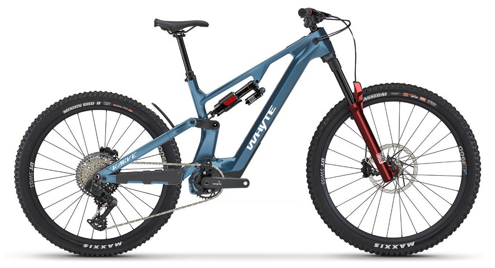

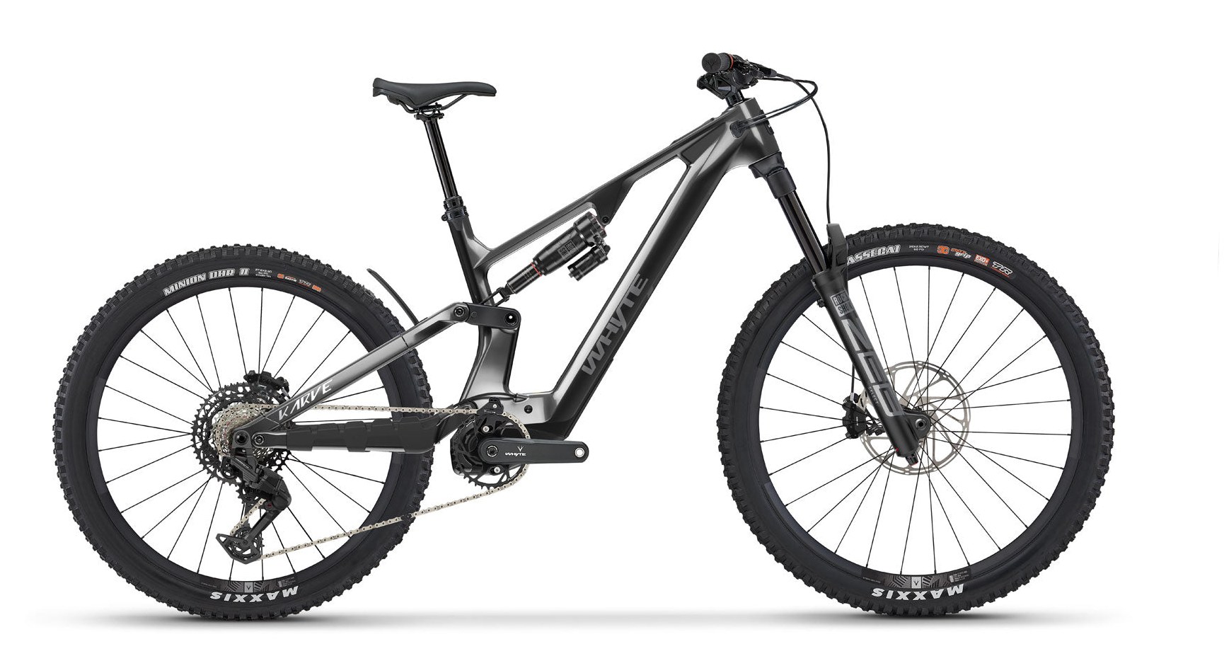

RS
£5,650
RSX
£7,299
MotorAvinox M2S · 150 Nm · all trims
BatteryAvinox FP800 · 800 Wh · all trims
Travel F/R180/180 mm · all trims
FrameCarbon mainframe, alloy rear · all trims
ForkRockShox ZEB Select, 180mm travel, 44mm offset, Linear XL, Delta RC damper, Fast Black coating, tapered steerer, 110mm x 15mm Boost, Maxle stealthRockShox ZEB Ultimate, 180mm travel, 44mm offset, Linear XL, Charger 3.2 damper
ShockRockShox Super Deluxe Select RT, DebonAir, Fast Black coating, adjustable rebound, 230 x 62.5mm, custom tuned for WhyteRockShox Vivid Ultimate RC2T, 230 x 62.5mm, custom-tuned for Whyte
HeadsetFSA custom, ZS56 upper/lower (1 1/8in upper, 1.5in lower), sealed bearings · all trims
StemWhyte, 35mm extension, 35mm bar bore · all trims
HandlebarWhyte Custom 7050 alloy, 40mm rise, 35mm bar bore, 800mm wide · all trims
GripsWhyte Enduro lock-on · all trims
SaddleWhyte Custom · all trims
SeatpostTranzX +RAD dropper, 34.9mm (S 150mm / M 170mm / L–XL 200mm) · all trims
BrakesSRAM Maven Base hydraulic disc brake, four piston, sintered metal pads, 220mm six bolt Centreline rotors (front); SRAM Maven Base hydraulic disc brake, four piston, sintered metal pads, 200mm six bolt Centreline rotors (rear)SRAM Maven Silver hydraulic disc brake, four piston, sintered metal pads
Rear derailleurSRAM Eagle 70 T-Type mechanical, 12 speedSRAM S1000 AXS Eagle, 12 speed wireless
CrankWhyte 155mm ISIS, SRAM direct-mount 36T chainring, T-Type · all trims
ShiftersSRAM Eagle 90, 12 speed · all trims
CassetteSRAM XS 1270, T-Type, 10-52T, 12 speedSRAM XS-1275, T-Type, 10-52T, 12 speed
ChainSRAM Eagle 70, 12 speedSRAM GX T-Type, 12 speed
Drivetrain1x12 SRAM Eagle 70 T-Type mechanical, SRAM Eagle 90 shift lever, SRAM XS 1270 T-Type 10-52T cassette, SRAM Eagle 70 chain, Whyte 155mm ISIS crank arms with 36T chainring, SRAM direct mount1x12 SRAM S1000 AXS Eagle T-Type wireless electronic
WheelsWhyte eMTB sleeved rims, 30mm internal width, tubeless ready, 29in front, 27.5in rear; Maxxis Assegai WT TR 29x2.5in 120TPI EXO+ MaxxGrip (front); Maxxis Minion DHR 2 WT TR 27.5x2.5in 120TPI Double Down MaxxTerra (rear)DT Swiss Hybrid HF1900 wheelset, MX (29in front / 27.5in rear)
TyresMaxxis Assegai WT, TR, 29x2.5in 120TPI, EXO+ Sidewall, 3C MaxxGrip front / Maxxis Minion DHR 2 WT, TR, 27.5x2.5in 120TPI, Double Down, 3C MaxxTerra rearFront: Maxxis Assegai WT, TR, 29in x 2.5in, 120TPI, EXO+ Sidewall Protection, 3C MaxxGrip; Rear: Maxxis Minion DHR 2 WT, TR, 27.5in x 2.5in, 120TPI, Double Down casing, 3C MaxxTerra
Weight24.4 kg23.9 kg
Price£5,650£7,299
