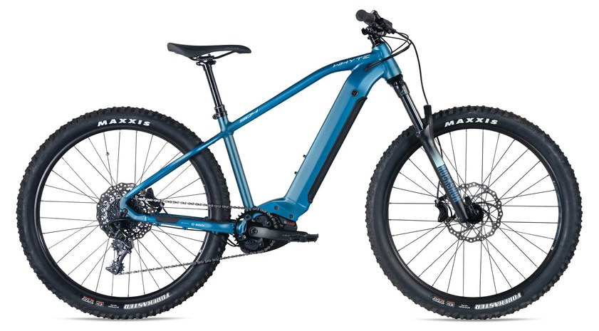

The E-504 was Whyte's compact Bosch-powered hardtail eMTB, billed by the brand as a "big tyre brawler" built off its award-winning enduro hardtail platform. At £3,599 at launch (rising to £3,825 by mid 2022) it paired the 85Nm Bosch Performance Line CX motor and an integrated 500Wh battery with a 120mm RockShox 35 Gold RL fork, 27.5 x 2.6in Maxxis Forekaster tyres and four-piston Tektro Orion brakes on 200mm rotors front and rear.
The single build was sensibly specced for hard use rather than headline value: SRAM GX 11-speed shifting with a steel 11-42 PG-1130 cassette, a Whyte drop.it dropper on every size, WTB ST i30 tubeless-ready rims and Whyte's own steel narrow-wide 165mm crankset. The basic Purion display and 2 Amp charger were the clearest cost savings.
Geometry was aggressive for a hardtail of its day: a 64 to 64.5 degree head angle, 74.5 degree seat angle, 440mm chainstays and reach from 403mm (XS) to 450mm (M). The E-504 deliberately covered the smaller end of the size range (riders 148 to 178cm) with XS, S and M frames, while its 29er sibling, the E-505, picked up M to XL.
It is long discontinued. The hardtail pair left Whyte's range after the 2022 to 2023 model years with no direct successor, as the brand's eMTB line moved to the full-suspension E-160, E-180 and later the lightweight ELyte and Karve platforms.

| Motor | Bosch Performance Line CX Gen 4 · 85 Nm |
| Battery | Bosch PowerTube 500 · 500 Wh |
| Travel F/R | 120/? mm |
| Frame | 6061 Alloy, Hydro Formed T6 Aluminium, Multi Butted, Custom Drawn, Tapered Headtube, Internal Cable Routing for Dropper Post and 12mm X 148mm Boost Dropouts |
| Fork | RockShox 35 Gold RL 27.5", 120mm Travel, 37mm Offset, DebonAir, Fast Black Coating, Adjustable Compression and Rebound, Tapered Steerer, 110mm x 15mm Boost, Maxle Lite |
| Headset | FSA No. 57B Orbit ZS, 1 1/2" Lower and 1 1/8" Upper Caged Bearings |
| Stem | Whyte Alloy 6061, 35mm Extension |
| Handlebar | Whyte 6061 Alloy, XS and S 15mm Rise, 31.8mm, 760mm, M 30mm Rise, 31.8mm, 780mm Wide |
| Grips | Whyte Lock-on V Grip |
| Saddle | Whyte Custom, Triple Panel Design |
| Seatpost | Whyte drop.it, 30.9, XS 100mm, S 125mm, M 150mm Travel, Paddle Remote Lever |
| Brakes | Tektro Orion, 4-Piston with Sintered Metal Pads, 200mm Disc, Post Mount (front and rear) |
| Rear derailleur | SRAM GX, 11 Speed |
| Crank | Whyte, Steel narrow/wide, 165mm, Direct Mount 36T for Bosch Performance Line CX, Black |
| Shifters | SRAM GX, 11 Speed |
| Cassette | SRAM PG-1130, 11-42, 11 Speed |
| Chain | KMC NPBK Sport, 11 Speed |
| Drivetrain | SRAM GX, 11 Speed; Whyte, Steel narrow/wide, 165mm, Direct Mount 36T for Bosch Performance Line CX, Black; SRAM GX, 11 Speed; SRAM PG-1130, 11-42, 11 Speed; KMC NPBK Sport, 11 Speed |
| Wheels | WTB ST i30 TCS 2.0 System, Pinned Joint, Tubeless Ready, 32 Hole |
| Tyres | Maxxis Forekaster TR 27.5" x 2.6" 60TPI, EXO Sidewall Protection |
