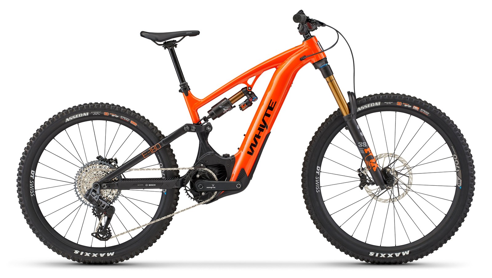

The E-180 is Whyte's full-fat alloy gravity eMTB: 180mm Fox or RockShox fork up front, 170mm out back, a Bosch Performance Line CX Gen 4 motor with the big 750Wh slide-out PowerTube, and MX wheels with DoubleDown-cased Assegais as standard. The tilted-motor, low-slung battery layout is the headline engineering story, pulling the centre of gravity down for bike park and big-mountain duty.
The two 2025 builds are unusually keenly priced. The £5,499 RSX gets Fox Factory 38 and Float X2, SRAM GX AXS T-Type shifting via AXS Pods, Code RSC brakes on 220/200mm rotors and DT Swiss HX1700 wheels, which is a spec many rivals charge well over £7,000 for. The £4,499 S drops to a RockShox ZEB and Super Deluxe Select R with GX AXS Eagle and Code R brakes, but keeps the same frame, motor, 750Wh battery and tyres, so the £1,000 step to the RSX buys suspension and drivetrain rather than anything structural.
Geometry is unapologetically gravity-led: a 63.2 degree head angle (62.7 in the Shape.It low setting), 444mm chainstays across the board and reaches of 455/483/510mm in the three sizes. There is no small frame, and at around 26kg claimed this is a bike specced for descending rather than ferrying itself around mellow trails. The Shape.It flip chip drops the BB a further 8mm for the steepest tracks without altering the kinematics.

Frame
6061 alloy, hydroformed T6 aluminium, multi-butted, custom drawn, tapered headtube, internal cable routing, Shape.it Link, 12mm x 148mm Boost dropouts

MotorBosch Performance Line CX Gen 4 · 85 Nm · all trims
BatteryBosch PowerTube 750 · 750 Wh · all trims
Travel F/R180/170 mm · all trims
FrameAluminium (6061 T-6 hydroformed, multi-butted) · all trims
ForkRockShox ZEB, 180mm travel, 44mm offset, DebonAir+, Rush RC damper, Fast Black coating, 110x15mm Boost Maxle UltimateFox Float 38 Factory 29in, 180mm travel, 44mm offset, Grip 2 damper with custom tune, Kashima coating, 110x15mm Boost
ShockRockShox Super Deluxe Select R, DebonAir, Fast Black coating, adjustable rebound (Whyte custom tune)Fox Float X2 Factory, independently adjustable compression and rebound damping, Kashima coating
HeadsetFSA No. 55R/35 Orbit 1.5 ZS, 1.8in lower / 1 1/8in upper sealed cartridge bearingsFSA No. 55/35 Orbit 1.5 ZS, 1.8in lower / 1 1/8in upper sealed cartridge bearings
StemWhyte Enduro, 35mm extension, 35mm boreRace Face Atlas, 35mm bore, 35mm extension
HandlebarWhyte Custom 6061 alloy, 30mm rise, 35mm bore, 800mm wideRace Face Turbine R, 35mm rise, 35mm bore, 800mm wide
GripsWhyte Enduro lock-onWhyte Lock-on Enduro Grip
SaddleWhyte CustomFizik Terra Aidon, 145mm wide, Wingflex, S-Alloy Mobius rail
SeatpostWhyte drop.it II Adjust, 30.9mm (M/L 140-170mm travel, XL 170-200mm travel), MMX paddle remoteCrank Brothers High-Line 3, 30.9mm (M/L 150mm travel, XL 170mm travel), remote lever
BrakesSRAM Code R, 4-piston with sintered metal pads (220mm front / 200mm rear rotors)SRAM Code RSC, 4-piston with sintered metal pads (220mm front / 200mm rear rotors)
Rear derailleurSRAM GX AXS Eagle, 12-speedSRAM GX AXS T-Type, 12-speed
CrankWhyte forged alloy, 155mm, direct mount 36T chainringRace Face Affect E-Bike, 165mm, ISIS with T-Type direct mount 36T for Bosch Performance Line CX
ShiftersSRAM GX AXS Eagle, two-button MMX, 12-speedSRAM AXS Pod, 2-button MMX, 12-speed
CassetteSRAM PG-1210 Eagle, 11-50T, 12-speedSRAM XS-1275 T-Type Eagle, 10-52T, 12-speed
ChainSRAM GX Eagle, 12-speedSRAM GX T-Type Eagle, 12-speed
Drivetrain1x12 SRAM GX Eagle AXS wireless electronic1x12 SRAM GX AXS T-Type wireless electronic
WheelsDT Swiss Hybrid 30 rims with e-bike specific alloy hubs, MX configuration (29in front / 27.5in rear)DT Swiss Hybrid HX1700, MX (29in front / 27.5in rear), 15x110mm Boost front and 12x148mm Boost SRAM XD steel rear
TyresMaxxis Assegai WT TR 29x2.5in 120TPI EXO+ 3C MaxxGrip front; Maxxis Assegai WT TR 27.5x2.5in 120TPI DoubleDown 3C MaxxGrip rear · all trims
Weight26.4 kg26.1 kg
Price£4,499£5,499
