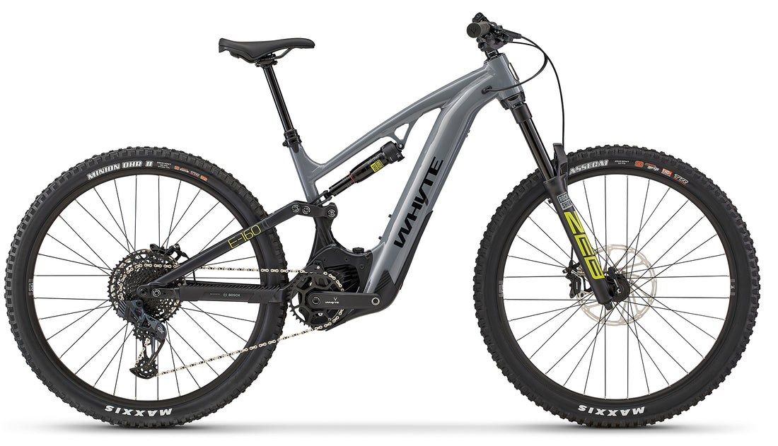

Alloy 29er trail/enduro eMTB with Bosch CX motor (750Wh)
Travel F/R
160/155mm
Wheels
29F/29R
Frame
Aluminium
Weight
27 kg
Price
£5,499

The Whyte E-160 2024 is the British brand's aluminium enduro flagship and one of the most popular UK-engineered eMTBs of the late 2010s/early 2020s. Headline numbers: 160mm fork, 155mm rear, Bosch Performance Line CX Gen 4 at 85Nm and 600W peak with a 2.9kg motor mass (with PU2.0 firmware path to 120Nm Gen 5 mapping where compatible), a removable 750Wh Bosch PowerTube battery, 27.0kg claimed, 64.8 degree head angle and reach 455 to 510mm across M, L and XL. Priced from GBP 5,499 base. Production status is discontinued: Whyte has since pivoted to the carbon ELyte 150 platform. The E-160 remains widely available on the used market and represents one of the best-value used Bosch CX enduro tools in the UK.
Drive system and range. The Bosch Performance Line CX Gen 4 shipped at 85Nm and 600W peak. Where the bike has received Bosch's PU2.0 firmware update path it lifts to 120Nm at the wheel and 750W peak (the Gen 5 mapping). The 750Wh PowerTube battery is removable through the downtube. Real-world range on 750Wh on a 27kg alloy enduro sits at two to three hours of mixed alpine riding. @Ark notes some owners have flashed Bosch firmware for derestricted speed (180 euros, USB cable + WhatsApp service) but warns workarounds become incompatible when new firmware versions release and manual phone updates revert to UK speed limits.
Geometry and handling. 64.8 degrees up front in the stock setting, adjustable via the Shape.It Link flip-chip (high/low) for 0.6 degree HA / 8mm BB drop. Reach steps cleanly: 455 (M), 483 (L), 510 (XL). Chainstays are a uniform 446mm and wheelbase tops out at 1300mm on XL. The E-160 ships in full 29er or mullet from factory depending on rear link fitted, and @Plummet confirms BB height is 347mm with mullet-to-29er conversion steepening the head angle by 0.5 degrees in high position.
Build and value. One base trim at GBP 5,499 / 27.0kg. Spec: RockShox ZEB 160mm fork (44mm offset, DebonAir, Rush RC damper), RockShox Deluxe Select R shock, SRAM Guide RE four-piston brakes and SRAM GX Eagle AXS. @mooby77 reports purchasing an E-160-RS-MX Mullet 2023 for GBP 4,700 with common mods including KYDEX bash plate extender, Bosch Mini Remote repositioning via Flow App and frame protection. Standout: SRAM GX Eagle AXS at the base trim. Questionable: 27.0kg is heavy by 2025 standards; pedal strike issues are widely reported.

Frame
6061 alloy, hydroformed T6 aluminium, multi-butted, custom drawn, tapered headtube with Shape.it Link flip-chip (high/low geometry adjustment, 0.6deg HA / 8mm BB drop), 12x148mm Boost dropouts, 155mm rear travel, 29er wheels (M-XL) or 27.5" (XS-S)

E-160 S
£5,499
MotorBosch Performance Line CX Gen 4 · 85 Nm
BatteryBosch PowerTube 750 · 750 Wh
Travel F/R160/155 mm
FrameAluminium (6061 Hydroformed T6 multi-butted)
ForkRockShox ZEB 160mm 44mm offset DebonAir
ShockRockShox Deluxe Select R, Fast Black coating
HeadsetFSA No. 55R/35 Orbit 1.5 ZS, 1.8" Lower and 1 1/8" Upper Sealed Cartridge Bearings
StemWhyte Enduro Stem, 35mm Bar Bore, 35mm Extension
HandlebarWhyte Custom 6061 Alloy, 30mm Rise, 35mm Bar Bore, 780mm Wide
GripsWhyte Lock-on Enduro Grip
SaddleWhyte Custom, Dual Density, Triple Panel Design
SeatpostWhyte drop.it Adjust, 30.9mm, M/L 140-170mm Travel, XL 170-200mm Travel, MMX Paddle Remote Lever
BrakesSRAM Guide RE 4-piston, 220mm front / 200mm rear
Rear derailleurSRAM GX AXS Eagle, 12 Speed
CrankWhyte, Forged Alloy, 165mm, direct mount 36T
ShiftersSRAM GX AXS Eagle, 2 Button, MMX, 12 Speed
CassetteSRAM PG1210, 11-50, 12 Speed
ChainSRAM GX Eagle, 12 Speed
DrivetrainSRAM GX AXS Eagle 12-speed; Whyte forged alloy crankset 165mm
WheelsWTB HTZ i30 TCS 2.0, 32H, tubeless ready
TyresMaxxis Assegai WT 2.5in front / Minion DHR II 2.4in rear
Weight27 kg
