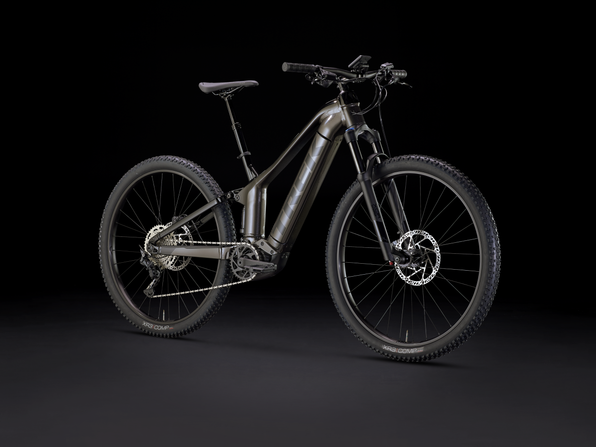

The Trek Powerfly FS was Trek's full-suspension full-power trail eMTB, sitting one step up from the hardtail Powerfly. The Alpha Platinum aluminium frame runs 120mm up front and 100mm of rear travel through Trek's ABP rocker-link suspension, a comparatively short-travel setup aimed at cross-country and flowing trail riding rather than aggressive enduro work. Trek's Smart Wheel Sizing fits 29in wheels on M/L/XL and 27.5in on XS/S, with a 66.5 degree head angle and 76 degree effective seat angle across the range.
Power came from the Bosch Performance Line CX (Gen 4) motor rated at 85 Nm. The FS 4 Gen 3 and FS 9 Equipped Gen 3 ran Bosch's Smart System electronics, while the carryover FS 4 Gen 2 used the earlier Bosch CX with a Purion display. Batteries were the Bosch PowerTube 500Wh on the FS 4 builds and the larger 625Wh on the FS 9 Equipped. All packs use Trek's tool-free Removable Integrated Battery (RIB) system.
The 2024 lineup spanned the value-focused FS 4 (Shimano Deore 10-speed, SR Suntour fork and shock, Tektro brakes) up to the FS 9 Equipped, which added a wireless SRAM GX Eagle AXS drivetrain, RockShox SID Lux shock, SRAM G2 RS 4-piston brakes plus a rack, lights, kickstand and fenders for commuting duty on the same trail frame.
The Powerfly FS has since been discontinued and replaced by the current Bosch Smart System Gen 5 Powerfly FS+ generation. There is no forum owner data attached to this entry.
