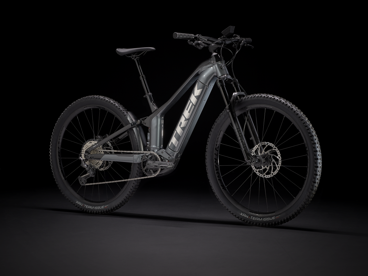

Powerfly FS 2023
DiscontinuedFull Power · Cross-CountryLegacy · 1/10iFreshness 1/10
Comfort-oriented short-travel full-suspension trail bike for easy singletrack
Travel F/R
120/100mm
Wheels
29F / 29R
Frame
Aluminium
Weight
24.37 kg
Price
From £4,250

EMTB Forums verdict
The 2023 Trek Powerfly FS is the do-everything aluminium full-susser of the range: 120mm up front, 100mm out back on Trek's ABP linkage, Bosch Performance Line CX (85 Nm) and a removable 625Wh PowerTube on all but the entry FS 4 500 (500Wh). It is a trail/trekking bike rather than an enduro weapon, with a sensible 66.5deg head angle, 76deg effective seat angle and a tidy 470mm chainstay. Note the mullet-by-size approach: XS and S roll on 27.5in wheels with a 100mm fork, while M, L and XL get 29in wheels and the full 120mm.
Trims run from the workmanlike FS 4 500/625 (Suntour XCR 34 fork, Tektro brakes, 10-speed Deore) up through the FS 4 Equipped commuter build (mudguards, rack, lights, LT4 tyres) to the FS 7 (RockShox 35 Gold RL, SIDLuxe shock, 12-speed SLX/XT) and the range-topping FS 9 Equipped with full XT. Weights are honest at roughly 24-25kg for the trail builds and 27kg for the Equipped models. Geometry is consistent and well-mannered across all five sizes. Discontinued and superseded by the Gen 3/Gen 4 Powerfly FS+, but a solid, reliable used buy if you want Bosch full-power assistance without enduro pretensions.
