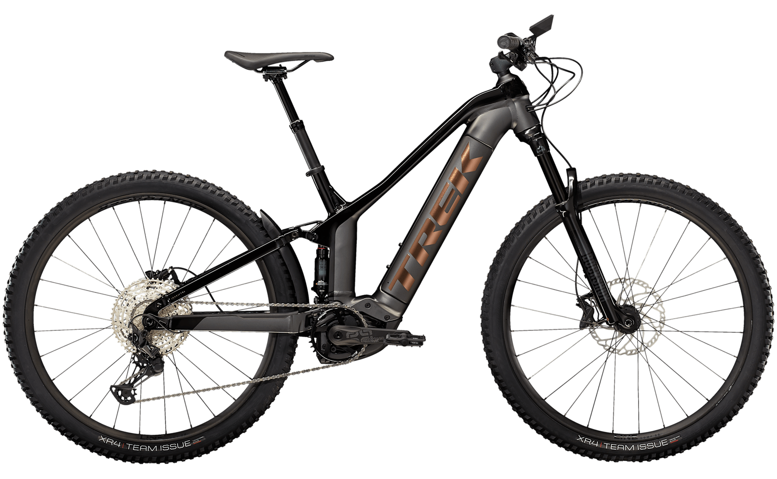

Trek Powerfly FS 2022
From £4,250
EMTB Forums verdict
The 2022 Powerfly FS was Trek's aluminium full-suspension trail e-MTB, on the second-generation (Gen 2) Alpha Platinum frame introduced for MY2021: 100 mm of ABP four-bar rear travel with a magnesium rocker link, a 100-120 mm fork depending on size and trim, Trek's tool-free Removable Integrated Battery (RIB), Motor Armor protection, and a Bosch Performance CX Gen 4 motor (85 Nm, 25 km/h assist). Unlike the old-school Powerfly hardtail it shared showroom space with, the FS got genuinely modern geometry: a 66.5 degree head angle, 76 degree effective seat angle and 430-485 mm reach across M to XL, with 27.5in wheels on XS/S and 29in wheels on M/L/XL. Every trim shipped with a dropper post.
Four trims were sold in the UK. The FS 4 500 (GBP 4,250) and FS 4 625 (GBP 4,550) are identical Suntour XCR 34 / Edge R, 10-speed Deore, Tektro-braked builds separated only by battery size (500 Wh vs 625 Wh). The FS 7 (GBP 5,700) steps up to a RockShox 35 Gold RL fork and SID Lux Select+ shock, a 12-speed Shimano SLX/XT drivetrain, four-piston brakes, tubeless-ready Line Comp 30 wheels, XR4 Team Issue tyres and a Bosch Kiox display at a claimed 24.37 kg.
The FS 9 Equipped (GBP 6,700; USD 6,249.99 in the US, where it was badged NEW for 2022 alongside a base FS 4 at USD 4,749.99) is the do-everything commuter flagship: full Shimano XT M8100 drivetrain and XT M8120 brakes, Bontrager Line dropper, Bosch SmartphoneHub, plus factory-fitted Supernova lights, a MIK rear rack, mudguards and a kickstand, at a heavier 27.05 kg.
All trims share one frame and one published geometry table, a 625 Wh battery on everything above the base build, and a 136 kg total weight limit. This generation is discontinued: Trek carried the same Gen 2 FS bikes into the 2023 catalogue (adding an FS 4 Equipped), and the value case today is on the used market, where the shared frame means trim differences come down to battery size, suspension and drivetrain rather than handling.

Bike geometry diagram
XSSMLXL
Reach405 mm415 mm430 mm460 mm485 mm
Stack599 mm599 mm637 mm646 mm646 mm
Seattube368 mm395 mm420 mm450 mm500 mm
Chainstay468 mm468 mm470 mm470 mm470 mm
Headtube Angle66.5°66.5°66.5°66.5°66.5°
Seattube Angle (eff)76°76°76°76°76°
Wheelbase1170 mm1180 mm1206 mm1240 mm1265 mm
Headtube140 mm140 mm130 mm140 mm140 mm
BB Height332 mm332 mm335 mm335 mm335 mm
Standover691 mm691 mm712 mm716 mm713 mm
Front Centre702 mm*712 mm*736 mm*770 mm*795 mm*
FC:RC1.501.521.571.641.69
