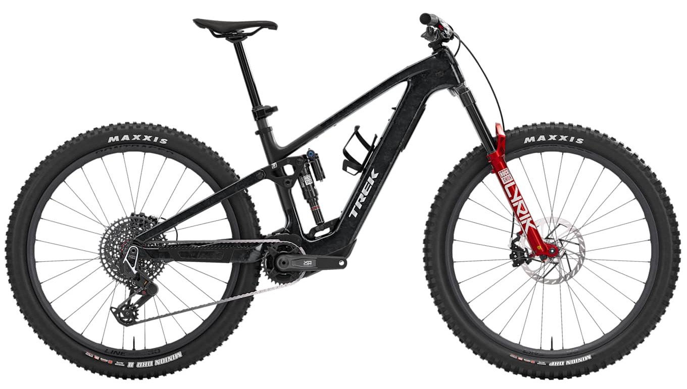

EMTB Forums verdict
The Trek Fuel+ EX 9.9 X0 AXS 2026 is the US brand's halo lightweight trail eMTB: a carbon ABP chassis with 150 mm of fork travel paired with 145 mm of rear, the TQ HPR60 motor at 60 Nm of torque and 350 W peak, and a removable 580 Wh TQ HPR battery. At a claimed 19.4 kg and £10,300 top-trim price, this is a serious technical contender that has rapidly built a strong forum following. With a 64.5 degree head angle and size-progressive chainstays growing 437 mm to 452 mm across five sizes (15.5"–23"), the Fuel+ EX brings Trek's class-leading Ride Aligned geometry approach to the mid-power class.
Drive system and range. The TQ HPR60 is the headline upgrade over the previous HPR50: 60 Nm of torque (vs HPR50's 50 Nm), 350 W peak and a class-leading 1.924 kg motor weight. @coregrind ran a Fuel+ EX 9.7 (HPR60) alongside a friend on a Fuel EXe (HPR50, dual 360 Wh batteries, friend 4 kg lighter) on the same trail; the Fuel+ finished with 22% battery remaining vs the friend's 12% — using 40% less battery. Strong evidence the HPR60 + 580 Wh package is a meaningful efficiency step. @Keef reports 30 miles with 4,200 ft of climbing at 90% highest power level left 13% battery — genuinely impressive real-world range for an SL-class bike. @Keef also describes the motor as "silent except when pushed hard on climbs, power delivery natural with high cadence requirement."
Geometry and handling. A 64.5 degree head angle is bang in the modern trail-all-mountain sweet spot. Reach progression is generous: 431 mm (15.5"), 460 mm (17.5"), 485 mm (19.5"), 510 mm (21.5"), 530 mm (23"). Chainstays are size-progressive: 437 mm (15.5"–17.5"), 442 mm (19.5"), 447 mm (21.5"), 452 mm (23") — Trek's Ride Aligned size-balanced rear-centre system delivers genuine geometric proportionality. Wheelbase grows 1,187 mm to 1,330 mm. Five sizes is class-competitive. The ABP (Active Braking Pivot) suspension is Trek's proven layout.
Build and value. Seven trims sit on the Fuel+ EX platform. The £4,400 5 is the alloy entry. The £10,300 9.9 X0 AXS base trim at 19.4 kg is the carbon flagship — RockShox Lyrik Ultimate fork (European pricing €11,499 per @Victorius). Between sits a strong value mid-range with £5,000–£8,000 trims. @Roaming50 on a 2026 9.7 describes the SRAM Eagle 70 transmission as "a revelation."
Community-verified strengths. Forum reception has been notably positive. @Battman85 "knew I had to have it" from launch and has documented his ownership in detail. @nickf, a former full-power Bosch Gen 4 Trek Rail owner, describes the Fuel+ feel: "gives enough support without destroying the natural sensation of pedalling with human leg effort" — a strong endorsement from someone explicitly cross-shopping the latest full-power bikes. @Yobbo has 320 miles in 8 weeks with no failures beyond an XT cassette gear-crashing issue (fixed by cassette change). The HPR60/580 Wh real-world range data from @Keef and @coregrind is the strongest single piece of forum evidence in favour of this platform.
Caveats and known gripes. Drivetrain creak has emerged as the family weakness. @Yobbo at 550 miles (880 km) developed exactly the same loud drivetrain creak the Fuel EXe predecessor had a reputation for. Stock XT cassette gear-crashing was an issue per the same rider, fixed by cassette replacement. @1234 notes the "Fuel+" naming scheme is poor for SEO and confusing for buyers. @Roaming50 reports the 9.7 is available in USA without September waitlist, but warns the LX 9.9 model has supply constraints. The 60 Nm motor is meaningfully less powerful than 120 Nm Bosch CX Gen 5 alternatives at similar money. The 580 Wh battery is more generous than 320–420 Wh competitors but smaller than 800 Wh full-power systems. @nickf wins the "balance" argument honestly — the Avinox 1000+ W feel is more dramatic than the TQ HPR60's natural assistance.
Verdict. The Trek Fuel+ EX 9.9 X0 AXS is one of the most credible lightweight trail eMTB platforms of 2026: TQ HPR60 power with a 580 Wh removable battery, Ride Aligned size-progressive geometry across five sizes, and a strong forum reception centred on genuine real-world efficiency data. It will suit riders who want the lighter, more natural ride feel of an SL-class motor with meaningful big-day range, and who value Trek's UK dealer network and Ride Aligned engineering. Buyers wanting maximum motor torque, a full 800 Wh battery, or the strongest possible spec-per-pound value should look at the Cube One77 SLX, Centurion No Pogo R5000 or Trek Rail+ Gen 5 alternatives. Production status: current.
