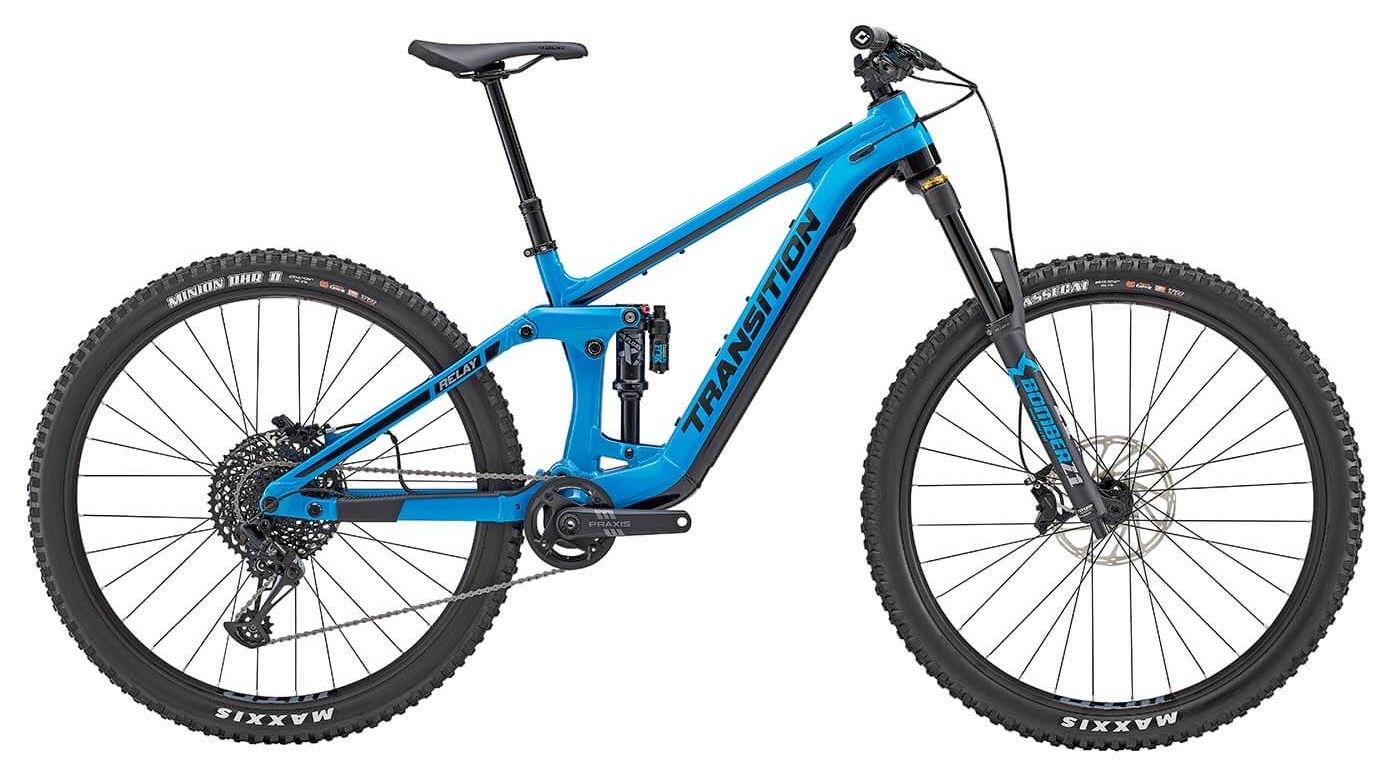

Transition Relay 2024
From £6,999
EMTB Forums verdict
The Transition Relay was the Bellingham brand's lightweight, modular trail and enduro eMTB, built around the Fazua Ride 60 mid-power motor (60Nm, 250W continuous, 450W peak) and a removable 430Wh Fazua Energy battery. Transition pitched it as 'two bikes in one': ride it powered, or pop the battery out tool-free through the down-tube door for a near-analogue long-travel mountain bike. The Ride 60 unit weighs under 2kg and produces very little drag, so unpowered riding feels close to a normal bike.
One frame, two factory configurations. As the standard Relay it runs dual 29in wheels with 160mm of travel front and rear; as the Relay PNW it runs a mixed 29F/27.5R wheel setup with 170mm front and rear. A lower-shock-mount flip chip sets the geometry to suit the rear wheel size. The numbers are aggressive for a light eMTB: a 64 degree head angle in 160mm Relay trim slackening to 63.3-63.6 degrees in 170mm PNW trim, with reach from 410mm (XS) to 535mm (XXL) and chainstays of 436-448mm. The GiddyUp suspension offers around 26 percent progression and works with both air and coil shocks.
Six builds were offered. Two alloy: the Relay Alloy NX (Marzocchi Z1 Air, SRAM Code R, SRAM NX) and the Relay PNW Alloy GX (Fox 38 Performance Elite, Fox DHX coil, TRP DH-R EVO, SRAM GX). Four carbon: Carbon GX Mechanical, Carbon GX AXS (SRAM GX AXS Transmission), the 170mm PNW Carbon XO AXS (Fox 38 Grip2 Factory, coil, SRAM XO Transmission) and the flagship Carbon XX AXS (Fox 36 Grip2 Factory, Fox Float X Factory, SRAM XX Transmission, Crankbrothers Synthesis carbon wheels). Claimed weights ran from a feathery 19.14kg for the XX AXS to 22.63kg for the coil-equipped PNW Alloy GX, all measured in size MD with the battery fitted.
The Relay has since been discontinued and superseded by the updated Relay generation, with the 2024 builds appearing on clearance. There is no community forum history bundled with this dossier, so no owner reliability or long-term ride data is asserted here.
