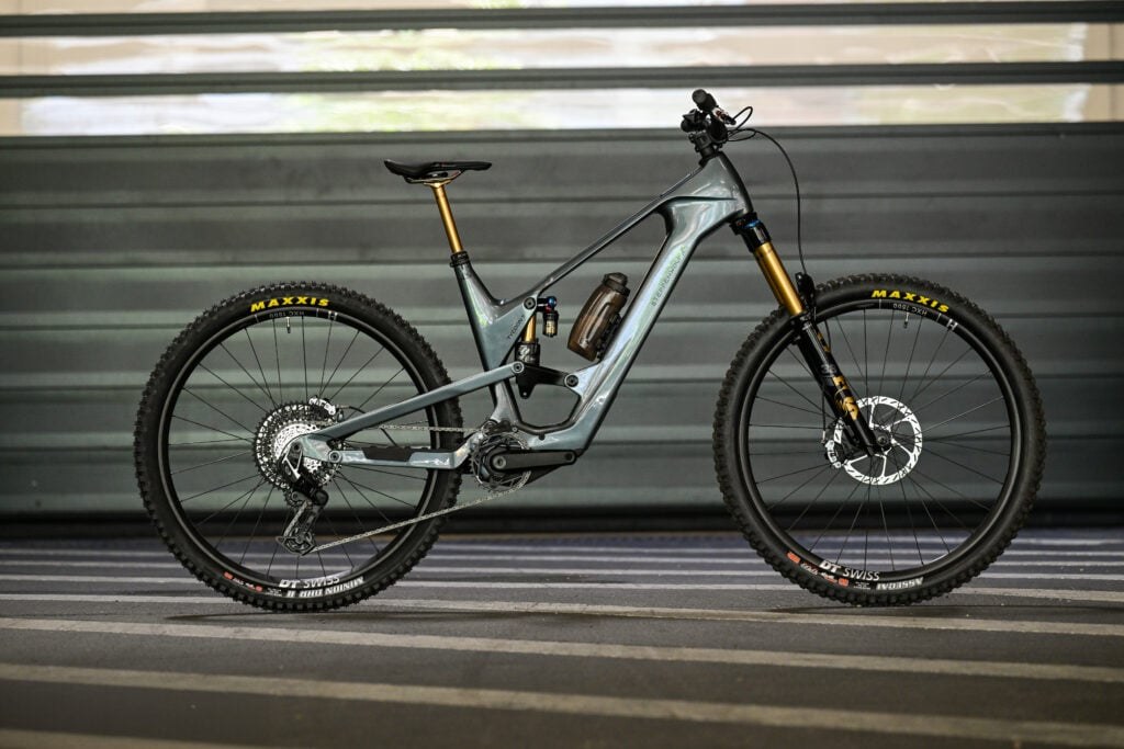

Carbon enduro built around the potent Avinox full-power motor
Motor
Avinox M2S · 150Nm · 1300W
Battery
Avinox FP800 · 800Wh
Travel F/R
170/170mm
Wheels
29F / 29R
Frame
Full carbon

The Tycoon is Steppenwolf's new carbon enduro, revealed at Eurobike 2026 and reviving a model name from the Bavarian brand's 30 year history. It pairs a 170/170 mm carbon chassis with the full-power Avinox M2S system and an 800 Wh battery in the down tube, rolling exclusively on 29 inch wheels. The four-bar rear end mounts the shock diagonally between seat tube and top tube, driven by a lower link, yet still leaves room for a bottle inside the front triangle.
Geometry is described as balanced rather than extreme. There is no small size, the range starting at Medium with 450 mm of reach and topping out at XL with 488 mm. A 64 degree head angle, 78 degree effective seat angle and a 450 mm chainstay across all three sizes sit alongside notably tall stack figures, giving STR ratios from 1.44 down to 1.37.
Two builds are planned. The Tycoon 11 at 9,999 euro runs Fox Factory suspension, DT Swiss HXC 1500 hybrid-carbon wheels, a SRAM X0 Transmission drivetrain and SRAM Maven Ultimate brakes. The Tycoon 10 at 7,999 euro swaps to a RockShox Zeb Ultimate fork and Vivid Air shock with SRAM GX Transmission and Maven Bronze brakes. Steppenwolf remains a dealer-only brand, with availability quoted as end of 2026 and described as not yet fully fixed.

MotorAvinox M2S · 150 Nm · all trims
BatteryAvinox FP800 · 800 Wh · all trims
Travel F/R170/170 mm · all trims
FrameCarbon · all trims
ForkRockShox Zeb UltimateFox Factory (Kashima)
ShockRockShox Vivid AirFox Factory (Kashima)
BrakesSRAM Maven BronzeSRAM Maven Ultimate
Rear derailleurSRAM GX TransmissionSRAM X0 Transmission
ShiftersSRAM GX Transmission (electronic)SRAM X0 Transmission (electronic)
DrivetrainSRAM GX Transmission; SRAM GX Transmission (electronic)SRAM X0 Transmission; SRAM X0 Transmission (electronic)
WheelsDT Swiss HXC 1500 hybrid-carbon wheels
TyresMaxxis (per hero image: Maxxis front and rear, 29in)
