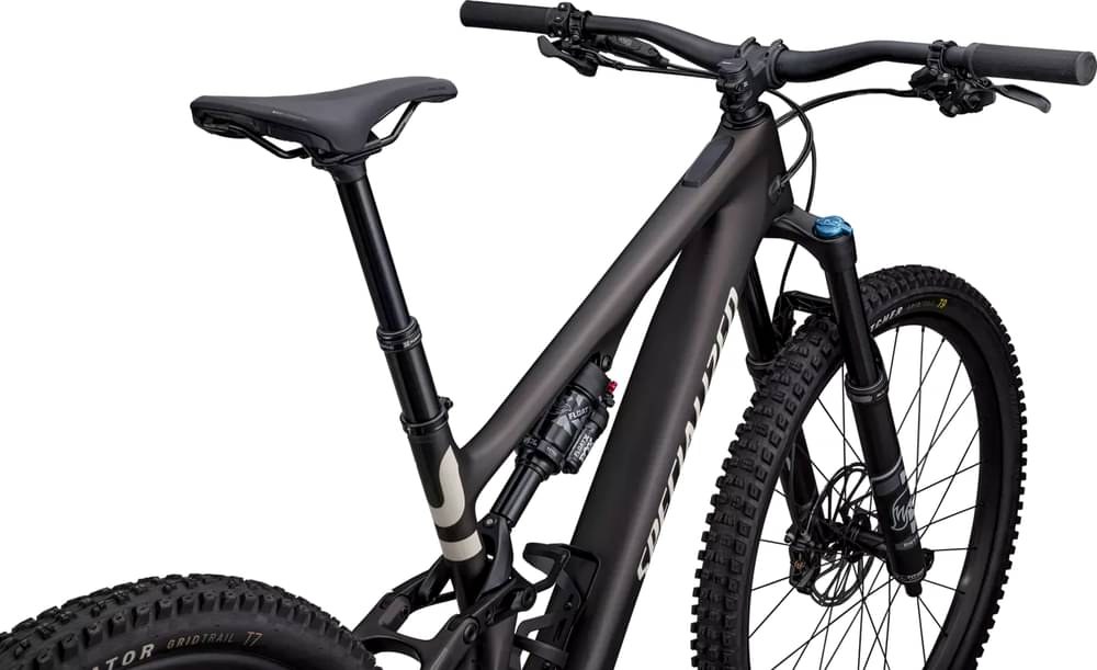

The 2023 Turbo Levo SL was Specialized's second-generation lightweight trail eMTB and a clean-sheet redesign of the original sidearm-framed SL. The FACT 11m carbon frame carries the new Specialized SL 1.2 motor (50 Nm and 320 watts, roughly a third more power and around 40 per cent more torque than the old SL 1.1) plus a fully integrated 320Wh battery, with an optional 160Wh range extender that drops into the bottle cage for 480Wh total. Travel grew to 160mm up front and 150mm at the rear (150/144mm on the smallest S1), running mixed 29in front and 27.5in rear wheels across Specialized's S1 to S6 sizing.
Geometry is firmly trail-to-light-enduro: a 64.6-degree head angle, 75.8-degree effective seat angle, short 432mm chainstays on S2 upwards and an adjustable head angle and bottom-bracket height via a flip-chip. The range spanned the SRAM GX Eagle Comp Carbon at GBP 7,000, the GX AXS Transmission Expert Carbon at GBP 9,000, the X0 Transmission and Fox Factory Pro Carbon at GBP 10,250, and the XX Transmission, Reverb AXS and Roval carbon-wheeled S-Works at GBP 13,700, with claimed weights from about 17.8kg on the S-Works to 18.8kg on the Comp Carbon.
For its era this was one of the more capable lightweight assist bikes, trading outright power for a quiet, natural-feeling drive and genuine trail-bike handling. It has since been discontinued and superseded by later Levo SL generations, so any examples now are end-of-line or used stock.
