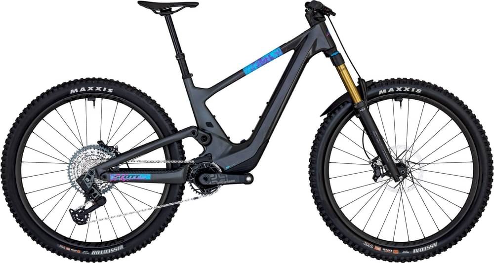

The 2024 Voltage eRIDE was Scott's first dedicated lightweight trail e-MTB, pairing a Genius-derived carbon chassis with the compact TQ HPR50 mid-motor (50Nm) and a 360Wh internal battery. With 160mm up front and 155mm out back, a 63.9 degree slack head angle and 455mm chainstays across all sizes, it sat closer to all-mountain than the cross-country Lumen, trading outright range for a quiet, natural ride feel.
The line spanned six builds: the flagship 900 SL (FOX 36 Factory, SRAM XX AXS, included 160Wh range extender) and 900 Tuned (FOX 36 Grip 2, FLOAT X NUDE shock, SRAM GX AXS) at the top, the 910 and 920 on Shimano and SRAM mechanical kit, plus two women's Contessa versions in S/M/L. Notably the 920 and Contessa 910 ran a 150mm Marzocchi Z2 fork rather than the 160mm FOX of the rest.

⚙️ Adjustable geometry: this frame has a high/low setting — low drops the BB and slackens the head angle for more descending stability; high lifts the BB and steepens slightly for clearance and a perkier, more playful feel.
Bike geometry diagram
SMLXL
Reach437 mm457 mm485 mm513 mm
Stack622 mm622 mm631 mm640 mm
Seattube405 mm425 mm450 mm480 mm
Chainstay455 mm455 mm455 mm455 mm
Headtube Angle63.9°63.9°63.9°63.9°
Seattube Angle (eff)77.1°77.1°77.1°77.1°
Wheelbase1233 mm1253 mm1285 mm1317 mm
Headtube110 mm110 mm120 mm130 mm
BB Height350 mm350 mm350 mm350 mm
Standover765 mm765 mm772 mm788 mm
Front Centre778 mm*798 mm*830 mm*862 mm*
FC:RC1.711.751.821.89
