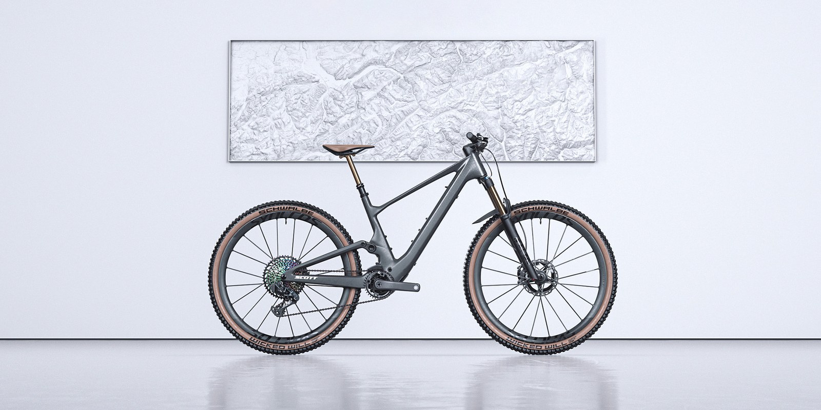

Scott Lumen 2023
From £6,499
EMTB Forums verdict
The Scott Lumen eRIDE arrived in mid-2022 as a model-year 2023 bike and was Scott's first lightweight trail eMTB. The HMX carbon frame hides a TQ HPR50 motor (50 Nm) and a 360Wh internal battery, with a 160Wh range extender as an option, and runs 130mm of travel front and rear on 29in wheels. The rear shock is buried inside the frame and driven by a flex-stay link, controlled by Scott's TwinLoc remote for on-the-fly lockout. A 65.5-degree head angle (plus or minus 0.6 degrees via the adjustable headset) and 450mm chainstays across all sizes give it a stable trail rather than racy XC stance.
The range ran from the flagship 900 SL (FOX Factory 34, SRAM XX1 AXS, Syncros Silverton carbon wheels, Shimano XTR brakes, around 15.5kg) down through the SRAM GX AXS-equipped 900, the Shimano-built 910 (FOX 34 Rhythm, Deore brakes with an XT rear mech, Syncros X-30SE wheels) and the women's Contessa 900, which shared the 910's Deore/XT build with a women's saddle and S to L sizing. UK pricing spanned roughly £6,499 for the 910 and Contessa to £13,699 for the 900 SL.
For its era it was one of the lightest and most discreet assisted trail bikes on the market, leaning on a near-silent TQ drive and a genuine analogue feel rather than outright power. It has since been discontinued and replaced by a later-generation Lumen, so any examples now are end-of-line or used stock.
