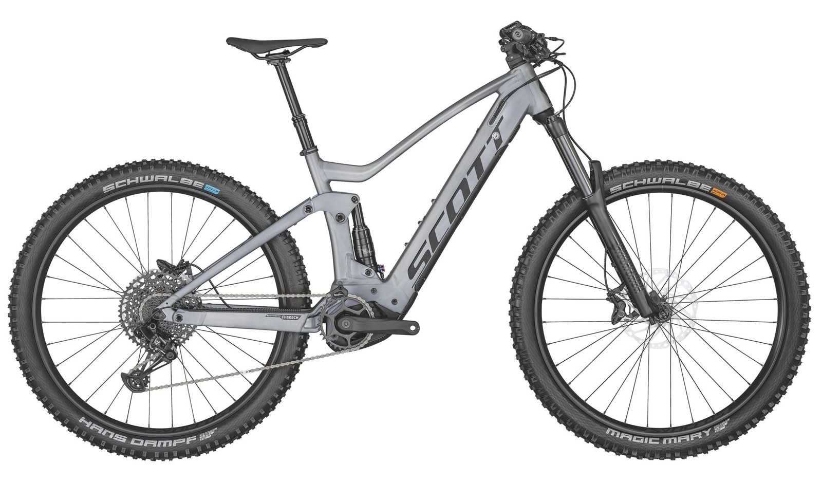

Scott Genius eRIDE
Scott
Genius eRIDE 2022
DiscontinuedFull Power · TrailLegacy · 1/10iFreshness 1/10
Adjustable all-mountain bike with TwinLoc remote and full Bosch power
Travel F/R
160/150mm
Wheels
29F / 29R
Frame
Aluminium / Carbon front, aluminium rear
Weight
23.4 kg
Price
From £4,599
View the Scott Genius eRIDE on Scott’s site
Scott Genius eRIDE 2022
From £4,599
EMTB Forums verdict
The 2022 Genius eRIDE was the final full catalogue year before the runout of Scott's first-generation full-power Genius eRIDE, a 160/150mm 29er built around the Bosch Performance Line CX Gen 4 motor and a removable 625Wh PowerTube battery. The range ran to three trims: the carbon-fronted 910 at £5,699 and the alloy 920 and 930 at £4,999 and £4,599.
All three shared the Virtual 4-Link rear end with Scott's TwinLoc remote, switching fork and shock between Lockout, Trail (Traction Control on the 930) and Descend modes, plus a flip chip in the upper shock mount for High and Low geometry. Reach was moderate for the era at 440.6mm in a size M (Low setting) with long 465mm chainstays.
The 920 was the value pick, pairing a Shimano XT rear derailleur and 10-51T cassette with the same FOX 36 Rhythm and Float DPS suspension as the 910, while the 930 made do with a RockShox 35 Silver fork and X-Fusion NUDE shock. The platform was discontinued after a 2023 runout, with the Patron eRIDE taking over Scott's full-power eMTB slot.
