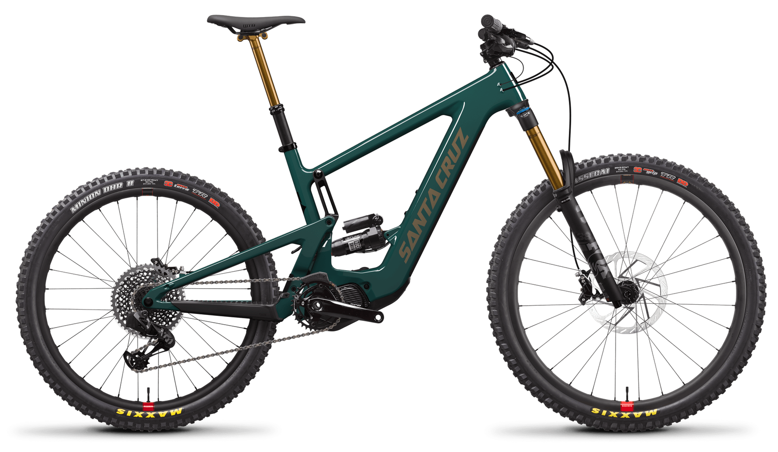

Santa Cruz Bullit 2023
From £7,499
EMTB Forums verdict
The 2023 Santa Cruz Bullit is the brand's full-power, mixed-wheel (29in front, 27.5in rear) carbon enduro eMTB. Every UK build runs the same Carbon CC frame, a lower-link VPP layout with 170mm of travel front and rear, the Shimano STEPS EP8 (DU-EP800) drive unit and a 630Wh battery. The frame takes a 170mm 38mm-chassis fork and a 230x62.5mm shock, and rolls on four sizes (M, L, XL, XXL) sharing a slack 64-degree head angle and a 449mm chainstay across the range.
The UK range ran six builds. The R (£7,499) is the value entry with a RockShox Zeb fork, SRAM NX Eagle and SRAM Guide RE brakes. The S (£8,699) steps up to a Fox 38 Float Performance fork, SRAM GX Eagle and Code R brakes. The XT and XT Coil (£9,499 each) pair a Fox 38 Performance Elite with a full Shimano XT M8100 groupset and 203mm Ice Tech rotors, the Coil swapping in a RockShox Super Deluxe Coil shock. The flagship X01 AXS RSV and X01 AXS RSV Coil (£11,699 each) add a Fox 38 Factory fork, SRAM X01 Eagle AXS wireless shifting, Code RSC brakes and Reserve carbon wheels.
Geometry is firmly enduro: a 64-degree head angle, 450mm reach in M growing to 515mm in XXL, and a low 348mm bottom bracket. It is a heavy, gravity-focused bike rather than a lightweight, so the EP8 motor and 630Wh battery are doing real work on the climbs. This model year is discontinued, having since been replaced by a later Bullit generation.
