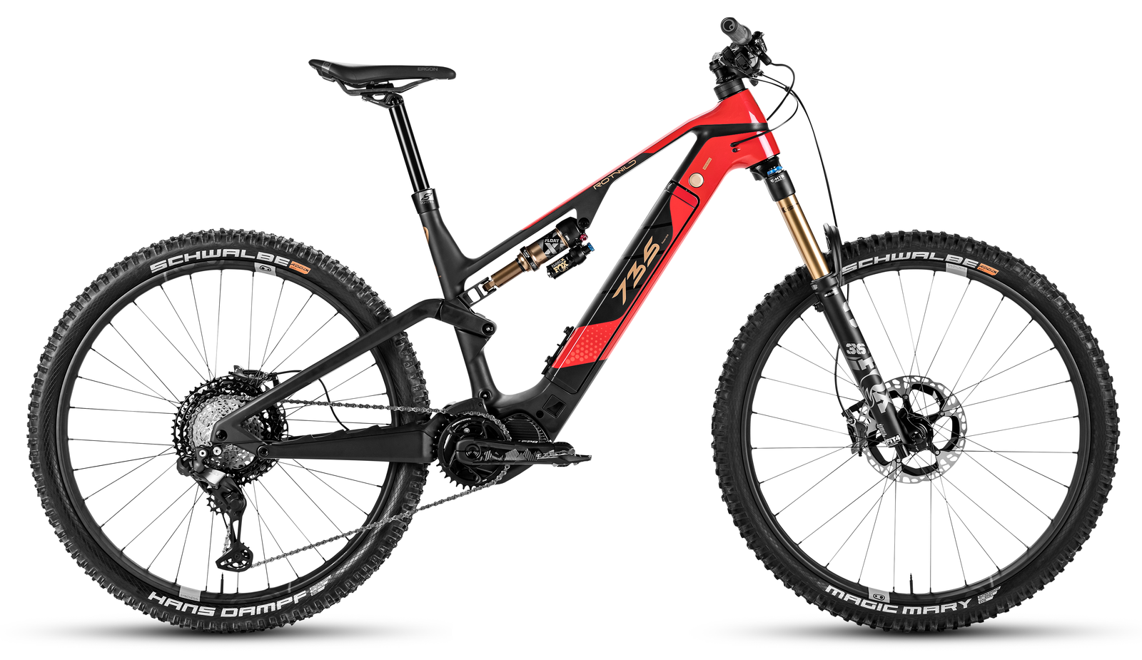

Rotwild R.X735 2024
EMTB Forums verdict
The 2024 Rotwild R.X735 was the German brand's versatile All Mountain full-power eMTB, built on the handmade high-modulus carbon IPU735 platform with 150mm of fork travel and 144mm at the rear on 29in wheels. It paired a Shimano EP801 motor (85Nm, 600W) with a quick-release 720Wh ROTWILD IPU735 carbon-cased battery, yet kept weight remarkably low for a big-battery full-power bike at around 21.2kg for the ULTRA.
Geometry is more all-rounder than outright enduro bruiser: a 67 degree head angle, 75 degree seat angle, a consistent 450mm chainstay and a low 345mm bottom bracket, with reach growing from 430mm on the S to 500mm on the XL across four sizes. The wheelbase stays compact (1,200mm to 1,282mm), which Rotwild positioned as a bike that climbs efficiently yet stays composed on technical descents rather than a slack gravity sled.
The 2024 range ran three carbon trims off one frame. The CORE used a Fox 36 Performance fork, mechanical Shimano XT 8100, Magura MT5 brakes and Crankbrothers Synthesis Enduro wheels; the PRO stepped up to a Fox 36 Performance Elite, Shimano XT Di2 electronic shifting and XT 8120 brakes; and the flagship ULTRA ran Fox Factory Kashima suspension, XT Di2 with an XTR cassette, Shimano XTR brakes and a full carbon e*thirteen Race Carbon cockpit on Crankbrothers Synthesis Enduro I9 wheels. All three shared the EP801 motor, the EM800 display, an 8Pins integrated dropper and Schwalbe Magic Mary / Hans Dampf tyres.
This generation has since been discontinued and superseded by the current R.X735, with Rotwild clearing the original 2024 stock at reduced prices. Prices listed here are the original 2024 EUR RRP. Rotwild is a German brand with no native GBP pricing, so price_gbp is left null per the no-FX-convert rule.

Weight21.2 kg1.8 kg lighter than average
Battery720 Whabout average capacity
Motor torque85 Nm13 Nm below average
⚙️ Adjustable geometry: this frame has a high/low setting — low drops the BB and slackens the head angle for more descending stability; high lifts the BB and steepens slightly for clearance and a perkier, more playful feel.
