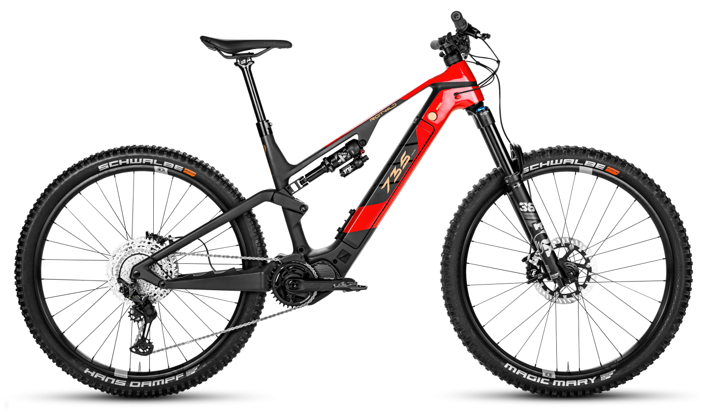

Rotwild R.X735 2022
EMTB Forums verdict
The 2022 Rotwild R.X735 is the German brand's all-mountain eMTB, a handmade high-modulus full-carbon 29er with a 150mm fork and 144mm of rear travel. It is built around the Shimano EP8 motor and Rotwild's own IPU735 pack, a 720Wh carbon-housed battery weighing 3.6kg that pops out of the down tube one-handed via a push-button quick release.
Three trims shared the frame and battery. The Core (7,999 euros) ran a Fox 36 and Float X Performance, Shimano XT shifting and Magura MT5 HC-W brakes; the Pro (9,499 euros) upgraded to Shimano XT four-piston brakes, a carbon bar, Eightpins H01 dropper and Industry Nine-hubbed Crankbrothers wheels; the Ultra (12,499 euros) topped out with Fox Factory Kashima suspension, a full XTR groupset, carbon wheels and e*thirteen Race Carbon cranks. All three rolled on Schwalbe Magic Mary and Hans Dampf rubber with 203mm rotors.
Geometry was moderate rather than radical: a 65.5 degree head angle, 75 degree seat angle and 430mm to 500mm of reach across S to XL, with long 450mm chainstays on every size for a planted, stable character. Maximum tyre clearance is 29x2.6 at both ends.
This model year is discontinued; the R.X735 continued into 2023 with the same IPU735 platform before later giving way to Rotwild's next-generation e-bike range.
