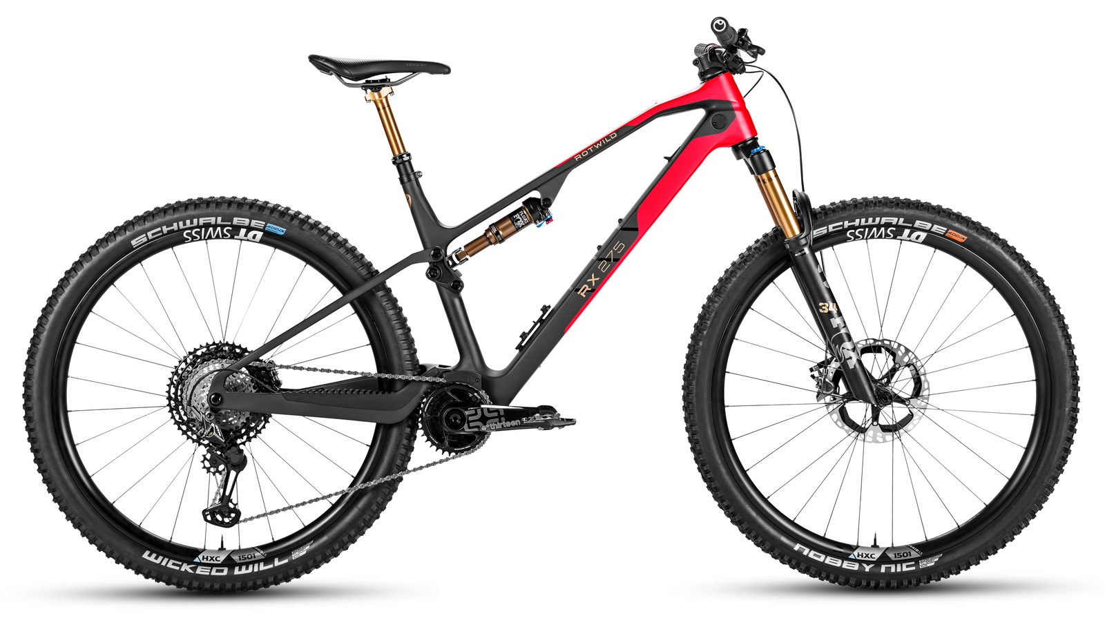

Rotwild R.X275 2023
EMTB Forums verdict
The 2023 Rotwild R.X275 was the German marque's first lightweight trail e-MTB, and at the time one of the lightest production full-suspension e-bikes available, with the Ultra claimed at 15.3 kg in size M. The full High Modulus carbon frame uses a flex-stay rear end (no rear pivot) to shed weight, paired with 130 mm up front and 120 mm out back on 29in wheels. The drive is a TQ HPR50 (up to 50 Nm) fed by a fully integrated 250 Wh IPU pack, with a handlebar Boost Button that lifts output from a 200 W cap to 300 W for up to 30 seconds.
Two trims were offered, both in the RED MATT colourway. The Pro at 9,499 EUR runs Fox Performance Elite suspension and a Shimano XT 12-speed drivetrain with XT four-piston brakes. The Ultra at 12,499 EUR steps up to Fox Factory Kashima, full Shimano XTR, DT Swiss carbon wheels, a one-piece ROTWILD RIC280 carbon cockpit and a carbon e*thirteen chainset, justifying the considerable premium for buyers chasing the lowest weight.
Geometry is restrained and trail-oriented rather than slack: a 66 degree head angle, 75.5 degree seat angle and short 437 mm chainstays across all four sizes (S to XL), with reach from 430 to 510 mm and a low BB (37.5 mm drop). That makes it an agile, pedal-focused bike rather than a long-travel descender.
This 2023 model is discontinued and was sold only in EUR, with no UK GBP RRP published. Rotwild has since updated the R.X275 line, so this is the original first-generation build.

MotorTQ HPR50 · 50 Nm · all trims
BatteryRotwild IPU 250Wh · 250 Wh · all trims
Travel F/R130/120 mm · all trims
FrameFull carbon (High Modulus carbon fibre, handmade) · all trims
ForkFox 34 Float Performance Elite, 130 mm / FIT4 3-Pos AdjustFox 34 Float Factory Kashima, 130 mm / FIT4 3-Pos Adjust
ShockFox Float DPS Perfomance, 190 x 45 mm / 3-Pos / Evol / EVFox Float DPS Factory Kashima, 190 x 45 mm / 3-POS / EVOL / EV
HeadsetACROS RW375 1.5 Headset, W/ Blocklock · all trims
StemROTWILD S140, Ø35 mm / 50 mm / AL7075ROTWILD RIC280 Carbon (integrated one-piece cockpit, 50 mm length)
HandlebarROTWILD B220 Carbon, Ø35 mm / 15 mm Rise / 780 mm WidthROTWILD RIC280 Carbon Integrated Stem and Bar, 50 mm Length / 15 mm Rise / 780 mm Width
GripsErgon GD10 Slim
SaddleErgon SM ProErgon SM Pro Carbon
SeatpostFox Transfer SL Performance Elite, Ø31.6 mm / up to 125 mm (S) / 125 mm (M) / 150 mm (L, XL)Fox Transfer SL Factory Kashima, Ø31.6 mm / up to 125 mm (S) / 125 mm (M) / 150 mm (L, XL)
BrakesShimano XT 8120 (front, Fin Pad) / Shimano XT 8110 (rear, Fin Pad); rotors: 203 front / 180 rearShimano XTR 9100 (front) / Shimano XTR 9110 (rear, Flat Mount); rotors: 203 front / 180 rear
Rear derailleurShimano XT (12-Speed)Shimano XTR 9100, 12-Speed / Hyperglide +
Cranke*thirteen Plus, 165 mm (S) / 170 mm (M, L, XL), e*thirteen Direct Mount Chainring 34te*thirteen Race Carbon RX275, 165 mm (S) / 170 mm (M, L, XL), e*thirteen Direct Mount Chainring 34t
ShiftersShimano XT 8100, I-Spec EVShimano XTR 9100, I-Spec EV
CassetteShimano CS 7100, 10-51 T. / 12-SpeedShimano XTR 9100, 10-51 T. / 12-Speed
ChainShimano HG 7100, 12-Speed · all trims
DrivetrainShimano XT (12-Speed); e*thirteen Plus, 165 mm (S) / 170 mm (M, L, XL), e*thirteen Direct Mount Chainring 34t; Shimano XT 8100, I-Spec EV; Shimano CS 7100, 10-51 T. / 12-Speed; Shimano HG 7100, 12-SpeedShimano XTR 9100, 12-Speed / Hyperglide +; e*thirteen Race Carbon RX275, 165 mm (S) / 170 mm (M, L, XL), e*thirteen Direct Mount Chainring 34t; Shimano XTR 9100, I-Spec EV; Shimano XTR 9100, 10-51 T. / 12-Speed; Shimano HG 7100, 12-Speed
WheelsDT Swiss HX1700 LS Spline (30), front 110-15 mm / rear RATCHET 24 / 148-12 mm / TAS / CLDT Swiss HXC1501 LS Spline1 Carbon, OS 30, front 110-15 mm / rear Ratchet EXP / 142-12 mm / TAS / CL
TyresSchwalbe Nobby Nic Evo TLE 29 x 2.4 Super Ground Speedgrip (front) / Schwalbe Wicked Will Evo TLE 29 x 2.4 Super Race Speedgrip (rear)Schwalbe Nobby Nic Evo TLE 29 x 2.4 Super Ground Speedgrip Aerothan Tube (front) / Schwalbe Wicked Will Evo TLE 29 x 2.4 Super Race Speedgrip Aerothan Tube (rear)
Weight15.3 kg
Price€9,499€12,499
