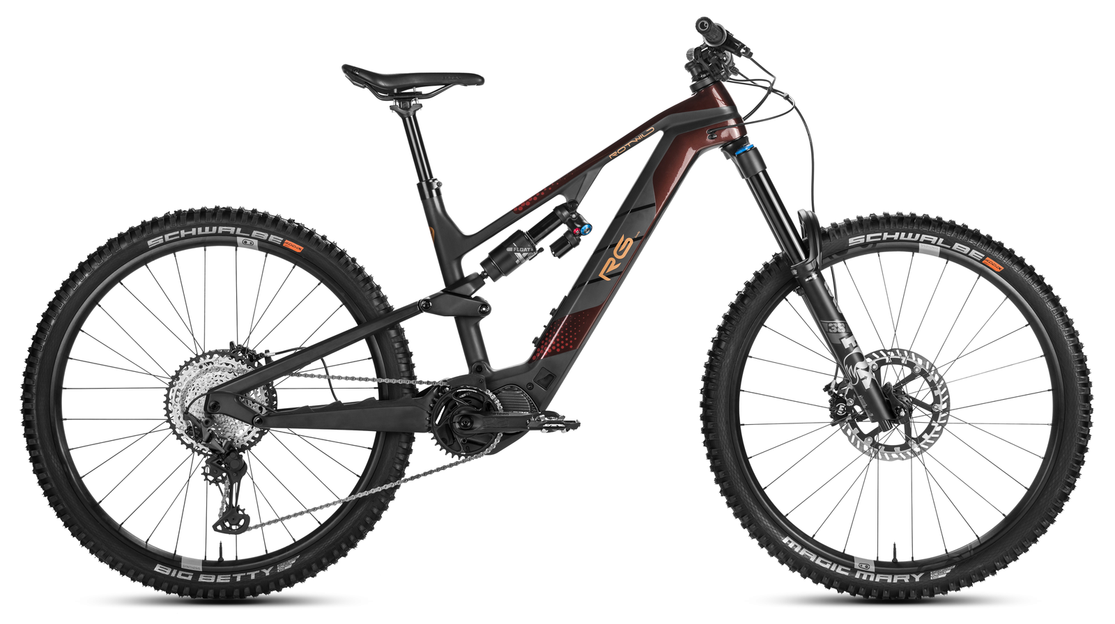

Rotwild R.G375 2025
EMTB Forums verdict
The Rotwild R.G375 is a German-built light gravity machine that the brand pitches squarely at bike parks, freeride and downhill duty. The handmade high-modulus carbon frame carries a full 180 mm up front and 177 mm at the rear, with the linkage and shock yoke also moulded in carbon to keep weight down. At a claimed 21.1 kg in size M it is notably light for a 180 mm e-bike, and that figure is helped considerably by the compact 360 Wh IPU375 carbon battery rather than the 600 Wh-plus packs most enduro e-bikes carry.
That small battery is the defining trade-off. The QR-Button quick release lets you swap packs quickly, and Rotwild's pitch is that a second battery effectively doubles your ride time, so this is a bike built around carrying spare energy rather than hauling one heavy cell. The Shimano EP8 motor delivers 85 Nm, which is competitive on torque even if range from a single charge will be short by class standards.
Only one build is offered, the PRO at 6,990 EUR, and it is a coherent gravity spec: a FOX 38 Performance Elite fork and Float X2 shock, four-piston Magura MT5 brakes on 203 mm rotors front and rear, a Shimano XT 12-speed drivetrain, Crankbrothers Synthesis Enduro wheels and a Magic Mary / Big Betty tyre pairing. The geometry backs the downhill intent with a slack 63 degree head angle, a 76 degree seat angle and long 460 mm chainstays across all three sizes, with reach running from 450 mm (M) to 500 mm (XL).

PRO
MotorShimano EP8 (DU-EP800) · 85 Nm
BatteryRotwild IPU375 Carbon · 360 Wh
Travel F/R180/177 mm
FrameHigh Modulus Carbon
ForkFOX 38 Float Performance Elite, 180 mm / Grip 2 / HSC/LSC HSR/LSR
ShockFOX Float X2 Performance, 230 x 65 mm / LSC/LSR 2-POS Lever
HeadsetACROS RW375 1.5
Steme*thirteen Plus, 35 mm / 50 mm / AL7050 I.C.R.
Handlebare*thirteen Plus, 35 mm / 20 mm Rise / 780 mm Width / AL7050 I.C.R
GripsERGON GD10 Slim Factory Frozen
SaddleERGON SM
Seatpost8PINS H01, 34.9 mm / 25 mm Offset / 145 mm (S) / 160 mm (M) / 180 mm (L) / 200 mm (XL)
BrakesMAGURA MT5 (front and rear, rear with Shiftmix)
Rear derailleurSHIMANO XT 8100, 12-Speed / SGS / Hyperglide+
Cranke*thirteen Plus, 160 mm (M) / 165 mm (L, XL); e*thirteen Direct Mount Chainring 34T; e*thirteen Plus chain guide
ShiftersSHIMANO XT 8100, I-Spec EV
CassetteSHIMANO CS 7100, 10-51 T. / 12-Speed
ChainSHIMANO HG 7100, 12-Speed
DrivetrainSHIMANO XT 8100, 12-Speed / SGS / Hyperglide+; e*thirteen Plus, 160 mm (M) / 165 mm (L, XL); e*thirteen Direct Mount Chainring 34T; e*thirteen Plus chain guide; SHIMANO XT 8100, I-Spec EV; SHIMANO CS 7100, 10-51 T. / 12-Speed; SHIMANO HG 7100, 12-Speed
WheelsCRANKBROTHERS Synthesis Enduro: front 31.5 mm width / 110-15 mm / 6-Bolt; rear 29.5 mm width / 148-12 mm / 6-Bolt
TyresFront: SCHWALBE Magic Mary Evo, Super Ground / Soft / TLE / 29x2.4. Rear: SCHWALBE Big Betty Evo, Super Trail / Soft / TLE / 29x2.4
Weight21.1 kg
