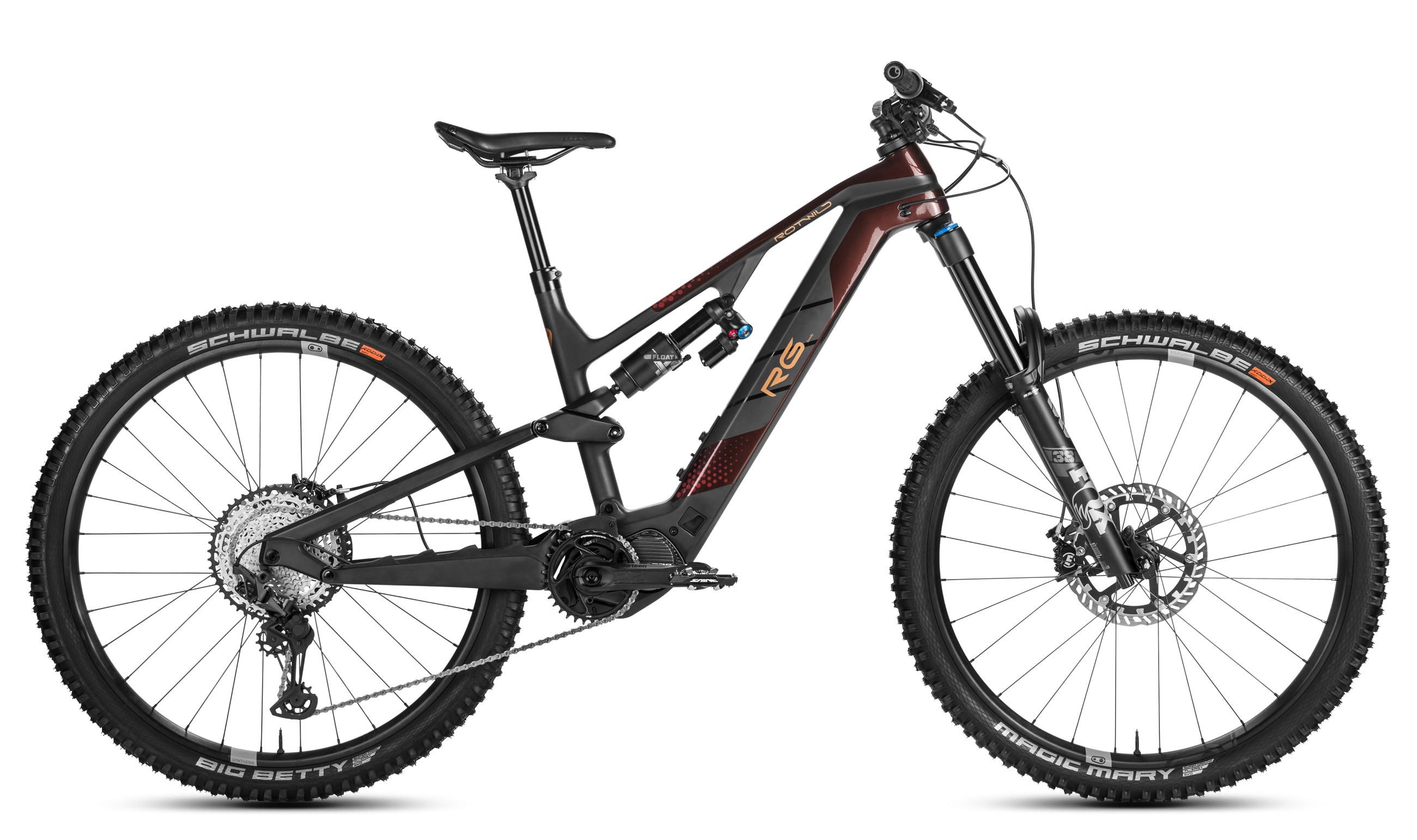

Rotwild R.G375 2022
EMTB Forums verdict
The R.G375 was Rotwild's Gravity flagship, a handmade full carbon bike park machine built around 180 mm up front (Fox 38) and 177 mm at the rear (Fox Float X2). With a very slack 63 degree head angle, a steep 76 degree seat angle and reach growing from 450 mm to 500 mm across M, L and XL, it read as a proper freeride and park weapon rather than an all rounder.
Power came from a Shimano EP8 motor delivering up to 85 Nm, paired with Rotwild's compact 375 Wh IPU375 carbon battery. The small pack, carbon frame and mixed 21700 cell technology kept weight low, positioning this as a light, playful gravity eMTB where jump feel mattered more than outright range.
Sold in a single well specced Pro build from 8,999 euros, the kit was gravity focused: Magura MT5 brakes on 220 mm rotors, Crankbrothers Synthesis Enduro wheels, Schwalbe Magic Mary and Big Betty tyres, and e*thirteen finishing kit. It has since been discontinued as Rotwild reshaped its e-mountain bike range.

Trims · 1
Pro
€8,999
MotorShimano EP8 (DU-EP800) · 85 Nm
BatteryRotwild IPU375 · 360 Wh
Travel F/R180/177 mm
FrameCarbon
ForkFOX 38 FLOAT PERFORMANCE ELITE 180 MM / FIT GRIP2 / HSC/LSC HSR/LSR / E-TUNED (110x15 mm / 44 mm offset)
ShockFOX FLOAT X2 PERFORMANCE 230 X 65 MM / LSC/LSR 2-POS LEVER (177 mm travel)
HeadsetACROS RW375 1.5 HEADSET W/ BLOCKLOCK
StemE*THIRTEEN PLUS Ø35 MM / 50 MM / AL7050 I.C.R.
HandlebarE*THIRTEEN PLUS Ø35 mm / 20 MM RISE / 780 MM WIDTH / AL7050 I.C.R
GripsERGON GD10 SLIM FACTORY FROZEN
SaddleERGON SM
SeatpostE*THIRTEEN VARIO COVERT INFINITE INDIVIDUAL UP TO 260 MM (XL)
BrakesMAGURA MT5 HC-W SHIFT MIX
Rear derailleurSHIMANO XT 8100 12-Speed
CrankE*THIRTEEN PLUS 160 mm (M) / 165 mm (L, XL)
ShiftersSHIMANO XT I-SPEC EV
CassetteSHIMANO CS 6100 10-51 T. / 12-SPEED
DrivetrainSHIMANO XT 8100 12-Speed; E*THIRTEEN PLUS 160 mm (M) / 165 mm (L, XL); SHIMANO XT I-SPEC EV; SHIMANO CS 6100 10-51 T. / 12-SPEED
WheelsCRANKBROTHERS SYNTHESIS ENDURO (31.5/29.5) / 110-15/148-12 TAS / 6-BOLT
TyresSCHWALBE MAGIC MARY / BIG BETTY EVO / SUPER GROUND / TRAIL / TLE SOFT / 29X2,40
