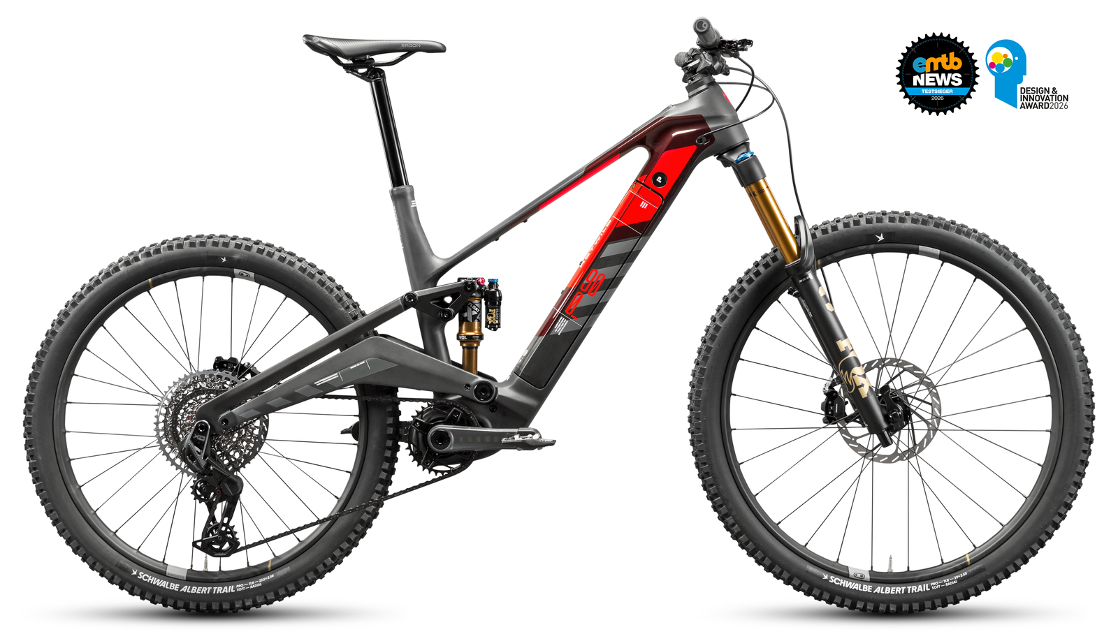

The Rotwild R.EX is the all-mountain sibling of the World Cup race enduro R.EXC, built around the same Polydynamic carbon frame and Mid-High Pivot rear end but with travel trimmed to 160 mm front and 150 mm rear on a mullet (29in front, 27.5in rear) wheel setup. The headline tech is the DJI Avinox M1 motor with 105 Nm and up to 1,000 W, paired with Rotwild's in-house IPU900 Carbon battery at a class-leading 864 Wh, all controlled through the 2in Avinox OLED display.
Three builds share that frame, motor, battery and geometry, so the choice comes down to kit. The Core (8,990 EUR) runs FOX 36 Performance and Float X with a Shimano XT mechanical drivetrain and Magura MT5 brakes. The Pro (9,990 EUR) switches to RockShox Lyrik Select+ and Super Deluxe, wireless SRAM GX Transmission AXS and SRAM Maven Bronze brakes for only 1,000 EUR more, which makes it the value pick. The Ultra (12,490 EUR) adds FOX Factory Kashima suspension, X0 Transmission, Maven Silver and carbon Crankbrothers Synthesis wheels, dropping claimed weight to 22.0 kg.
Geometry is consistent across sizes with a 64 degree head angle, 78 degree effective seat angle and 439 mm chainstays, while reach runs 462 to 512 mm from M to XL. The ACROS angle headset offers plus or minus 0.5 degree adjustment and the reach can be shifted plus or minus 5 mm, giving riders some scope to tune the handling between sportier trail and more composed terrain.
