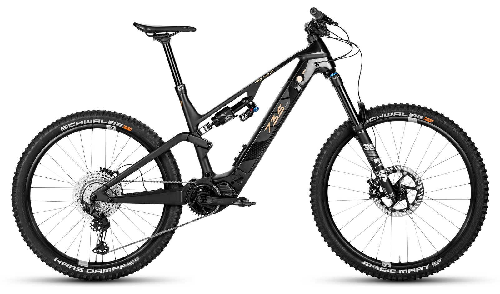

Rotwild R.E735 2024
EMTB Forums verdict
The Rotwild R.E735 is the German brand's full-carbon mullet enduro eMTB, sitting under the Enduro category on Rotwild's own product nav where the brand confirms its 'E' designation stands for Enduro. It pairs a 29in front and 27.5in rear wheel with 170 mm up front and 148 mm out back, a slack 64.5 degree head angle and a four-bar linkage with an alloy yoke that allows the short 440 mm chainstays.
Power comes from a Shimano EP801 motor delivering up to 85 Nm, fed by Rotwild's own IPU735 battery: an effective 720 Wh, 21,700-cell pack in a handmade carbon housing with side quick-release, claimed at just 3.5 kg. The two trims share frame and geometry: the Core at 8,490 EUR runs FOX 36 Performance, FOX Float X2 Performance, Magura MT5 brakes and Shimano XT 8100 shifting on Crankbrothers Synthesis Enduro wheels (claimed 22.2 kg), while the Ultra at 11,499 EUR upgrades to FOX Factory Kashima suspension, Shimano XT 8120 brakes, e*thirteen Race Carbon finishing kit and Synthesis i9 Carbon wheels (claimed 21.6 kg).
Geometry is consistent across the S to XL range with reach from 420 to 490 mm and an eMTB-typical wheelbase of 1199 to 1282 mm, marking it as a stable, descent-focused enduro machine rather than an all-day trail bike. It is now discontinued and superseded by later R.E735 model years that continue the same lineage in Rotwild's catalogue.

How it stacks up vs other Full Power · Trail bikes (from 223 bikes in the database)
Weight21.6 kg1.4 kg lighter than average
Battery720 Whabout average capacity
Motor torque85 Nm13 Nm below average
Bike geometry diagram
SMLXL
Reach420 mm440 mm465 mm490 mm
Stack633 mm633 mm651 mm661 mm
Seattube410 mm440 mm470 mm506 mm
Chainstay440 mm440 mm440 mm440 mm
Headtube Angle64.5°64.5°64.5°64.5°
Seattube Angle (eff)74°74°74°74°
Wheelbase1199 mm1219 mm1253 mm1282 mm
Headtube110 mm110 mm130 mm140 mm
Standover737 mm737 mm737 mm737 mm
Front Centre759 mm*779 mm*813 mm*842 mm*
FC:RC1.731.771.851.91
