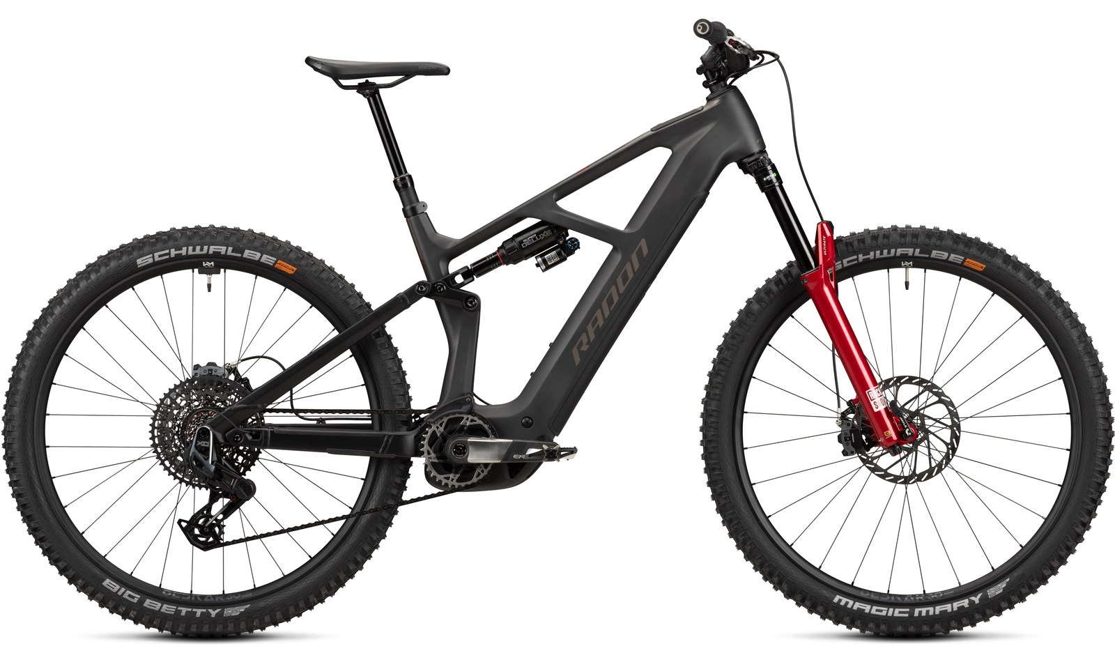

Radon Render 2026
From £3,890
EMTB Forums verdict
The Render is Radon's full-power trail all-rounder, and for 2026 it gets a ground-up overhaul: a redesigned carbon main frame with an aluminium swingarm, the latest Bosch Performance Line CX Gen5 Smart System motor, and a large 800Wh PowerTube battery quickly removable through an integrated push-lock cover. Travel sits at 160mm front and 140mm rear on 29in wheels, placing it between Radon's lightweight Recap and the longer-travel Deft.
Geometry is deliberately long and stable rather than extreme. In size L the reach is 475mm with a 642mm stack, a 65 degree head angle and a 75.5 degree effective seat angle, on 458mm chainstays and a 1268mm wheelbase. An Acros AngleSet headset lets riders tweak the head angle slacker or steeper, so the same frame can be tuned for agility or descending composure. Three sizes (M, L, XL) are offered.
The four-bike range is consistently specced and priced sharply for a consumer-direct brand. The 8.0 800 (4499 euro) is the mechanical-shift entry with Fox Rhythm suspension and Magura Louise brakes; the 9.0 800 (5499 euro) steps up to Fox Performance, SRAM Maven brakes and wireless GX Transmission. The 10.0 800 (6299 euro) brings Fox Factory Kashima suspension and Shimano XT Di2, while the descent-focused 10.0 HD 800 (6999 euro) tops the line with RockShox Lyrik Ultimate, Super Deluxe Ultimate, SRAM Maven Ultimate brakes and a UD carbon finish.
