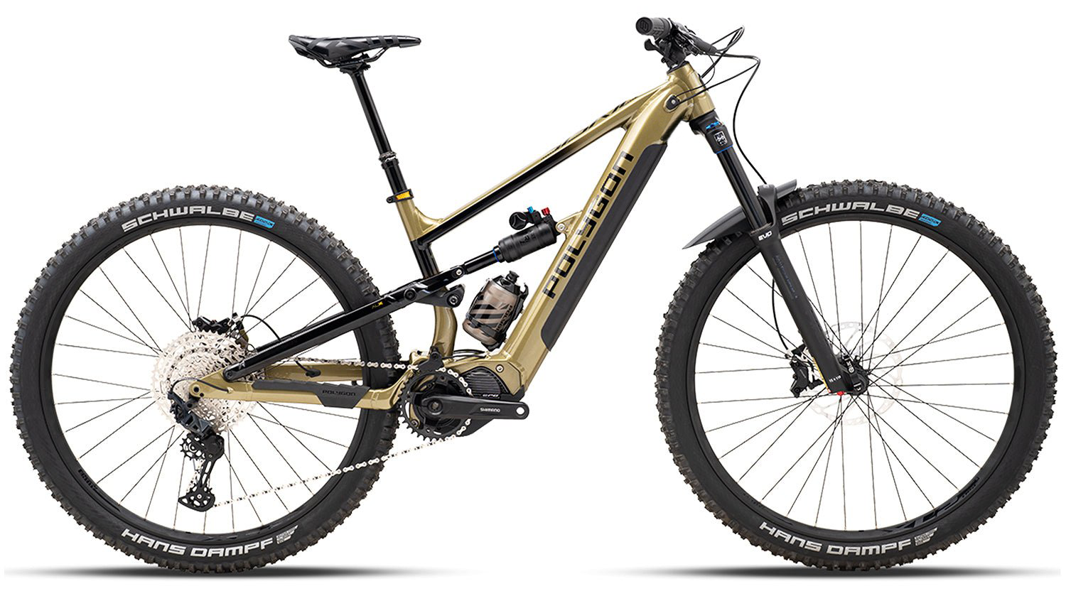

EMTB Forums verdict
The Siskiu T7E is Polygon's factory-direct value play in the trail eMTB class, built around a Shimano EP801 motor (85Nm) fed by a 630Wh removable Shimano battery, with 150mm of front travel and 140mm at the rear from a full SR Suntour package (Aion 35 fork, TriAir2 3CR shock). It is sold as a single build in the UK with an RRP of £4,500, undercutting most name-brand rivals on the same motor platform.
The component mix is sensibly weighted towards control: a Shimano SLX shifter and rear derailleur run a 1x12 drivetrain over a Deore cassette, while SRAM Code R four-piston brakes on 203mm rotors handle stopping. The aluminium frame carries a flip chip, so the bike runs full 29in as standard but can be set up as a mullet with a 27.5in rear wheel, and dropper travel scales with frame size (150mm on S-M, 170mm on L-XL).
Geometry is firmly in modern trail territory: a 65-degree head angle, 77-degree seat angle and a consistent 452mm chainstay across all four sizes, with reach growing from 452mm on the S to 512mm on the XL. The 337mm bottom bracket height and 1232mm wheelbase on the M point to a bike that prioritises stability and confidence on descents rather than outright nimbleness.

Trims · 1
Base
£4,500
MotorShimano EP801 · 85 Nm
BatteryShimano BT-EN806 · 630 Wh
Travel F/R150/140 mm
FrameAluminium
ForkSR Suntour Aion 35 Boost RC-PCS, 150mm travel, 110x15mm Boost thru-axle, 51mm offset
ShockSR Suntour TriAir2 3CR, 210x55mm
HeadsetFSA NO.57E w/ sealed bearing, ZS 44/28.6 | ZS 56/40
StemENTITY, EXT: 35mm, BB: 35mm, R/D: 0 degree
HandlebarENTITY, W: 780mm, BB: 35mm, R/D: 25mm, B: 9 degree
SaddleEntity Xtend
SeatpostTranzX dropper, 1x remote, 30.9mm, 150mm (S-M) / 170mm (L-XL)
BrakesSRAM Code R, 4-piston hydraulic disc
Rear derailleurShimano SLX RD-M7100-SGS 12-speed
CrankShimano SM-CRE80-12-B 34T chainring
ShiftersShimano SLX SL-M7100-R 1x12-speed trigger
CassetteShimano Deore CS-M6100 12-speed 10-51T Micro Spline
ChainKMC E12S for 12-speed
DrivetrainShimano SLX RD-M7100-SGS 12-speed; Shimano SM-CRE80-12-B 34T chainring; Shimano SLX SL-M7100-R 1x12-speed trigger; Shimano Deore CS-M6100 12-speed 10-51T Micro Spline; KMC E12S for 12-speed
WheelsEntity XL3 tubeless ready (alloy double wall, 35mm inner, 32H)
TyresSchwalbe Hans Dampf EVO 29"x2.60" 622x65 Super Trail, TLE, Addix Speed Grip
Price£4,500
