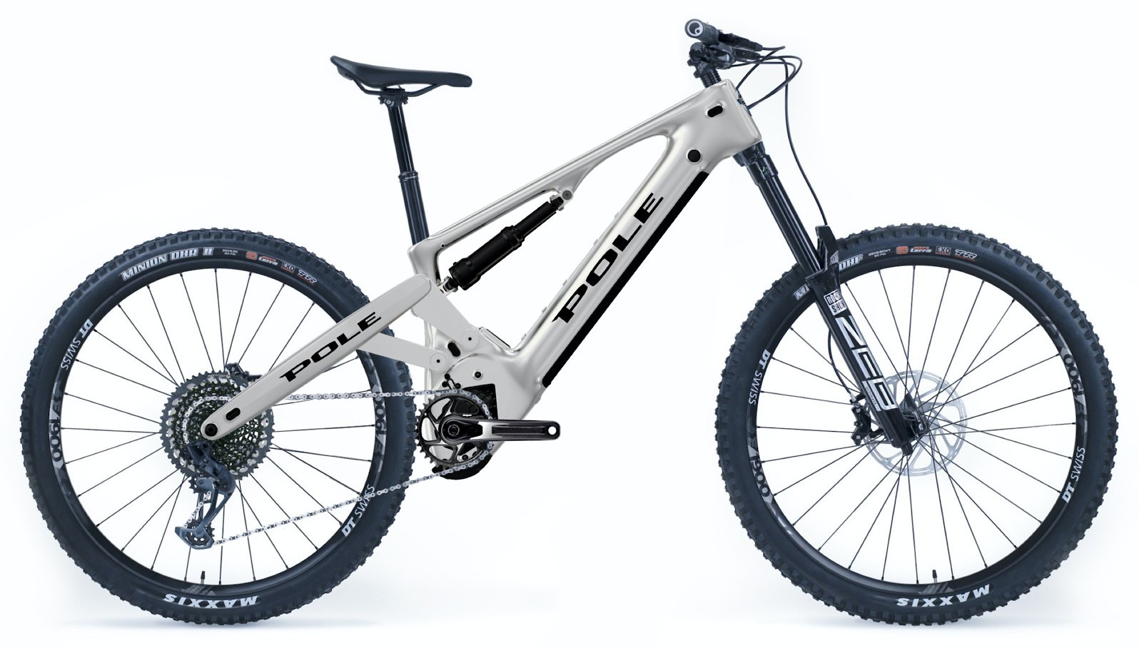

Pole Voima 2025
From £6,880
EMTB Forums verdict
The Pole Voima 2025 is the Finnish brand's CNC-machined 7075-T6 aluminium enduro eMTB flagship, distinctive for its 190mm front and rear travel and bonded-construction frame. Headline numbers: 190mm fork, 190mm rear, Bosch Performance Line CX Gen 4 (85Nm at the listed 2025 spec, with PU2.0 firmware path to 120Nm Gen 5 mapping where compatible), a removable 750Wh Bosch PowerTube battery, 25.5kg claimed, 63.5 degree head angle and reach 450 to 535mm across K1, K2, K3 and K4. Priced from GBP 6,999. Production status is listed as discontinued. @D3xt3rMTB's K4 build represents Pole's typical top-spec configuration: 190mm Zeb Ultimate, Vivid Ultimate Air, 750Wh battery plus a 500Wh additional battery included.
Drive system and range. The 2025 Voima shipped with the Bosch Performance Line CX Gen 4 at 85Nm and 600W peak. Where the bike receives Bosch's PU2.0 firmware update path it is lifted to 120Nm at the wheel and 750W peak (the Gen 5 spec). The 750Wh PowerTube battery is removable through the downtube. @D3xt3rMTB reports K4 configurations including an additional 500Wh battery, taking total capacity to 1,250Wh effective for backcountry alpine missions: exceptional range for the segment. Bosch's Flow app, Kiox display and OTA firmware come standard.
Geometry and handling. 63.5 degrees up front is properly slack: bordering on DH territory. Reach steps cleanly: 450 (K1), 480 (K2), 510 (K3), 535 (K4): Pole's signature long reach approach. Chainstays are a uniform 455mm and wheelbase tops out at 1368mm on K4. @D3xt3rMTB confirms K4 is the largest frame size Pole manufactures, suited for tall riders. The Sensei dual-link suspension layout combined with 190/190mm travel and CNC-machined 7075-T6 aluminium is genuinely unique in the eMTB world.
Build and value. One trim listed at GBP 6,999 / 25.5kg. Spec: RockShox ZEB Ultimate Charger 3 (190mm), RockShox Super Deluxe Ultimate (250x75mm), SRAM Code RSC four-piston brakes. Pole's custom-spec build-to-order philosophy means buyers configure significant elements. @High Rock Ruti reports Shimano Di2 derailleur on a Voima requiring zero adjustment over 2,500+ miles, "far better reliability than SRAM AXS". Standout: 7075-T6 CNC-machined frame is among the most premium aluminium construction in the segment. Questionable: 25.5kg is heavy versus Avinox carbon enduro rivals; the discontinued status removes new-build options.

Frame
Seamless CNC-machined and bonded 7075-T6 aluminium frame featuring Pole's Sensei dual-link suspension with 190 mm rear travel paired to a 190 mm fork; 29-inch wheels; sizes K1-K4; integrated 750 Wh Bosch PowerTube battery (removable). Optional Voima ID variant adds wireless mini remote and top-tube System Controller.
Bike geometry diagram
K1K2K3K4
Reach450 mm480 mm510 mm535 mm
Stack635 mm648 mm648 mm648 mm
Chainstay455 mm455 mm455 mm455 mm
Headtube Angle63.5°63.5°63.5°63.5°
Seattube Angle (eff)80°80°80°80°
Wheelbase1283 mm1313 mm1343 mm1368 mm
Front Centre828 mm858 mm888 mm913 mm
Trims · 1
Standard
£6,880
MotorBosch Performance Line CX Gen 4 · 85 Nm
BatteryBosch PowerTube 750Wh · 750 Wh
Travel F/R190/190 mm
FrameAluminium
ForkRockShox ZEB Ultimate Charger 3 190mm
ShockRockShox Super Deluxe Ultimate 250x75mm
DrivetrainBosch Performance Line CX Gen4
Weight25.5 kg
Price£6,880
