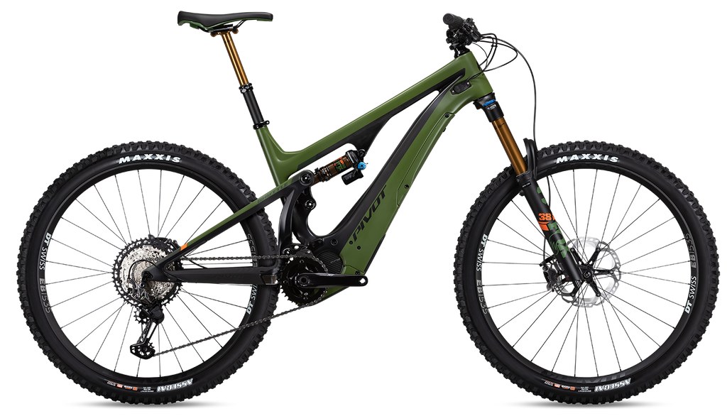

Pivot Shuttle 2022
EMTB Forums verdict
The 2022 Pivot Shuttle was Pivot's original full-power eMTB, the sole e-bike in its July 2022 catalogue and later renamed Shuttle AM. It used a full-carbon hollow-core chassis with Pivot's dw-link suspension giving 140mm of rear travel through a Fox Float X shock, matched to a 160mm Fox 38 or Fox 36 fork depending on build. Power came from a Shimano STEPS EP8 (DU-EP800) drive unit rated at 85Nm and 500 watts peak, fed by a 726Wh battery, with 29in wheels front and rear on Super Boost Plus 157mm spacing.
Geometry was consistent across four sizes: a 64.3 degree head angle, a 74.0 degree effective seat angle, 441mm chainstays and reach from 420mm on the Small to 485mm on the XL, with Maxxis Assegai and Minion DHR II rubber on DT Swiss EB wheels. The range spanned four builds: the flagship Team XTR (Fox Factory 38 GRIP2 and Float X, full Shimano XTR) at 11,899 US dollars, a Team Special Edition with an XTR and XT mix, and the Fox Performance 36 based Ride SLX/XT and Race XT builds at around 9,500 to 9,600 US dollars.
This model is discontinued. Pivot renamed it the Shuttle AM by late 2022 and kept the EP8 platform for 2023 before moving the Shuttle AM to a Bosch drive unit. As a research dossier this entry records the published specification and geometry only and makes no claim about long-term ride feel or reliability.

Bike geometry diagram
SMLXL
Reach420 mm440 mm460 mm485 mm
Stack614 mm624 mm633 mm642 mm
Seattube395 mm424 mm458 mm496 mm
Chainstay441 mm441 mm441 mm441 mm
Headtube Angle64.3°64.3°64.3°64.3°
Seattube Angle (eff)74°74°74°74°
Wheelbase1187 mm1214 mm1235 mm1264 mm
Headtube110 mm120 mm130 mm140 mm
BB Height358 mm358 mm358 mm358 mm
Standover715 mm715 mm723 mm723 mm
Front Centre746 mm*773 mm*794 mm*823 mm*
FC:RC1.691.751.801.87
