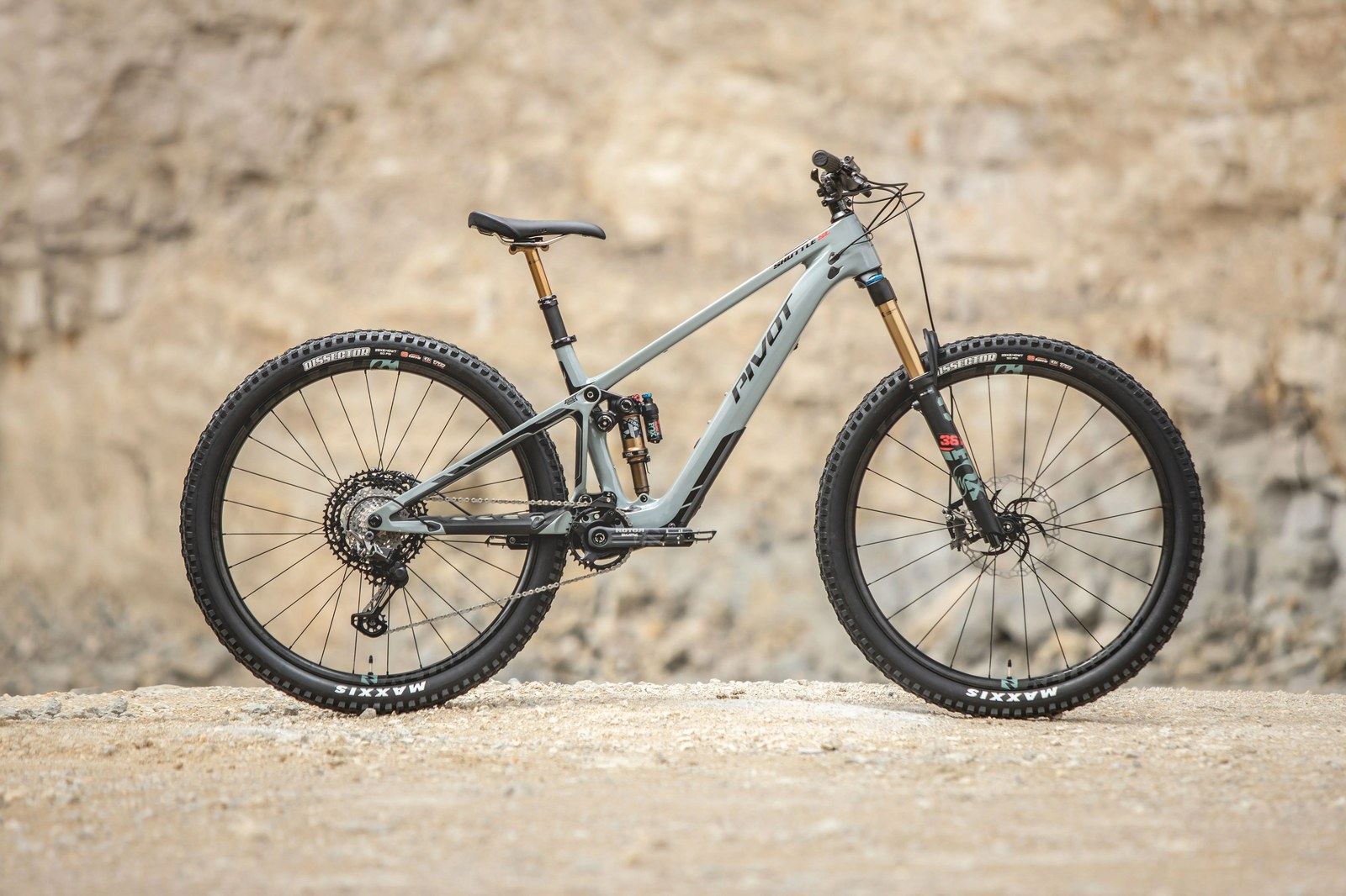

Pivot Shuttle SL 2024
EMTB Forums verdict
The 2024 Pivot Shuttle SL is the lightweight end of Pivot's e-bike range, a full-carbon DW-Link trail bike built around the Fazua Ride 60 drive unit (60 Nm, 450 W peak) and an integrated 430 Wh battery. With 132mm of rear travel paired to a 150mm Fox 36 fork on full 29in wheels, it is positioned as a quiet, natural-feeling trail eMTB rather than a full-power machine, and Pivot quote a 4.2kg motor-and-battery system weight.
Four builds were offered, all sharing the same frame, motor and Maxxis tyre lineage. The Ride (8,999 USD) runs a Shimano SLX/XT mix with Fox Performance suspension and DT Swiss M1900 wheels; the Pro (10,999 USD) steps up to Fox Factory, SRAM X0 Eagle Transmission and DT Swiss XM1700 wheels; the Team (12,999 USD) tops the trail line-up with full Shimano XTR, Fox Factory GRIP2 and Reynolds Blacklabel carbon wheels on Industry Nine Hydra hubs; and the lightest World Cup (13,199 USD) trades the 150mm Fox 36 and Float X for a shorter-travel 140mm Fox 34, Float DPS shock, fast-rolling Maxxis Rekon tyres and a carbon-railed WTB saddle for the cross-country-minded rider.
Geometry is modern-trail and adjustable via a flip-chip, with a 65.5 degree head angle, 76.5 degree effective seat angle and size-specific chainstays growing from 430mm to 436mm across the four sizes. A full-size bottle fits inside the front triangle, and the magnetic charging port is a neat touch.
This is a discontinued 2024 model year, so availability is limited to remaining stock and the used market. No UK GBP RRP could be verified, so prices above are the US MSRP as listed on Pivot's own product page.
