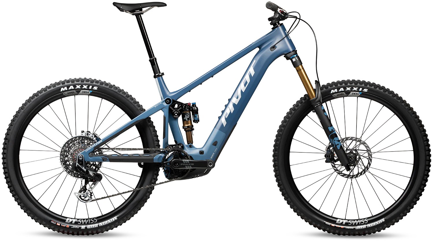

The Shuttle AM is Pivot's full-power all-mountain platform: a carbon chassis with 150mm of DW-link rear travel and a 160mm fork, rolling on 29in wheels. For 2026 it moves to Bosch's Gen 5 Performance Line CX drive (CX-R Race Edition on the Pro and Team builds) paired with an 800Wh battery, with claimed figures up to 100Nm and 750W peak and a Bosch PowerMore 250 range extender as an option.
The geometry is firmly enduro-leaning rather than steep XC: a 64.5 degree head angle across all sizes, a 76.9 degree effective seat angle and a consistent 444mm chainstay (figures from the manufacturer's High geometry setting; a Low setting is also published). Reach runs from 435mm on the SM to 500mm on the XL, so most riders will find a size, and the long-and-slack stance suits steep, technical descending more than tight, twisty climbs.
Three builds span a wide price range. The Ride is the accessible entry on RockShox suspension and SRAM Eagle 70/90 Transmission. The Pro steps up to a RockShox ZEB Ultimate fork, Super Deluxe Ultimate shock, X0 Eagle Transmission and Maven Silver brakes on DT Swiss HX1501 wheels with a Maxxis DHF/DHRII tyre pairing. The Team XX tops the range with FOX Factory suspension (with the option of Live Valve Neo), XX Eagle Transmission and Maven Ultimate brakes. The Pro looks the value sweet spot, carrying the same motor and brake family as the Team for a notably lower outlay.

Bike geometry diagram
SMLXL
Reach435 mm465 mm480 mm500 mm
Stack629 mm638 mm647 mm656 mm
Seattube378 mm399 mm432 mm470 mm
Chainstay444 mm444 mm444 mm444 mm
Headtube Angle64.5°64.5°64.5°64.5°
Seattube Angle (eff)76.9°76.9°76.9°76.9°
Wheelbase1216 mm1250 mm1269 mm1294 mm
Headtube110 mm120 mm130 mm140 mm
BB Height350 mm350 mm350 mm350 mm
Standover720 mm720 mm720 mm720 mm
Front Centre772 mm*806 mm*825 mm*850 mm*
Trims · 3
Pro
Ride
Team XX
MotorBosch Performance Line CX-R Gen 5 · 100 NmBosch Performance Line CX Gen 5 · 100 NmBosch Performance Line CX-R Gen 5 · 100 Nm
BatteryBosch PowerTube 800 · 800 Wh · all trims
Travel F/R160/150 mm · all trims
FrameCarbon · all trims
ForkRockShox Zeb Ultimate 29", 44mm offset, 160mmRockShox (Ride build)FOX Factory (Team build; option to upgrade to FOX Live Valve Neo)
ShockRockShox Super Deluxe UltimateRockShoxFOX Factory (Team build; option to upgrade to FOX Live Valve Neo)
HeadsetPivot Precision Sealed Cartridge
StemPhoenix Team Enduro/Trail
HandlebarPhoenix Race Low Rise Carbon
GripsPhoenix Factory Lock-On
SaddlePivot Pro E-Bike
SeatpostOneUp Dropper V3 150mm (SM), 180mm (MD), 210mm (LG-XL)
BrakesSRAM Maven Silver 4-pistonSRAM Maven Ultimate 4-piston
Rear derailleurSRAM X0 Eagle Transmission 12-SpeedSRAM Eagle 70/90 TransmissionSRAM XX Eagle Transmission 12-Speed
CrankPraxis Alloy eCranks E-MTB 34t - 160mm
ShiftersSRAM AXS Pod ControllerSRAM AXS Pod Controller
CassetteSRAM GX 1275 Eagle Transmission 10-52t
ChainSRAM X0 Eagle Flattop 12-Speed
DrivetrainSRAM X0 Eagle Transmission 12-Speed; Praxis Alloy eCranks E-MTB 34t - 160mm; SRAM AXS Pod Controller; SRAM GX 1275 Eagle Transmission 10-52t; SRAM X0 Eagle Flattop 12-SpeedSRAM Eagle 70/90 TransmissionSRAM XX Eagle Transmission 12-Speed; SRAM AXS Pod Controller
WheelsDT Swiss HX1501 w/ DT Swiss 350 hub & 36t Star Ratchet 30mm - 29" 15x110 F / 12x157 R
TyresMaxxis Minion DHF 29" x 2.5" WT, TR, 3C, EXO+, MAXXTERRA (F); Maxxis Minion DHRII 29" x 2.4" WT, TR, 3C, EXO+, MAXXTERRA (R)
