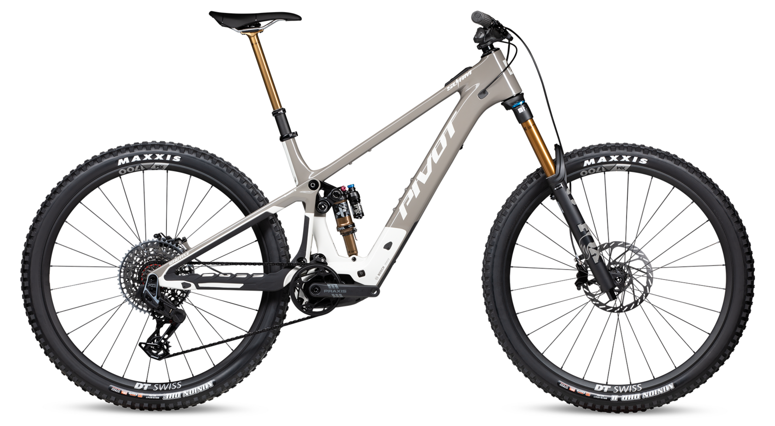

The Pivot Shuttle AM 2025 is the Arizona brand's all-mountain flagship eMTB, built around the Bosch Performance Line CX Gen 5 motor (120 Nm torque, 250 W rated, 750 W manufacturer-claimed peak, 2.8 kg) and a fully integrated 800 Wh Bosch PowerTube battery. Travel is 160 mm front and 150 mm rear on a hollow-core carbon DW-link chassis with Super Boost 157 mm rear spacing. Five trims from £8,999 (Ride) to £13,999 (Team), claimed weight 21.5 kg. Twelve size/configuration combinations from XS through XL, reach 420-505 mm, head angle 64.1-64.5 degrees, chainstays 444-445 mm. The community read in one line: a properly refined American carbon DW-link all-mountain platform with Bosch CX Gen 5 power and the largest available Bosch battery, hampered only by the integrated (non-removable) battery design and Pivot premium pricing.

Hollow-core carbon fibre frame with dw-link suspension delivering 150 mm rear travel paired to a 160 mm fork; 29-inch wheels with MX flip-chip compatibility, Super Boost 157 mm rear spacing, integrated 800 Wh Bosch PowerTube battery with PowerMore 250 range-extender option.
