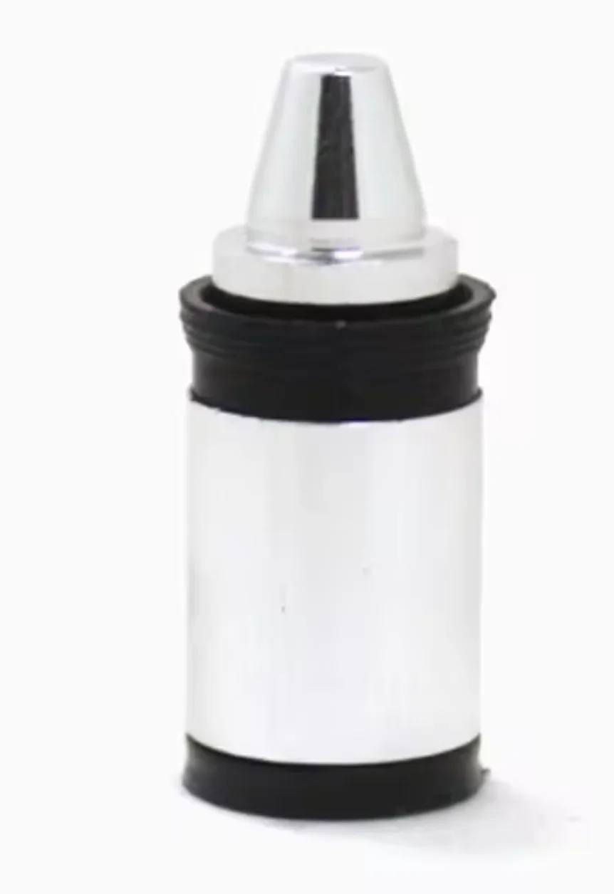

The master cylinder piston is available for a reasonable price from Amazon. I’ve ordered several and so have others in my circle.
A good time to install a new master cylinder piston is when you upgrade to the HC3 lever. They seem to actuate the piston a little better …which gives better results. I like the adjustability also. (Warning; these levers are stupid expensive).

The rebuilding is basically an alloy piston and 3 rubber seals.
The rebuild kit is available on Amazon for $6-$12. I usually keep a spare.
Usually a full bleed is necessary after installing. A lever bleed may not be enough.
Clean your calliper pistons and rotate your callipers, especially the rear one, to eliminate any trapped air.

I will report on the repair once I get the rebuild kits,Amazon originally showed over night delivery on them, but after I clicked buy that shifted to Thursday🤬 So I will likely just do the rebuild next weekend.

Well, I Must have screwed something up in first rebuild attempt, have to try again, feels like piston isn’t uncovering replenish port, can’t push fluid back up through system. So I swapped in my old Magura MT4 masters, they are actually made out of aluminum! Scrubbed all my old pads clean, rubbed them together with water, pulled a brand new disc out of the package and…. Still requires considerable pressure to lock the wheel, and more pressure than I think is normal to create decent braking force, so now I have a new theory, the Magura Brake discs I got from jensonUSA were on sale for like 11 bucks each, so I bought 4 of them, possibly counterfeit or just a defective batch run of them sold off cheap. They are in Magura packaging and the lettering on them looks correct. MDR-C ebike discs with magnet mounting hole.
I put the bike in walk mode on the stand and drug the rear brake to get a preliminary bed in done. Result was Poor stopping. Repeated walk mode test and monitored temp with a heat gun, I can get the pads all the way to 200f but the discs never get above 70f while dragging the brake in walk mode. Maybe not a great test🤷‍♂️don’t know.
Tried my sintered pads, unable to slide tire at all. Even weaker response. All pads and discs Magura...

The master cylinder rebuild piston has worked well for us (4bikes) . My calliper pistons are regularly serviced, cleaned, extended with a small tool, centred and perfectly aligned for different rotor sizes (220mm front and 203mm rear.

The old MT4 masters are much higher quality, when I get back into the garage I will take a pic. New MT4 have the current master.
