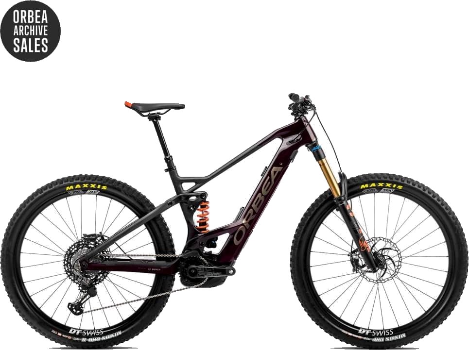

The Orbea Wild FS was the brand's outgoing full-power enduro eMTB, offered for 2022 as a 29er running 160mm of travel front and rear. Power comes from the Bosch Performance Line CX Gen 4 motor (85Nm) paired with a Bosch PowerTube battery and a Bosch Kiox or Purion display, the pre-Smart-System hardware of the era. The frame was sold as full carbon on the M-models (with an aluminium rear triangle on the M20) and hydroformed alloy on the H-models.
Geometry is sensibly modern rather than extreme for its time: a 65.5 degree head angle, a 76 degree effective seat angle and a long 455mm chainstay shared across every size, with reach growing from 430mm on the S to 485mm on the XL. It is only a three-size range (S, L, XL), which is worth noting when sizing against four-size rivals.
The 2022 trim ladder is broad. The flagship M-LTD headlines with Fox 38 Factory Grip2 and a DHX2 coil shock, a full Shimano XTR transmission and DT Swiss carbon wheels; the M-Team and M10 keep the carbon frame on progressively simpler Fox and Shimano kit; and the alloy H-models bring the platform down to Fox 38 Performance or RockShox 35 forks with Shimano Deore shifting. All trims run a 625Wh Bosch PowerTube except the entry H30, which drops to a 500Wh pack.
As a discounted, proven 160mm Bosch CX platform it still makes sense for a buyer who accepts the three-size frame range and the Gen 4 motor rather than the newer, redesigned Wild that replaced it.
