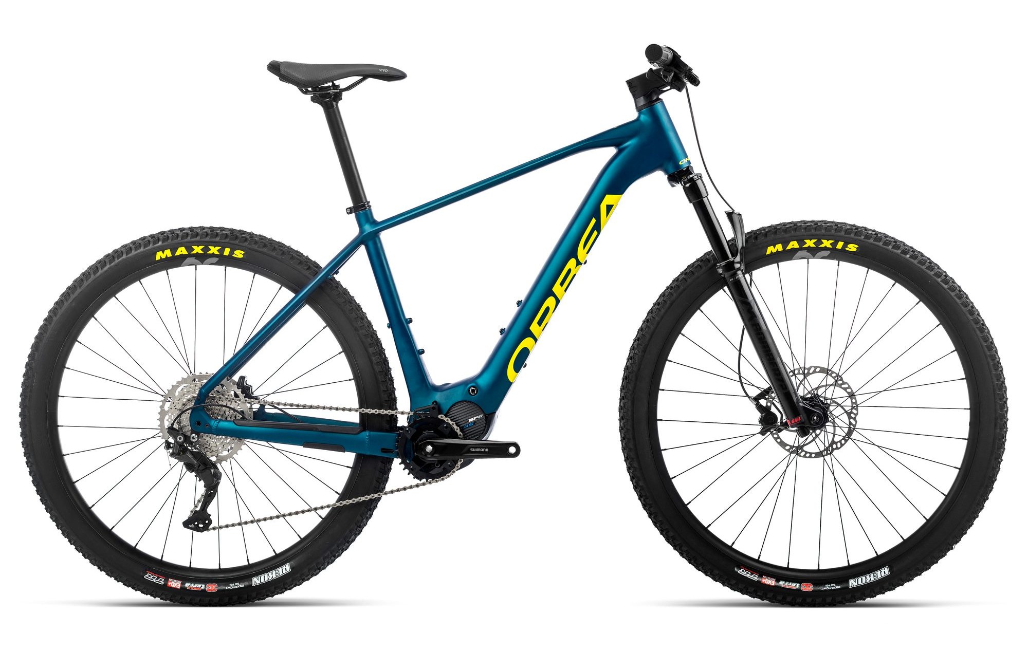

Urrun 2022
DiscontinuedLightweight · Cross-CountryLegacy · 0.4/10iFreshness 0.4/10
Efficient full-power alloy hardtail for climbing and easy trail access
Motor
Shimano EP8 (DU-EP800) · 60Nm · 500W
Battery
Orbea Internal 540 · 540Wh
Travel F/R
120mm / —
Wheels
29F / 29R
Frame
Aluminium
Weight
Price
From £3,499
View the Orbea Urrun on Orbea’s site
Orbea Urrun 2022
From £3,499
EMTB Forums verdict
The 2022 Urrun was Orbea's first aluminium trail e-hardtail, launched in May 2022 around a 120mm fork, 29in wheels and the lightweight Shimano EP8-RS motor shared with the Orbea Rise. The RS tune trades outright grunt for a quieter, more natural-feeling 60Nm delivery, and the 540Wh integrated battery (extendable to 792Wh with the optional 252Wh RS range extender) is aimed at long days out rather than lap-shuttle laps.
Two builds were sold, both on the same hydroformed 6061 alloy frame. The Urrun 10 at £4,299 is the sharper spec: a Fox 34 Float Performance fork, four-piston Magura MT5 brakes, a 12-speed Shimano XT drivetrain, tubeless Race Face wheels and an OC Mountain Control dropper post. The £3,499 Urrun 30 keeps the frame, motor and battery but steps down to a Marzocchi Bomber Z2 fork, Magura MT30 brakes, a 10-speed Shimano Deore group and a rigid alloy seatpost.
Geometry is trail-leaning but restrained by modern standards, with a 66 degree head angle (65.5 on the S), a roughly 74.5 to 74.8 degree effective seat angle and 445mm chainstays across the range. Reach runs from 395mm on the S to 460mm on the XL, so this is an efficient, easy-going distance hardtail rather than an aggressive descender.
