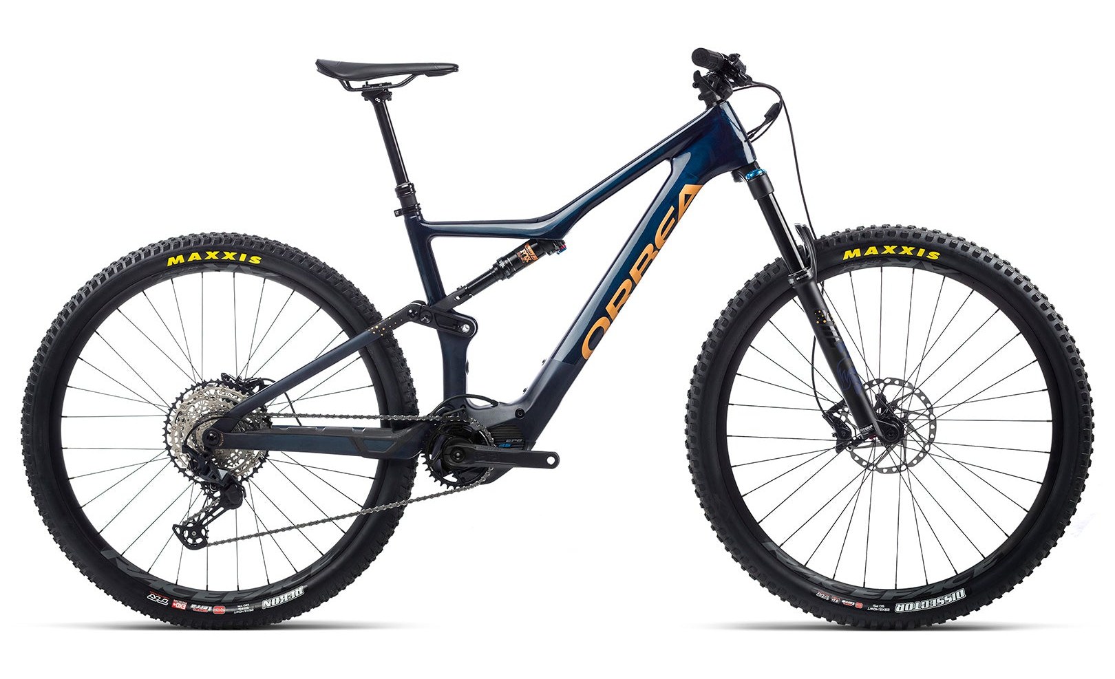

Rise 2022
DiscontinuedLightweight · TrailLegacy · 0.4/10iFreshness 0.4/10
First-generation lightweight with light assist and modest 360Wh range
Motor
Shimano EP8 (DU-EP800) · 60Nm · 500W
Battery
Orbea RS Internal 360Wh (M-series) / Orbea Internal 540Wh (H-series)
Travel F/R
140/140mm
Wheels
29F / 29R
Frame
Aluminium / Full carbon
Weight
Price
From £4,899
View the Orbea Rise on Orbea’s site
Orbea Rise 2022
From £4,899
EMTB Forums verdict
The 2022 Orbea Rise was the bike that legitimised the lightweight, "more bike, less e" trail eMTB category. It pairs 140mm of rear travel with a 140 or 150mm fork on 29in wheels, and a trail-friendly stance that has aged well: a 66 degree head angle, 77 degree effective seat angle and 474mm reach in size L, on 445mm chainstays across every size.
Its defining feature is the drive system. Every 2022 Rise, carbon and alloy, runs the Shimano EP8-RS, the drive unit co-developed with Shimano for the RS (Rider Synergy) concept. It is the same DU-EP800 hardware as the full-power EP8, but factory tuned to cap torque at 60Nm and to deliver assistance at a natural 75 to 95rpm cadence rather than raw shove, which is what gives the Rise its road-bike-like, range-focused feel. The carbon M-series carries a compact 360Wh internal pack; the new-for-2022 alloy H-series steps up to a 540Wh pack, and a 252Wh bolt-in Range Extender is optional across the range.
The range spans seven builds. The carbon line runs M20, M10, M-Team and the flagship M-LTD, the last two with Fox Factory suspension and XTR; the M10 has long been the value sweet spot with a Fox 36 Factory fork and XT. The alloy Rise Hydro line (H10, H15, H30) opened the platform up on price, from the Fox Factory-equipped H10 down to the H30 with a Marzocchi Bomber Z2 fork, all sharing the same frame geometry and RS motor.
This 2022 model is discontinued. It was updated for 2023 and later replaced by the current-generation Rise (Rise SL and Rise LT), which moved to the newer Shimano EP801-RS unit and a revised frame, so battery packs and some fit numbers are not cross-compatible with this original generation.
