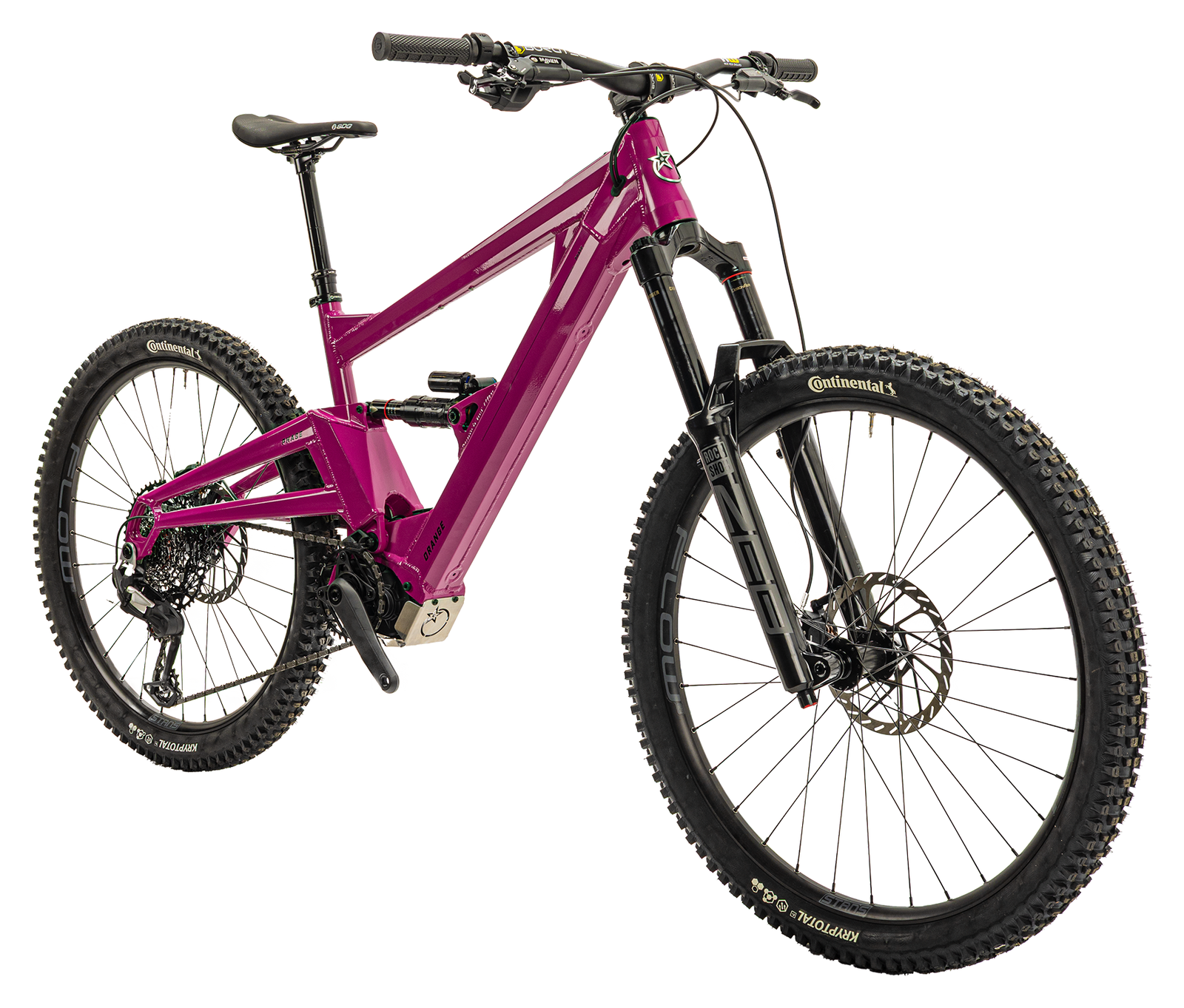

Orange Phase Avinox 2026
From £8,250
EMTB Forums verdict
The 2026 Phase is Orange's first DJI Avinox-powered eMTB, replacing the earlier Shimano EP801 Phase models. It keeps the brand's hallmark UK-built 6061-T6 aluminium monocoque frame, now paired with the Avinox M2S motor putting out a claimed 130Nm (150Nm in Boost) and an 800Wh integrated battery. The single-pivot chassis runs 160mm of travel front and rear on a mixed-wheel (29F/27.5R) layout, positioning it as a do-it-all enduro machine.
Geometry is firmly modern enduro: a 64 degree head angle, 76 degree effective seat angle and reaches of 465mm (M), 480mm (L) and 500mm (XL). Chainstays are a long 448mm across all sizes and the BB sits 343mm from the ground, pointing to a stable, planted feel rather than a flickable one.
Two builds are offered. The RS at £8,250 runs RockShox Zeb Select+ and Super Deluxe Select+ suspension, while the £8,750 Factory steps up to Fox 38 Factory Grip X2 and Float X2 Factory with a Fox Transfer Factory dropper. Both share the same SRAM Eagle 90 Transmission drivetrain, Maven Silver brakes with 200/200mm rotors, Hope Pro 5 hubs and Burgtec cockpit, so the £500 premium buys the suspension and dropper upgrade alone.

Bike geometry diagram
MLXL
Toptube635 mm635 mm665 mm
Reach464 mm477 mm500 mm
Stack642 mm649 mm659 mm
Seattube431 mm440 mm457 mm
Chainstay448 mm447 mm448 mm
Headtube Angle63°63.2°64°
Seattube Angle (eff)76°75.6°76°
BB Drop27 mm27 mm-11 mm
Wheelbase1276 mm1289 mm1303 mm
Headtube120 mm120 mm150 mm
BB Height343 mm343 mm343 mm
Front Centre828 mm842 mm855 mm
