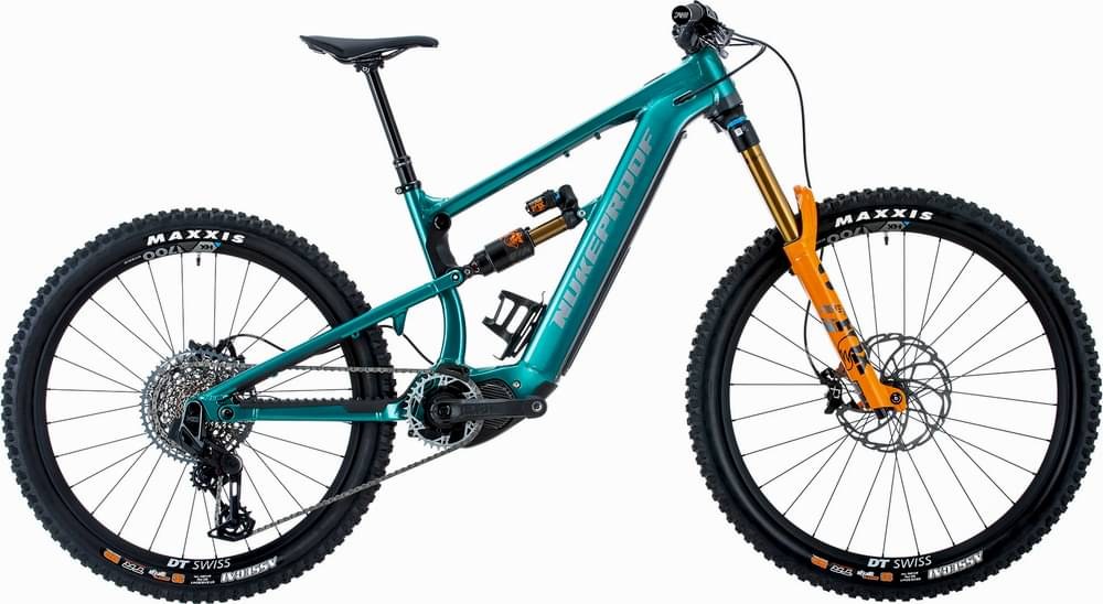

The Nukeproof Megawatt 297 is a full-power mixed-wheel enduro eMTB built on the brand's race-proven Mega platform, pairing a 170mm/170mm 4-bar Horst-link chassis in hydroformed 6061 aluminium with a Shimano STEPS EP801 motor (85Nm, 250W). The 29in front and 27.5in rear pairing buys grip and roll-over up top while the smaller rear wheel keeps the 442mm chainstays short and the handling lively in tight terrain.
The 2023 line ran four trims, all GBP-native through Chain Reaction Cycles and Wiggle: Comp at GBP5,399.99 (RockShox Domain fork, SRAM DB8 brakes, 10-speed microSHIFT Advent-X, 504Wh battery), Elite at GBP6,899.99 (Fox 38 Performance Elite, SRAM GX AXS Transmission), Factory at GBP7,899.99 (Fox Factory 38 with Kashima, Hayes Dominion A4 brakes, SRAM X0 AXS Transmission, DT Swiss H1700 wheels) and the SRAM-team homage RS at GBP7,999.99 (RockShox Zeb Ultimate, Code RSC, XX AXS, Michelin DH22). Elite, Factory and RS run the 630Wh pack; all use the adjustable mount that also accepts the 504Wh battery.
Geometry is firmly modern-enduro: a slack 64 degree head angle, size-specific seat angles (77.5 to 78 degrees effective via Nukeproof's saddle-offset principle), short head tubes and short-offset forks, with reach stretching 435mm to 515mm across five sizes (S to XXL). It is a descending-biased bike, though the short 442mm chainstays and generous travel make it less of a natural climber.

Geometry read
Size
Descending
83
Slack 64° head angle, 170mm travel and a long 1263mm wheelbase — composed in the chunk, confident when it gets steep, and stable through fast corners.
Playfulness
46
Size balance
82
Balanced front-to-rear in L (FC:RC 1.86) — weight sits evenly between the wheels.
Technical climbing
66
Climbs well — a 78° seat keeps the front planted. 600W of peak power and 85Nm of torque — a strong full-power motor.
Best suited toFast, steep, rough tracks — and riders who want maximum composure.
Rewards commitment; it should feel calmer as the speed rises.

Bike geometry diagram
SMLXLXXL
Reach435 mm455 mm475 mm495 mm515 mm
Stack640.74 mm640.74 mm645.24 mm654.23 mm663.21 mm
Seattube380 mm410 mm440 mm470 mm500 mm
Chainstay442 mm442 mm442 mm442 mm442 mm
Headtube Angle64°64°64°64°64°
Seattube Angle (eff)77.5°77.5°78°78°78°
Wheelbase1221.5 mm1241.5 mm1263.69 mm1288.07 mm1312.46 mm
Headtube115 mm115 mm120 mm130 mm140 mm
BB Height345 mm345 mm345 mm345 mm345 mm
Standover734.8 mm731.06 mm730.01 mm732.88 mm732.69 mm
Front Centre779.5 mm*799.5 mm*821.7 mm*846.1 mm*870.5 mm*
FC:RC1.761.811.861.911.97
